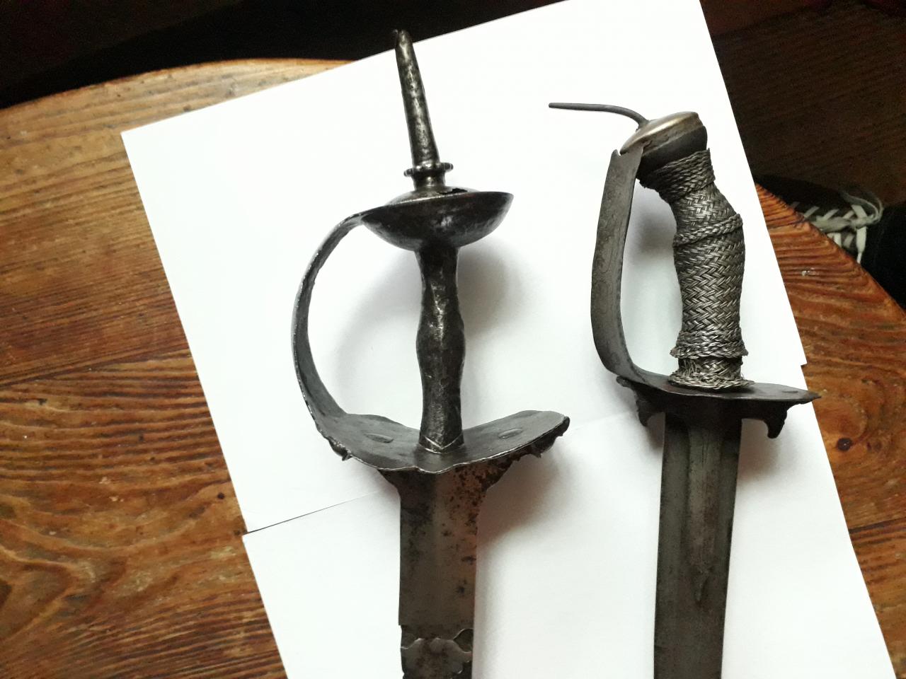

I'd be interested in any additional information, thoughts, or your own examples of the type. Does anyone know about how these connect to the Indian basket hilted swords (see picture for comparison; the ethnography museum here in Leiden has gotten them mixed up), or the type of blade featured on this Sudanese saber?

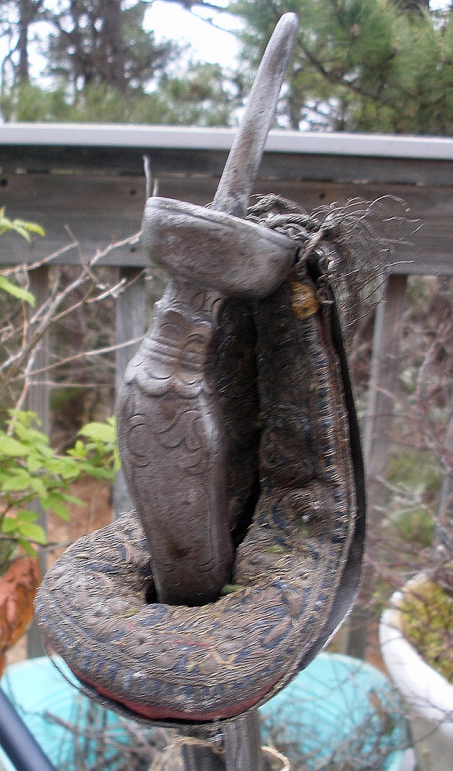

I have one of these; it's a bit different; the fullering is simpler than your example Werecow. My example has a very nice pillow around the base of the hilt to protect the wielder's hand, it is red, darkened with age and the surface is quite beautiful richly embroidered with flowers etc. I don't think I have any pictures in my files and I can't take any until I get a replacement camera; I dropped mine on our deck while taking pictures of the Buddha I listed in Ethnographic Miscellania.

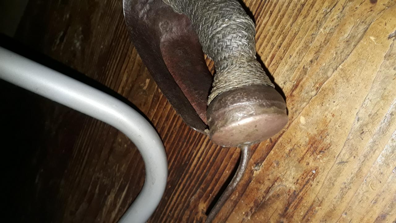

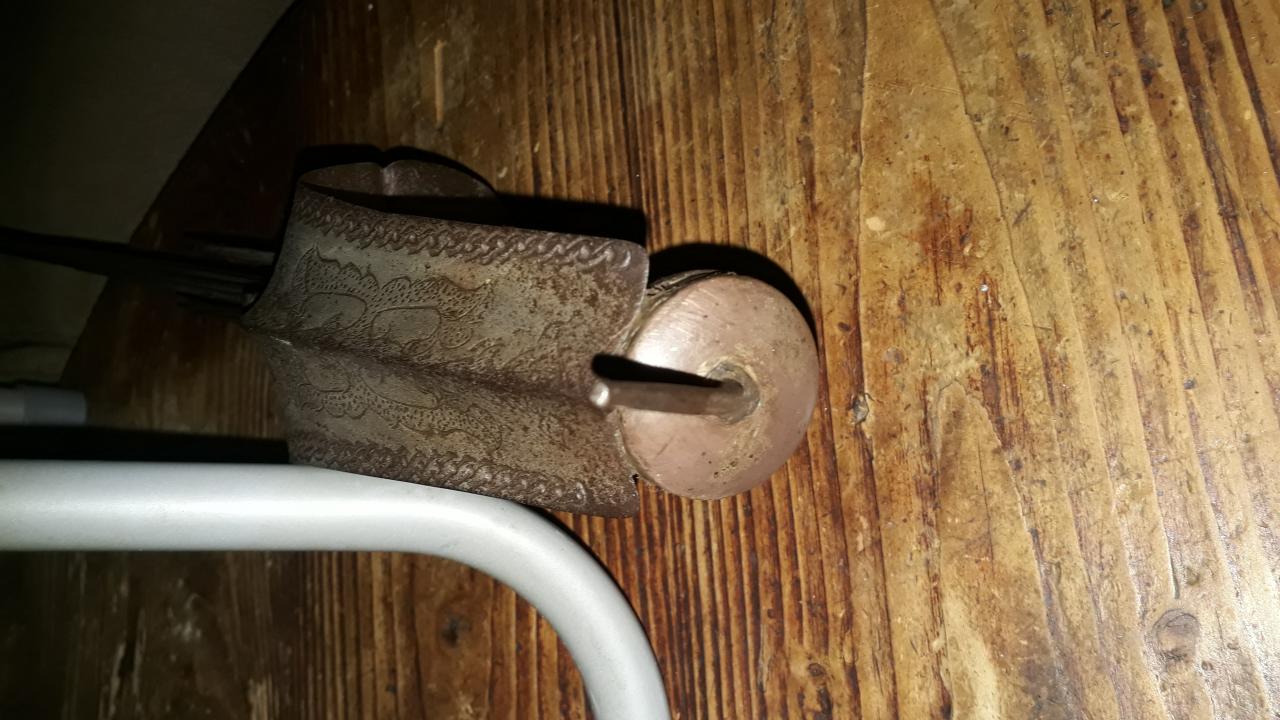

Do you have a picture of the pommel cap ?

Originally Posted by asomotif View Post
Nice peudeung with a laminanted blade.
Sure, see attached. It is a bit too simple and smooth compared to the rest of the sword, hence my suspicion that it's not original, although it's clearly been on there for a while.

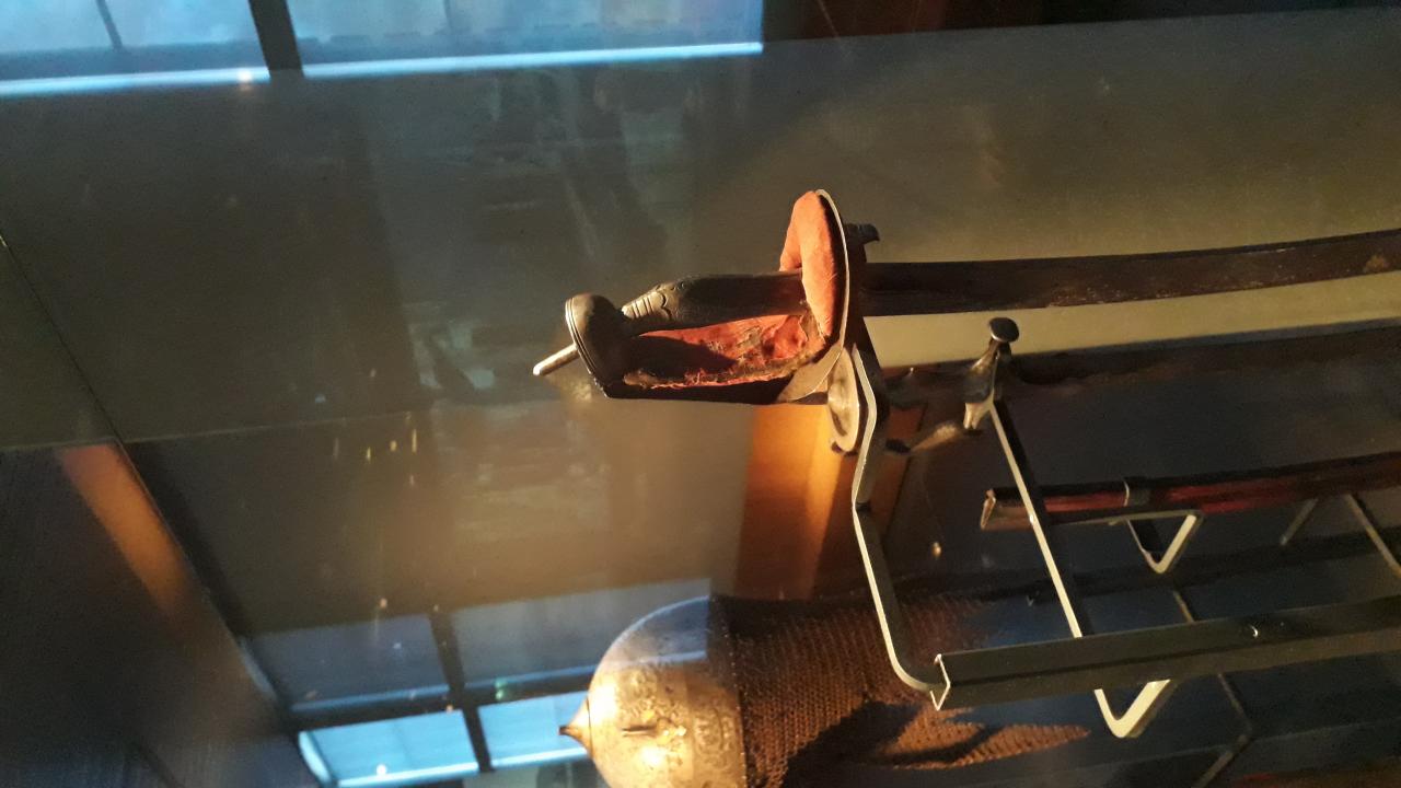

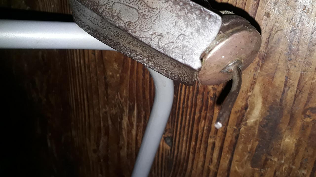

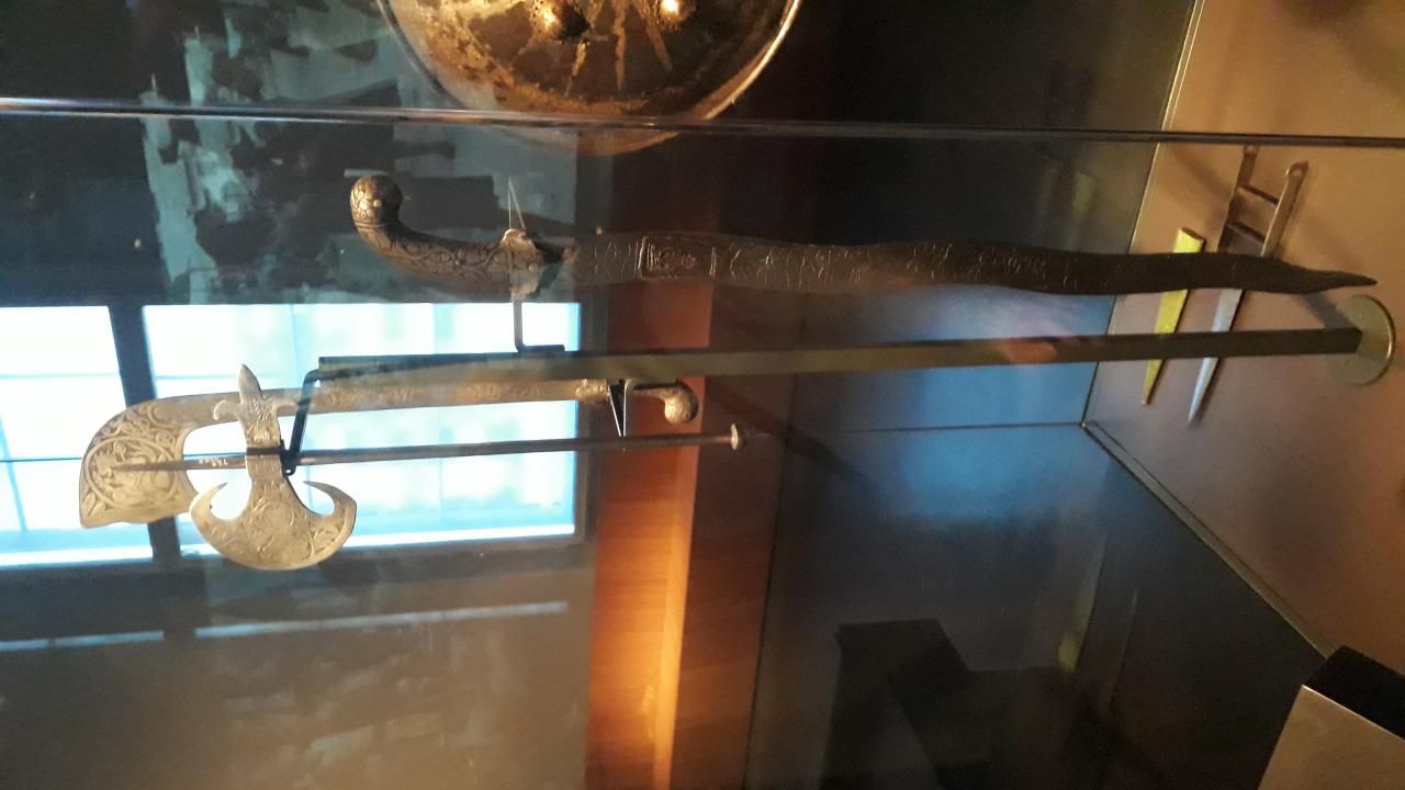

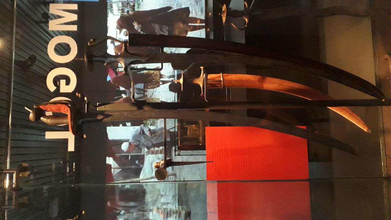

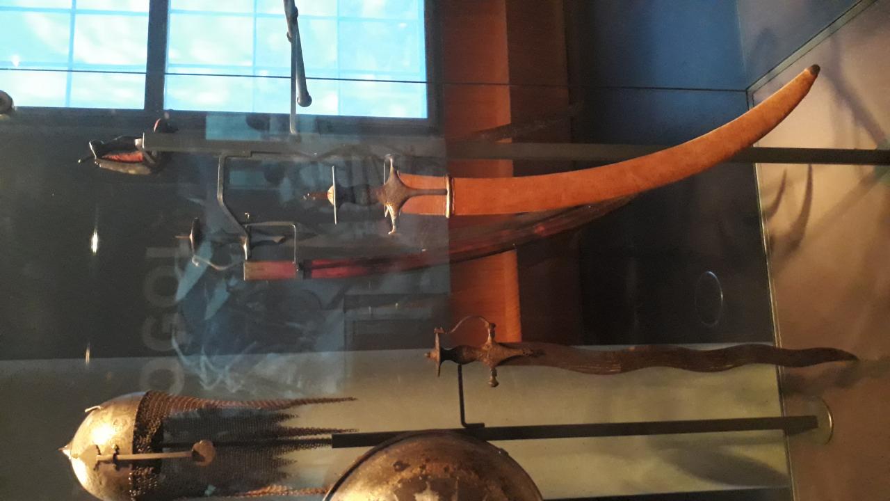

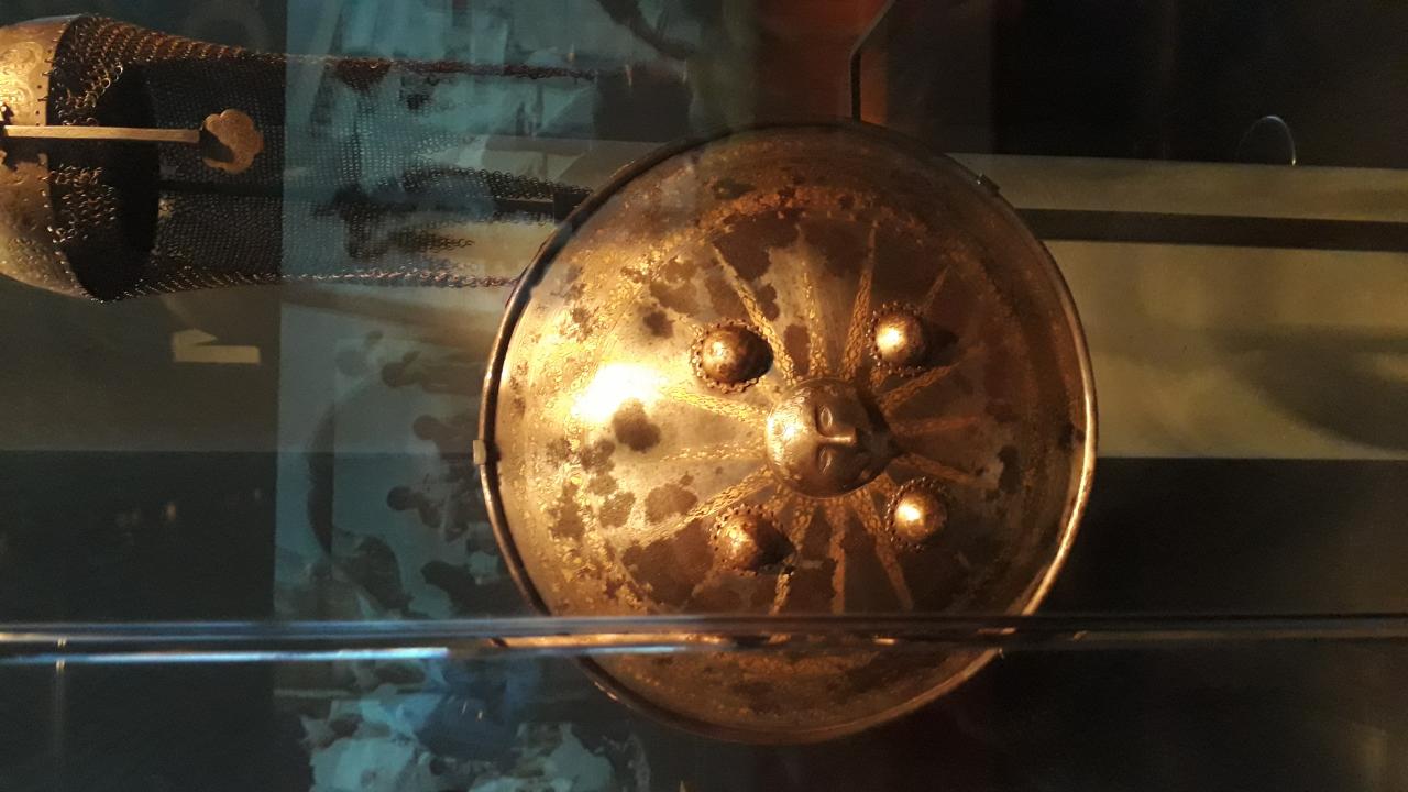

Here are some pictures from the (mislabeled) one in the Leiden ethnography museum (along with some other arms from India). Sorry about the dark pictures; the room is quite dark and they don't like it when you use the flash.

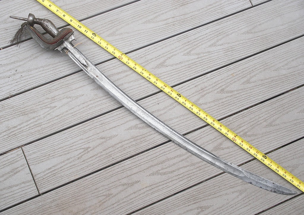

Red face Rick's Example
here are a couple of pictures from the replacement camera. It is defective and I will probably send it back; but it does take pictures after a fashion.
Sorry for the poor quality.

Very nice, Rick, thanks for adding it! Still better quality than my museum pictures.

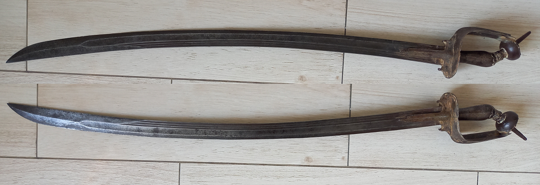

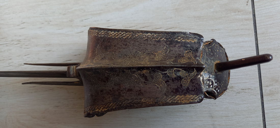

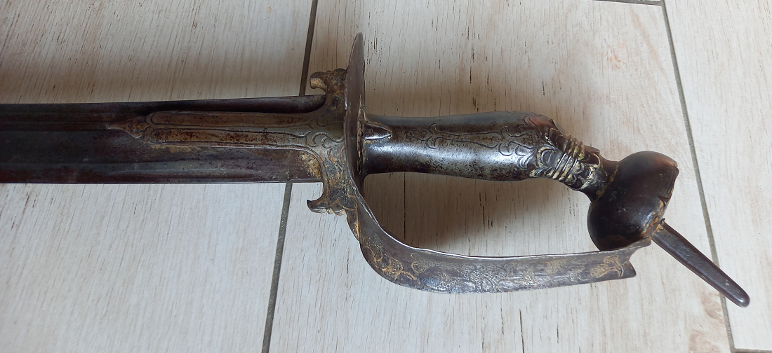

Hello Werecow,

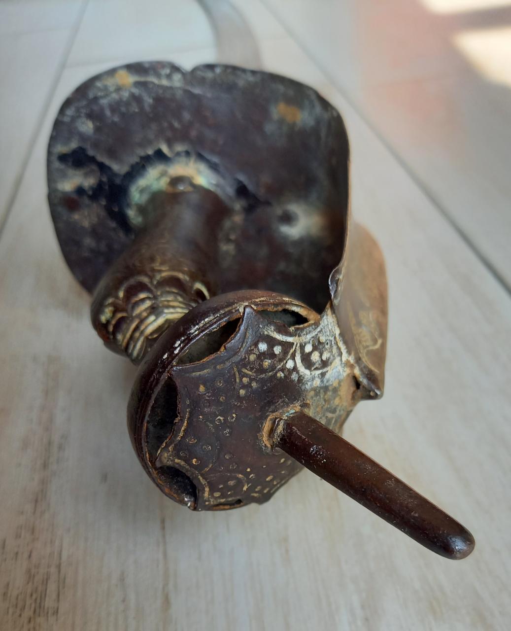

I have a a peudeung with a very similar blade :

Very nice, I like those crisp lines! Are there any signs of laminations or pattern welding? And is that gold on the hilt or is that just a trick of the light?
Old 8th May 2023, 08:16 PM   #12
Athanase
Athanase's Avatar
Join Date: Mar 2016
Location: Paris (France)
Posts: 432
Yes there are some visible laminations under the oxidation.
On the hilt isn't gold but residues of old product to be cleaned such as Mirror.

You can remove such residues with a small brass brush, at least I have good experiences with it!
