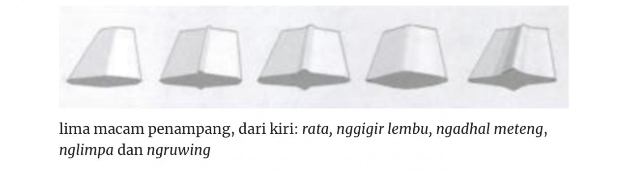

I also found a brief definition and a diagram in an online Keris Lexicon. This seems to imply that JustYS had the wrong impression of the meaning of this term and that it refers to the cross-section of the blade, not the shape of the length of the blade. This is another page that also implies the term is in reference to cross-section of the blade.

Anyway, we've established that ngadal meteng refers to a particular blade cross-sectional shape, one that is similar to closed curly brackets {}. It was not that difficult for me to find this on Google.

Thank you David for the link and also clarifying that it refers to cross section.
I did not know that there are so many different cross sections.
Regarding the intended meaning and significance behind it, I’m not sure jagabuwana, but if you click the link from David you’ll see that the terms is used in Serat Centhini although using different words: ngadhal busung.

Briefly, the EK entry just says that if the face of a blade of a keris or tombak is domed & looks like the back of a pregnant lizard (a small lizard, grass lizard, "kadal") then it is referred to as "ngadal meteng".
