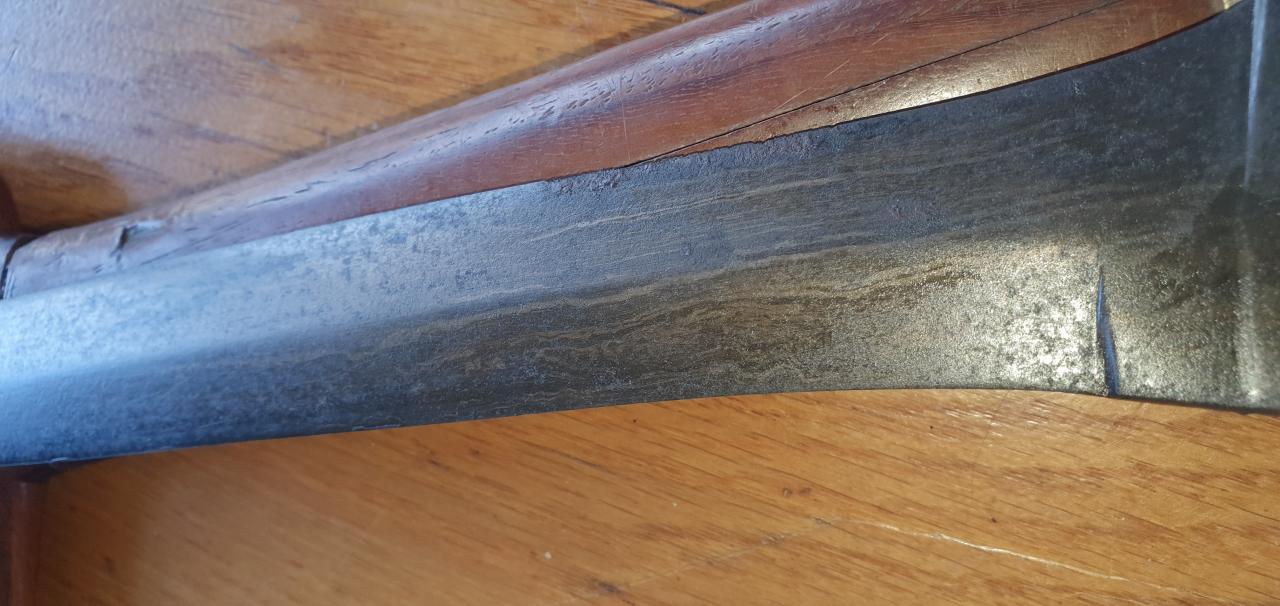

The last blade that you say may be a Banten blade may have started its life as a tombak , the Ganja is certainly a later and not too good an addition

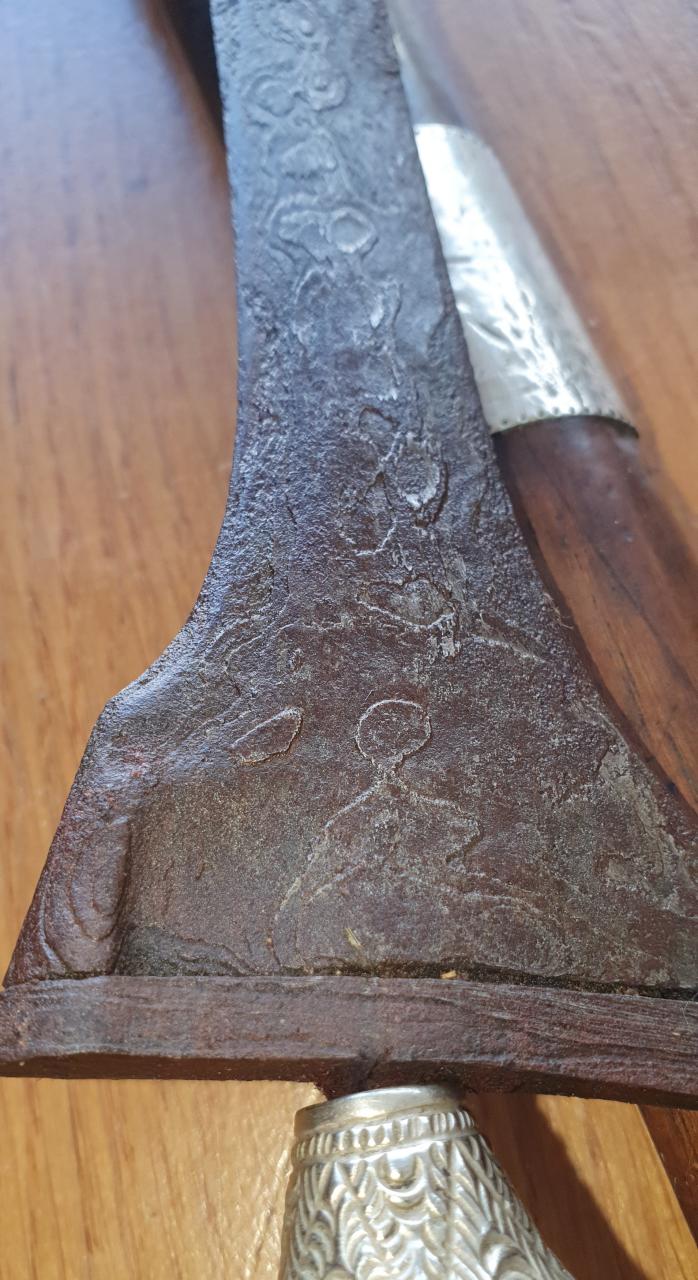

The 3rd keris is the family pusaka and is old. He couldn't tell me how old, but he was talking about several generations.

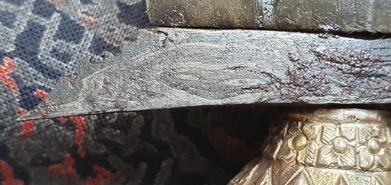

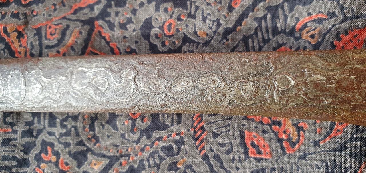

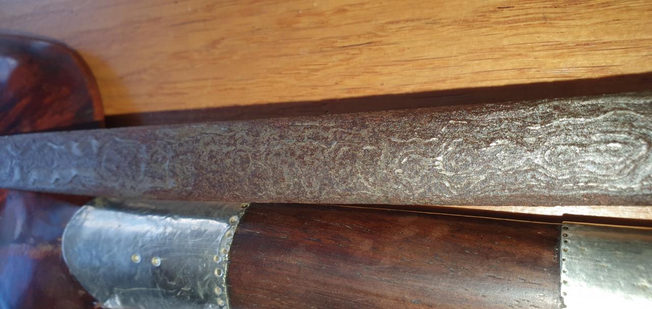

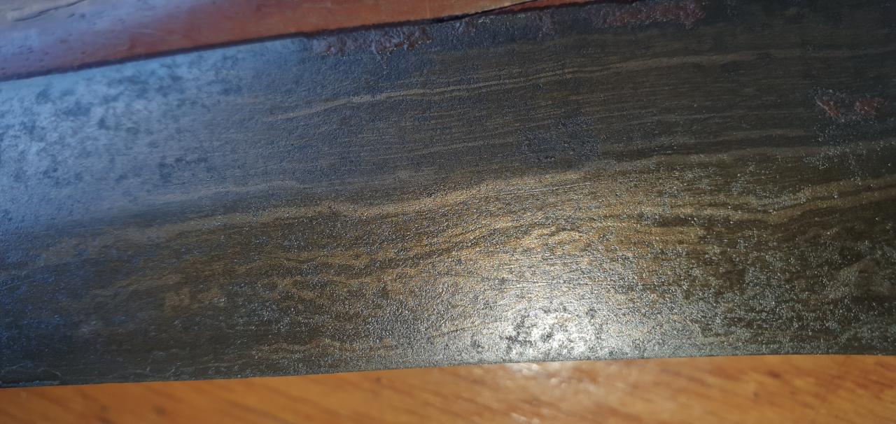

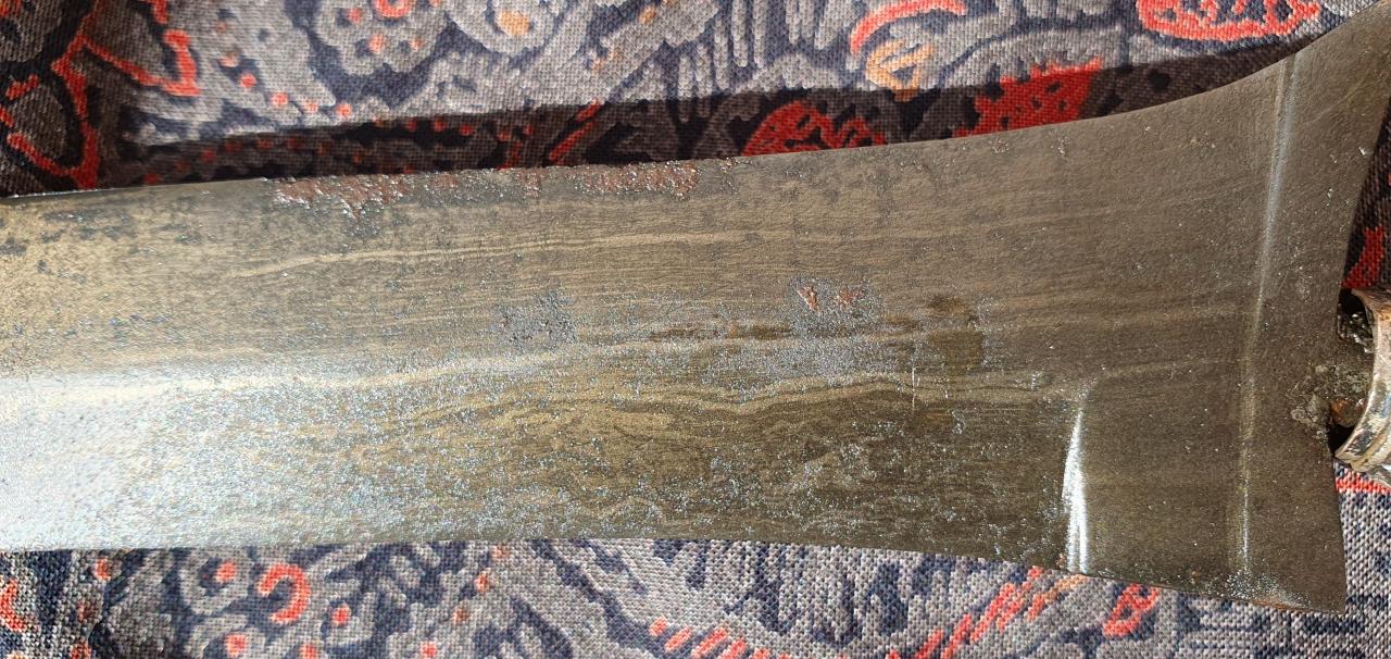

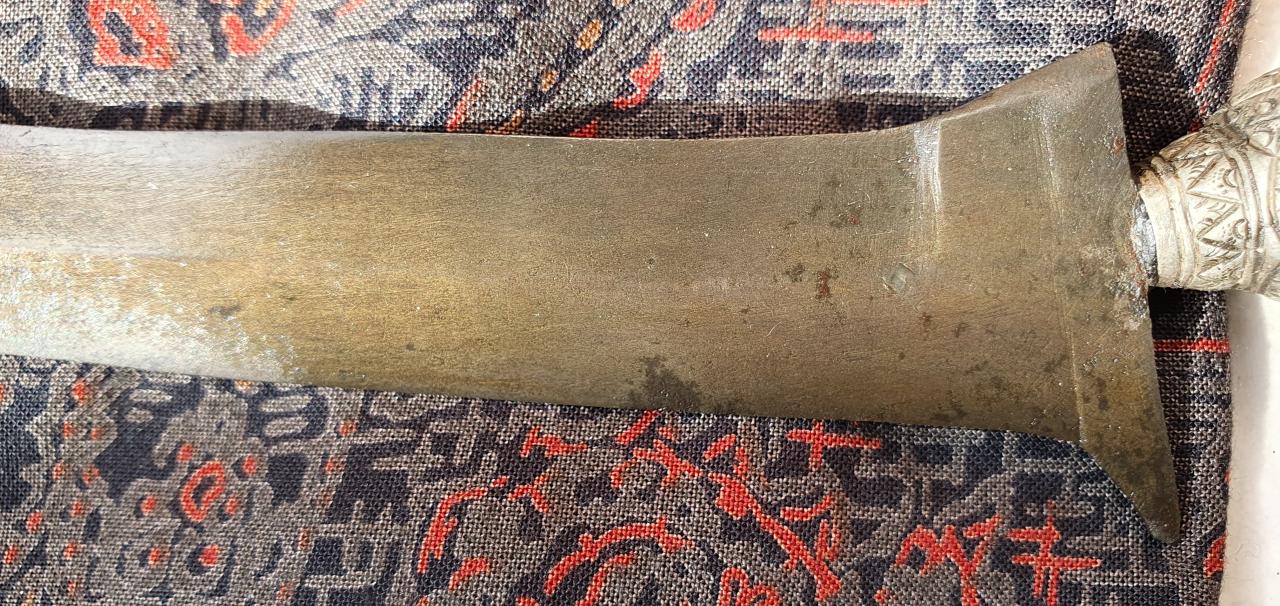

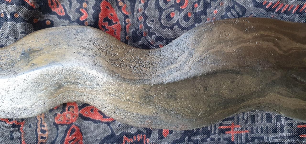

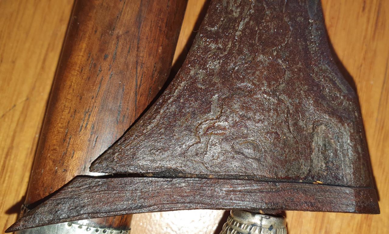

The first picture is from the Patrem Sepukal blade, the second also from the Sepukal blade but the large keris, but i see that it has some kind of pamor patern in the blade. The 3rd pictrue is from their family pusaka. And the last picture is from the keris i do not realy understand what it is and an extra picture of the gonjo. It is a realy big and heavy blade.

As mentioned, I feel all 3 examples coming from a similar environment, possibly made by village bladesmiths. It is interesting to note the strong differences in the laminations (pamor). The separate gonjo of the one on the right does seem to be made from very different stock than the blade, indeed. Unless there are any clear signs of later replacement, it still might be original; at least I'm having a hard time why anyone would fiddle around with such a blade, especially since it apparently left Indonesia only a few decades after its manufacture. (This type of pamor is not what we see on well-preserved early keris, even if repolished.)
I still like the keris second from right; it's an old blade in reasonable condition that should restore well. I'd posit it originally came from Madura as a trade blade.
