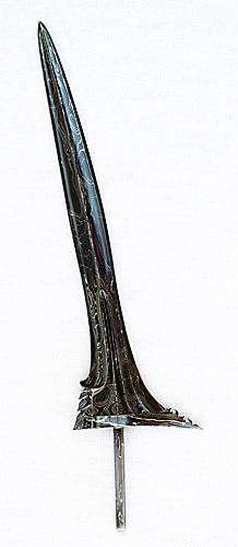

This keris is one I made, it took me two full days to get this stain on it, it was done in Sydney, in Summer, partially in shade, partially in full sun.
