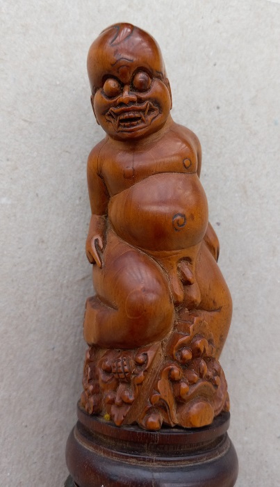

And in the meantime, this is the hulu(?) from one of my other keris. Apparently it might represent "Rare Kumara, a tutelary deity for
children on Bali"?
Orang Lama is offline   Reply With Quote
