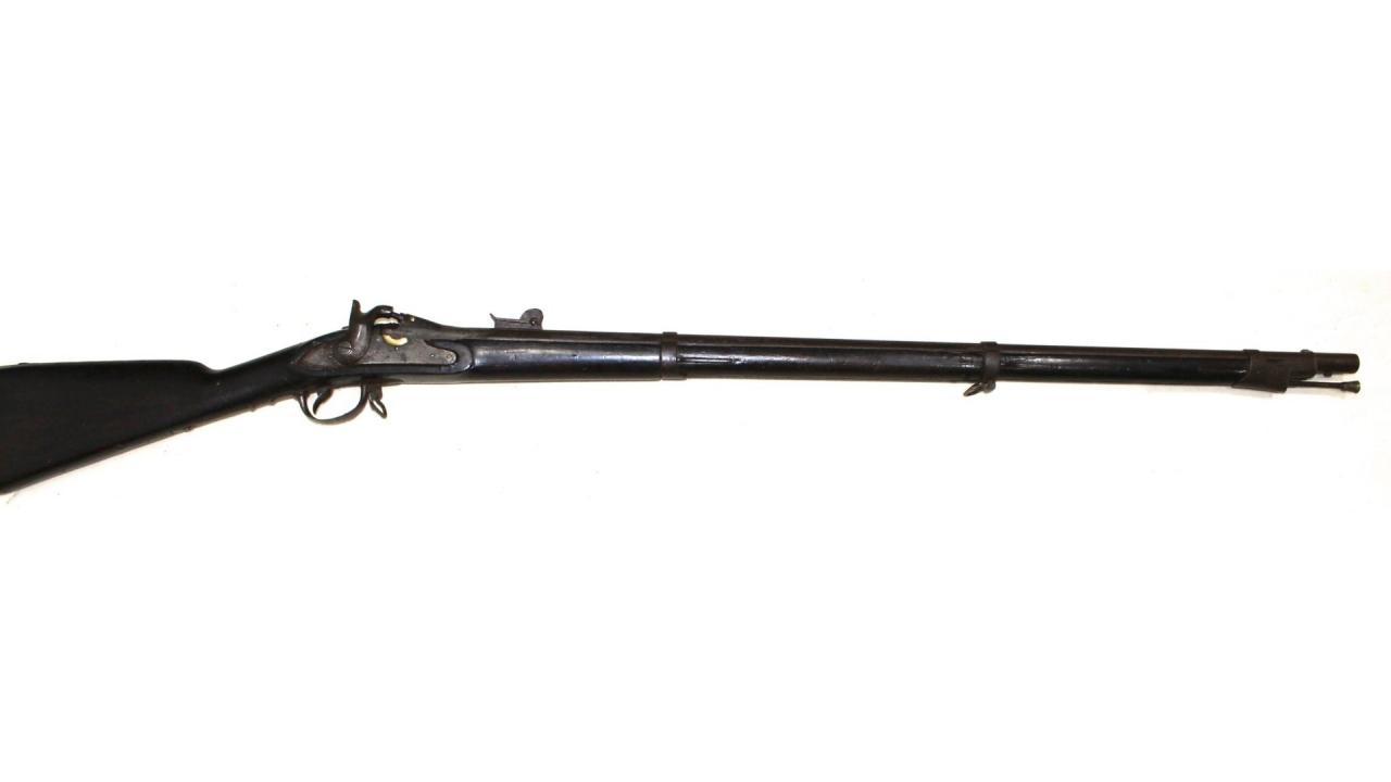

enclosed a picture of a rifle by Stevens of Maastricht with regards to the US Civil War Era

As a flintlock, I would suspect this musket would more likely be associated with the American Revolutionary War than the Civil War.

This gun has certainly absolutely nothing to do with the American Civil War. It is - or better - it was a Netherlands infantry gun M 1798, normally manufactured at the Kulembourg factory under David Martitz but also at some Dutch provincial gunmakers. The cock is a false replacement as is the front ring made of iron.

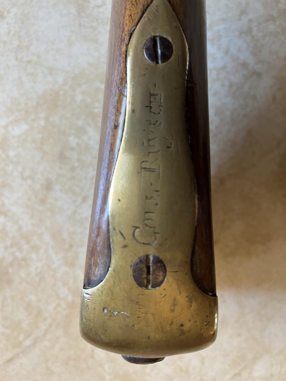

I misspoke about the war, it was the American Revolution. The gun came from upstate NY near where many battles were fought. The gun has the name Coll
Ruysch inscribed on the brass. How could he be identified. It’s a dutch name and was probably his originally. Where could I find Dutch army records form the 1700’s. Thanks

The photo of the name on the musket attached

Years ago, I found an old powder horn at a gun show, simply (and believably) inscribed "Gerrit Konstapel Hurley 1776." There is a great street of old Dutch stone houses in that small Hudson Valley village and I visited on the annual open house day (decades ago). Visiting the cemetery, I found his wife's marker (she was inscribed as being his wife with his name now Anglicized) and beside it was a plain stone that I took as his. Just now I entered his name into Google and it led to old church records of his marriage and of his serving as a witness to baptisms a few decades before the Revolutionary War.
So, I would start with a general internet search of his name. Likely your local historical society or library would have reference books of persons who served in the American Revolution and War of 1812 from New York. If you know where your family was at the time this could help narrow your search.

I am discussing the musket with Matthieu Willemsen. He believes the musket belonged to Colonel Hendrix Ruysch who had a regiment in the Dutch army between 1748 and 1765. I sent more photos

Matthieu Willemsen has confirmed that the musket would have been made between 1755 and 1765. He said Colonel Ruysch had a regiment in the Dutch army from 1748 to 1765. Ruysch would have purchased the musket from the Corbau family of gunsmiths. The letter E on the thumb plate would represent the 5th company in the regiment. He was nobility. He feels the saber was added and the the cock might be from a British Brown Bess. He will contact me will anything else that turns up. A wonderful source of knowledge
