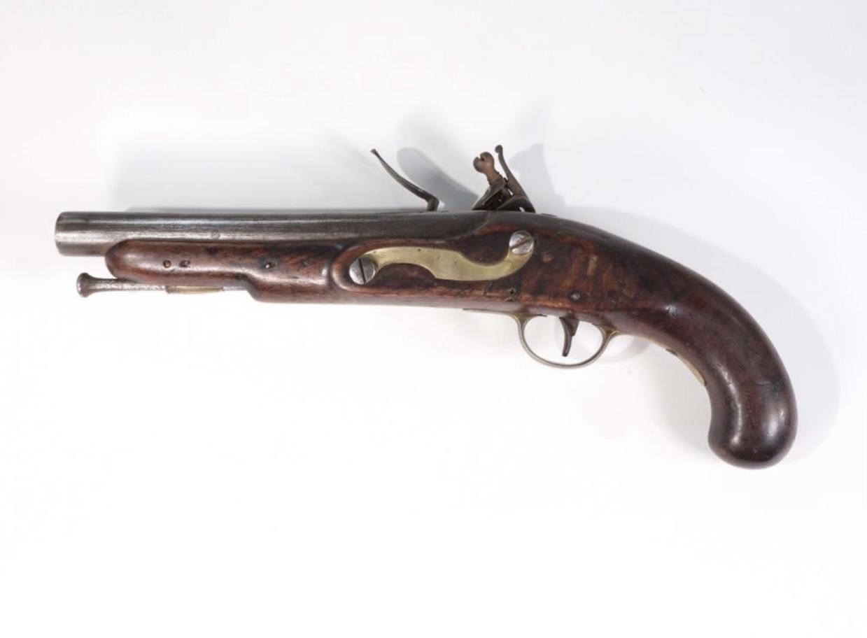

Good evening gents, I would like your opinion on these two items as I know next to nothing about 19th century firearms. The musket specially is hard to pin down as it has some British qualities but lots of American as well. Thank you.

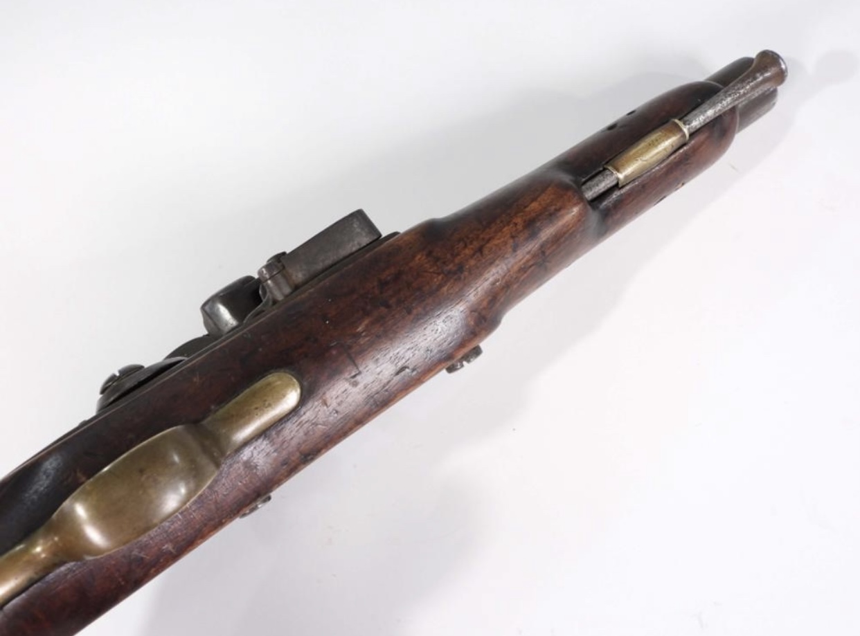

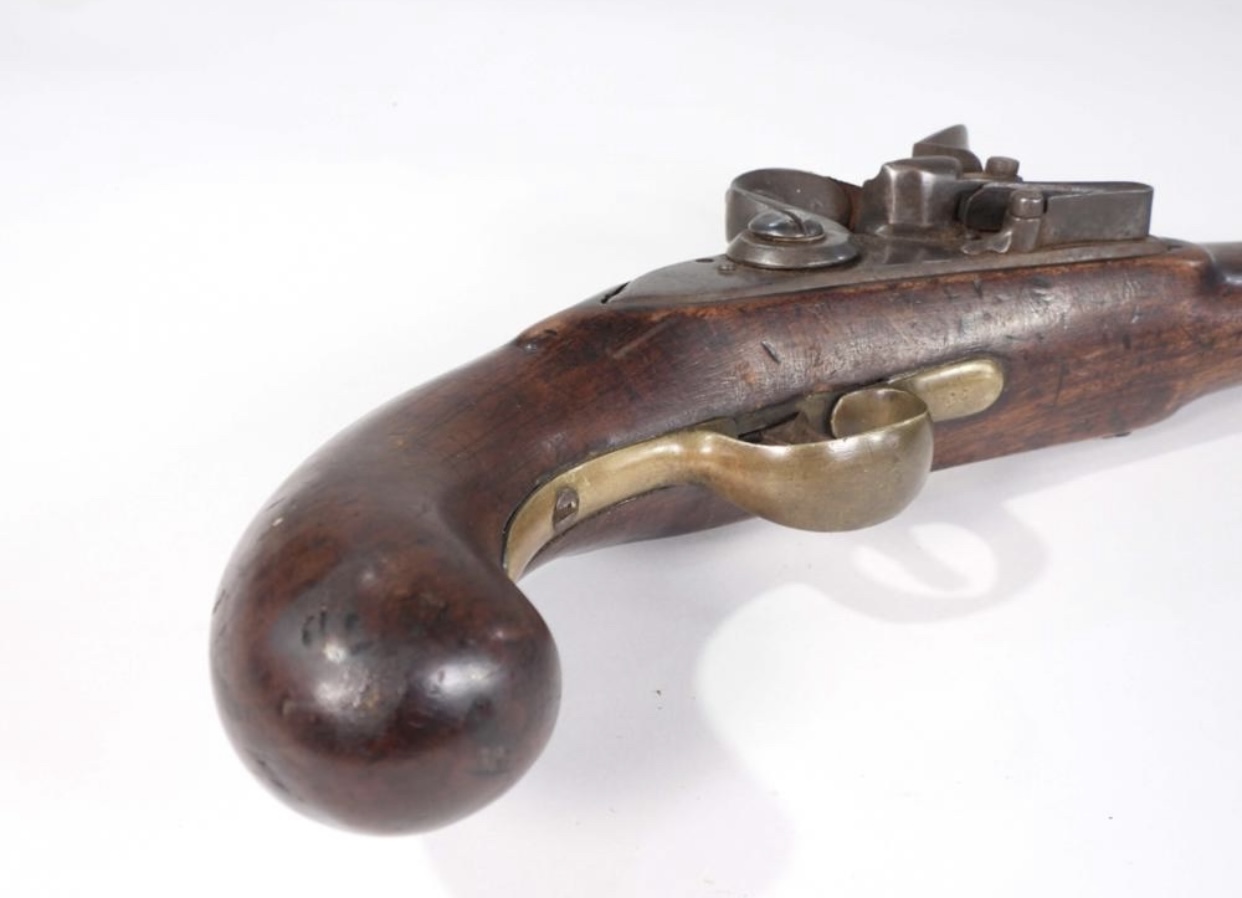

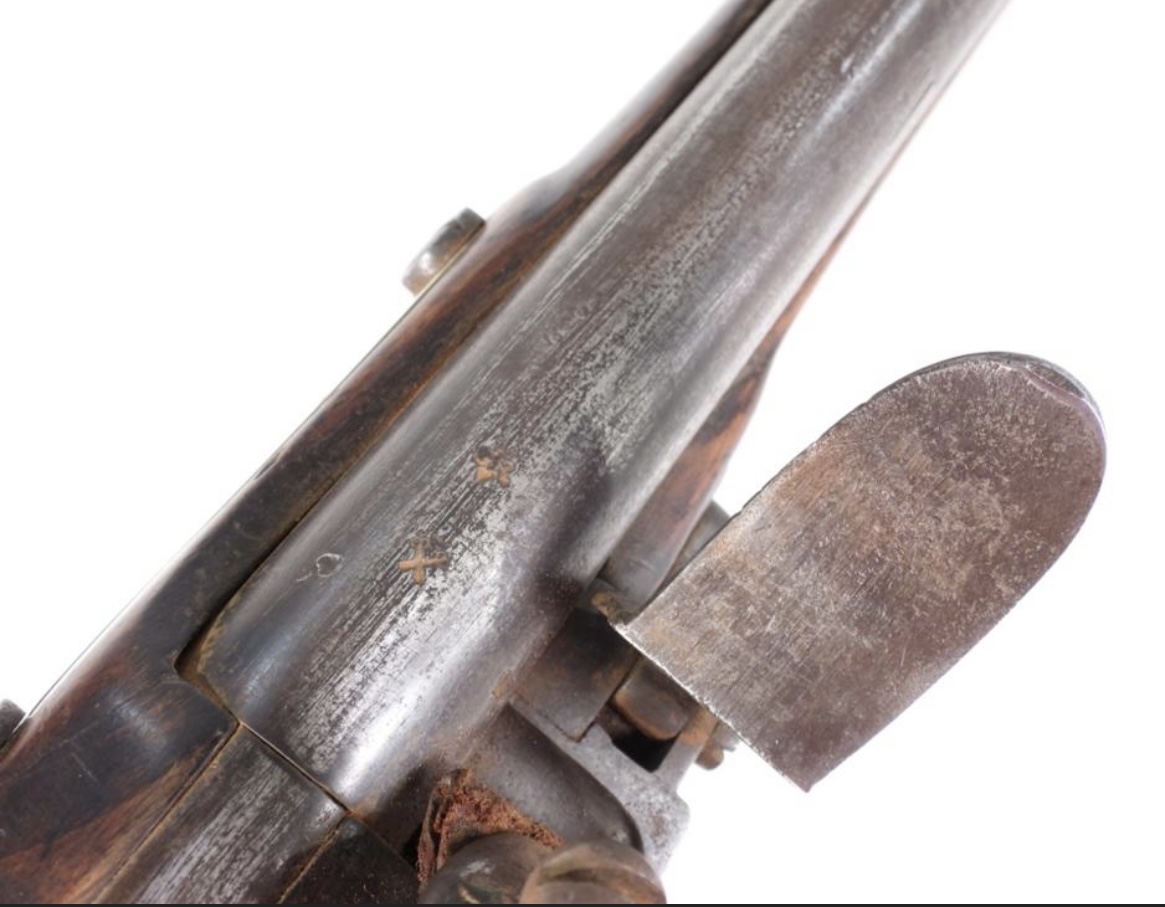

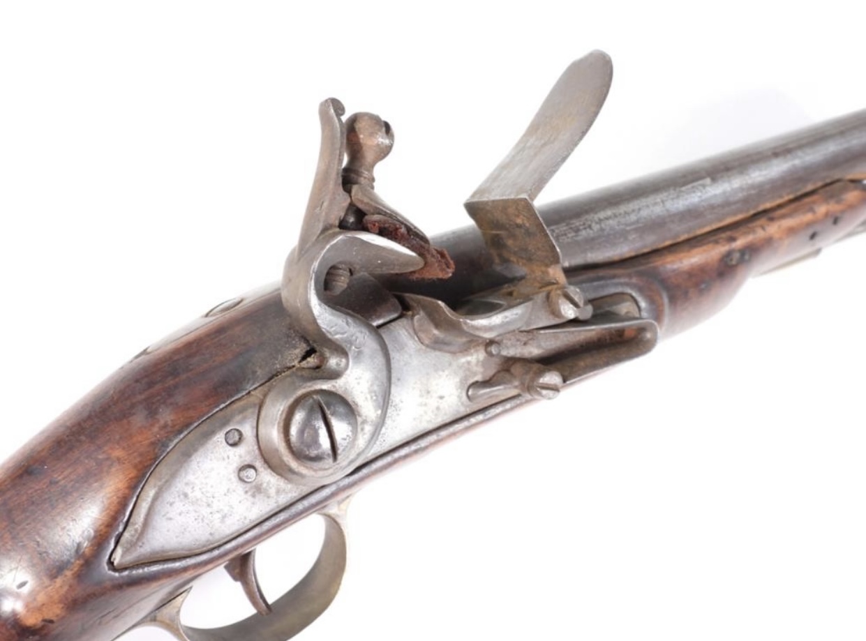

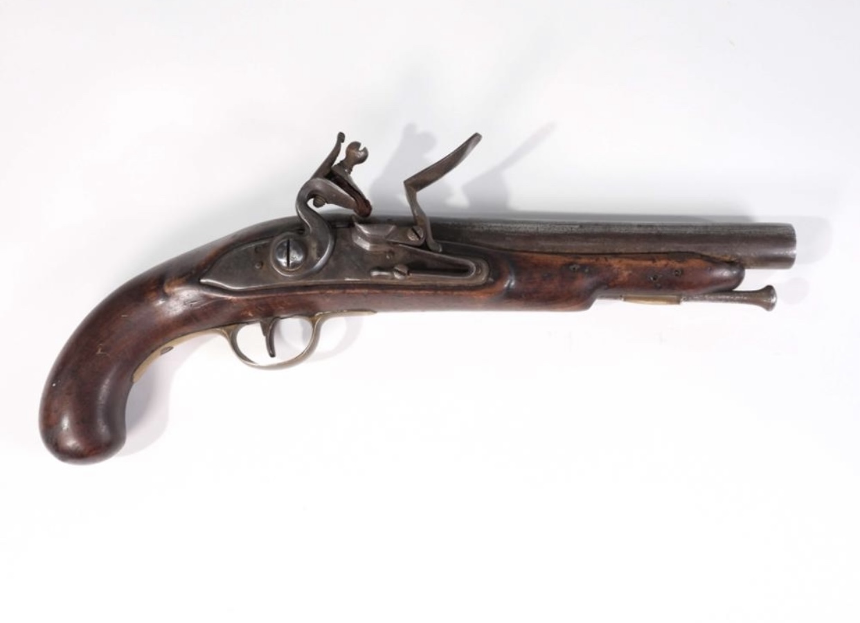

The pistol

As for the pistol, although it has a barrel with what appear to be marks of the test punch (two crowned scepters) of the tower and a punch with the reigning monarch (GR) and the wide arrow indicating ownership of the Crown, the lock is not of a regulatory model. Notice the priming pan, faceted like the civilian models and fastened by screws instead of being welded or forged, the counter-plate with a military design, although it lacks a stock pommel
For me, it was about two weapons sold in times of scarcity
