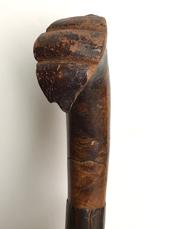

A sword that has an uncommon blade form. I don’t know what it’s called. It resembles a Barung in a few ways (handle, pommel, scabbard). The ferrule is horn. The tip could have broken off and re-shaped. If I were to hypothesize on its age…mid 19th to early 20th century. Blade length ~13 inches.
Thoughts?

Albert, could you also post a pic of the "face" of the pommel, please?

Kai and Wayne, it certainly is a rough cut along the scabbards end. There isn’t much difference in the patina. Photo of the pommels face added.
