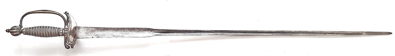

I have a William Kinman silver, boat-shell hilted example with a 33" (84cm) blade (which was unusually long), and while the hilt is in perfect condition, the blade looks a good 100 years older. Kinman was marking from 1765 to 1799, so again, as in Fernando's example, I suspect it was a re-hilt (see image).

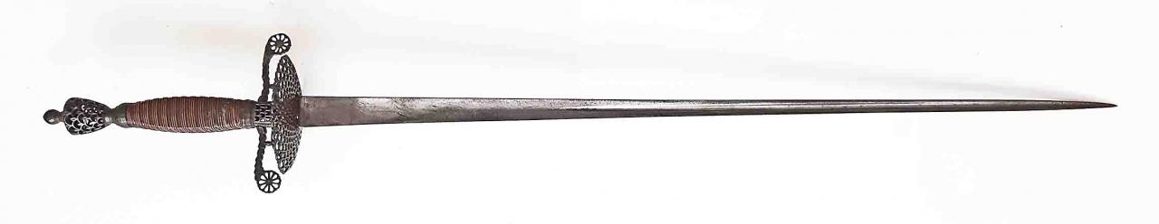

There are a lot of munitions grade smallswords that also feature this groove as it was far quicker and cheaper to produce; although this second image is of a special order smallsword made for a naval officer during George 3rd's reign by Thomas Gill of Birmingham that was obviously an expensive and unique commission; again, it features a Boulton hilt.

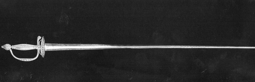

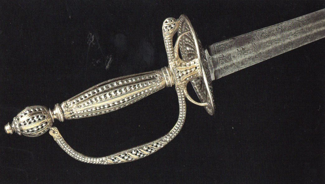

And once Keith notes that there aren't many of these swords out there, i will here upload a high end example, that comes in AS ARMAS E OS BARÕES, by Eduardo Nobre. The silver hilt has gilded decorations, and zoomorphic figures.

This is a magnificent sword Fernando: truly superb. Is it part of your collection?
It is not possible to see in detail, is the blade a hollow trefoil blade?
It looks like a style of colichemarde blade (accurate name unknown to me) that I have wanted to acquire for some time and features in the Diderot page of blade shapes number 5g. Is it called a flattened diamond shape?
There are even less swords of this style than the regular colichemarde.
Last edited by urbanspaceman; 11th June 2021 at 01:38 PM. Reason: extra sentence added.
Old 11th June 2021, 04:28 PM   #8
No Keith, this is not mine, although i have in time acquired a few pieces from this collection; in fact this is a book/catalogue that the author (Eduardo Nobre) published to promote its sales.
There is no detailed description on the blade, except that it is a Colichemarde . ... and the Konigsmark story.
The images i posted are as good as those in the book. To my eyes there is no actual hollow ground profile; however the three parts of the forte look slightly concave. On the other hand, as both images show the same side of it, i can't even say if the other side is flat... yet it could (should) be.
Blade length 780 mm. thickness 30 mm. Total length 940 mm.
Sorry i can't be more precise .
On the sword, the guard, the grip, the knuckle guard and the pommel are all pierced and chiselled. There is an animal head in the knuckle guard where it meets the pommel, with eyes and plumage.

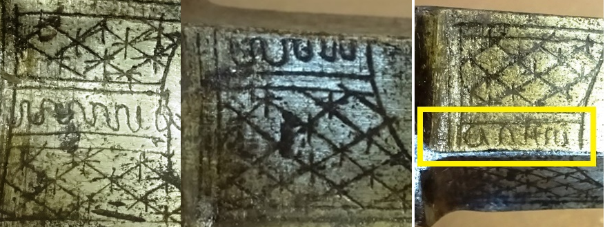

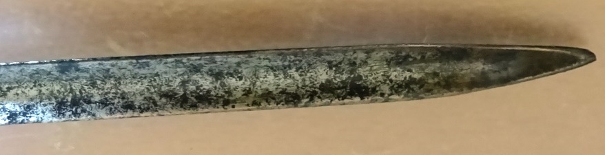

Guys, adding a picture of the no longer broken point and the comparison of all three face ricassos, where we can (hopefully) see that one is not an arabesc but the blade smith signature.

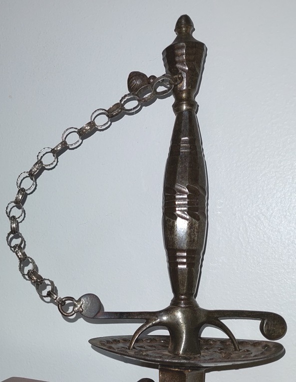

Some (silver) arrangement ... for the missing chain
Old 25th August 2021, 12:07 AM   #11
Posts: 10,867
This looks like an English chiseled steel type c. 1790-1800 with 'Adams' pommel, most fashionable.
