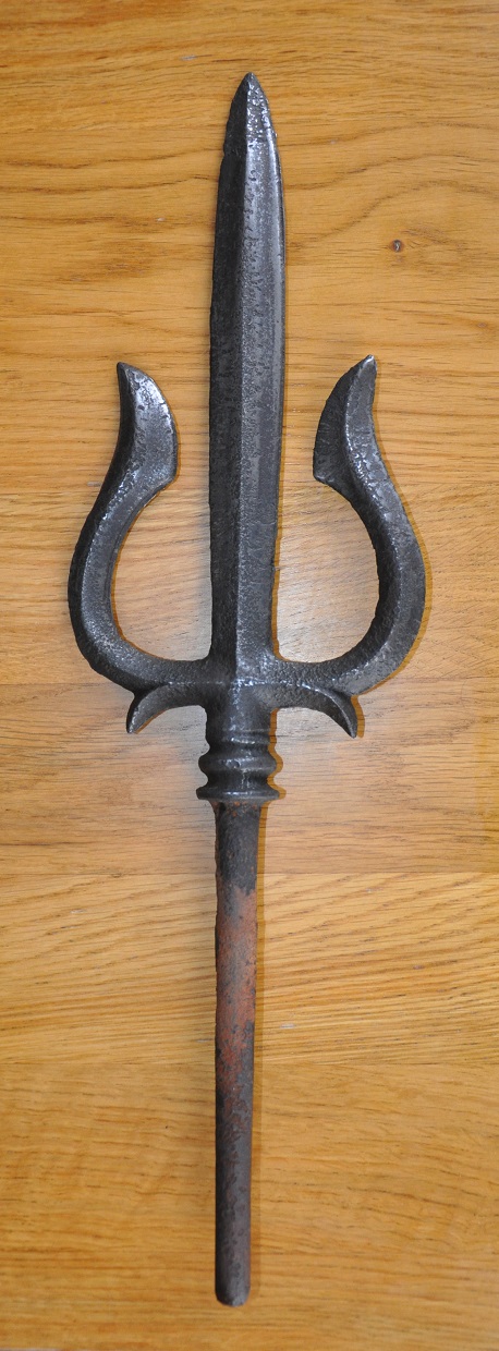

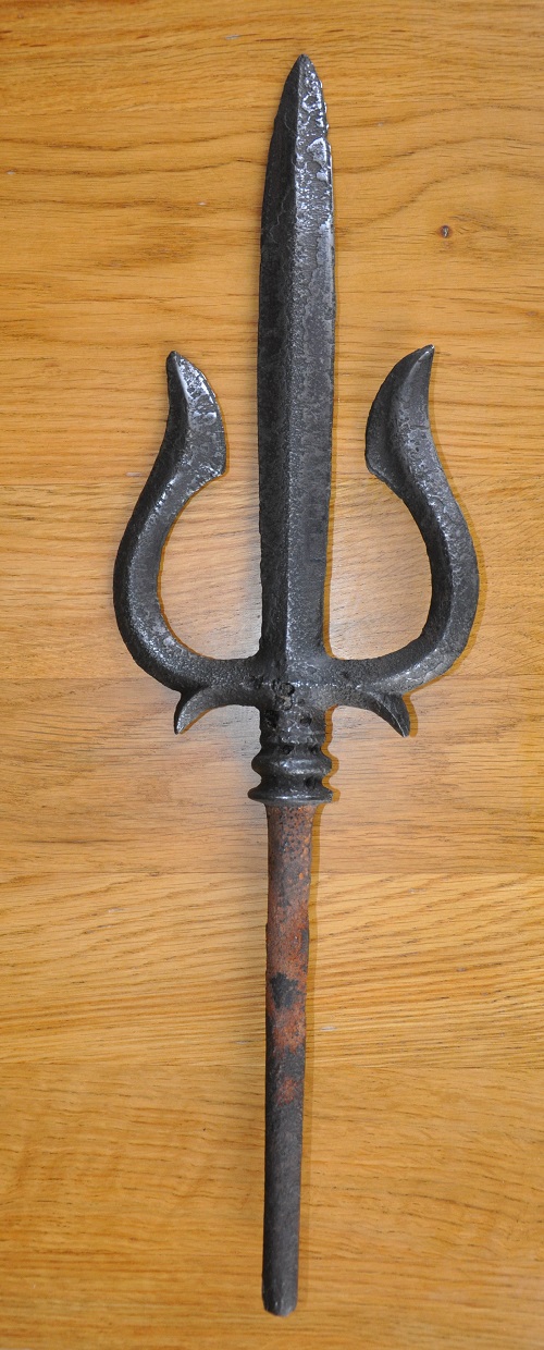

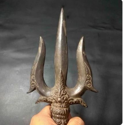

Hi Guys,
Many of you are specialists of Java and Indonesia.
Any ideas about this trisula?
Thanks
Kubur

The 'wormholes' at the Metuk on one side strike me as a bit strange.
Old 28th February 2021, 06:58 PM   #3
Posts: 7,401
It looks cast rather than forged. Could this be a decorative modern make?
Old 1st March 2021, 01:18 AM   #4
Posts: 6,421
That thought crossed my mind too Jose. I just couldn't see the point of doing it; and from the looks of the tang it seems to have been mounted at some time in its past.
My guess would be that if it was a cast piece it was not made yesterday.
The surface also looks kind of odd for something made in a forge.

Hi Both,
I agree it has been cast, the holes and some ridges in the inner curves let me think that you are right. This is a nice piece and doesn't look recent at all.

Is your trisula cast from bronze Kubur?

it looks like the approx. 18 cm long trisula's made from tombak ( alloy of copper and zinc) as many of the trisula's from Java and Sumatra, popular with the Betawi warriors and the in Srivijaya (Indonesian: Sriwijaya) empire.
