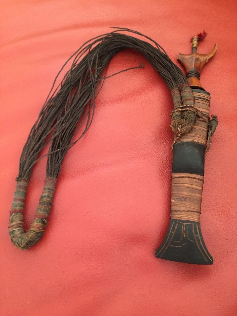

Hello GP,
For me, it's normal to clean them ''gently ' when the weapons were really bad preserved: lot of red rust of all black rust too,
I think we have to !
Not with a mechanic sander and 80 grain as I already saw Sure it's a disaster!

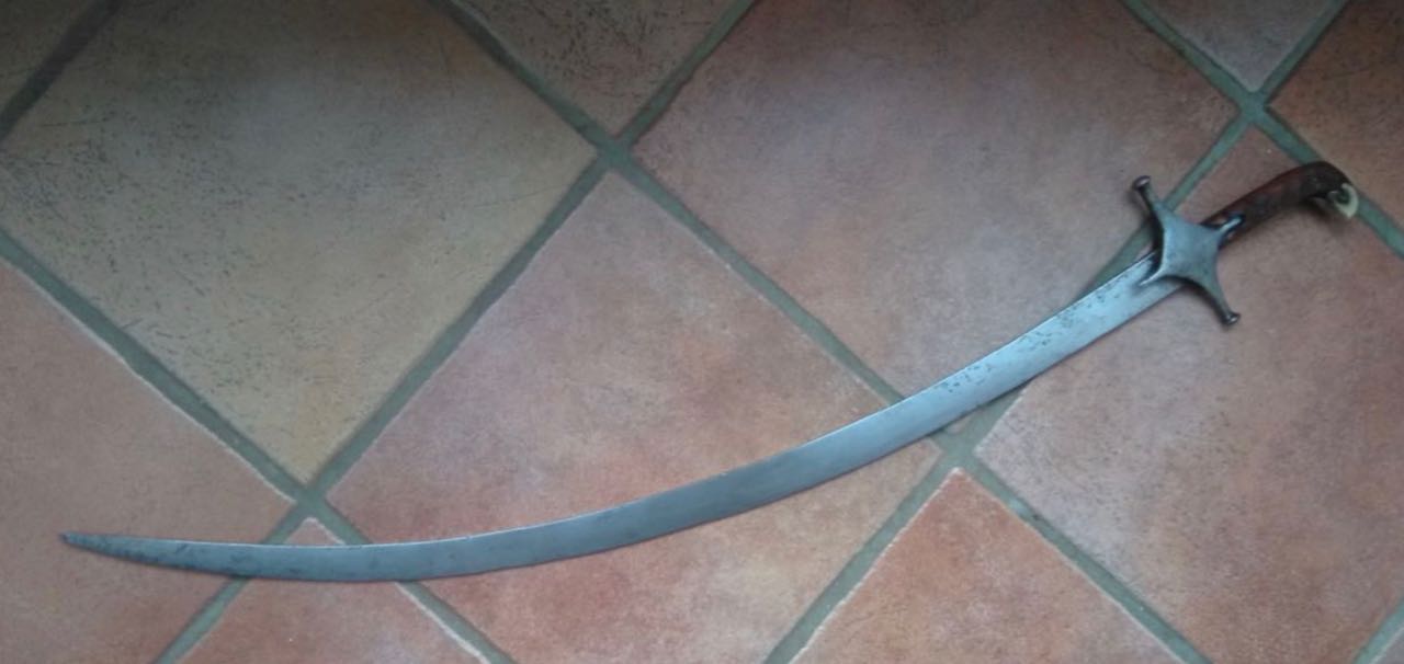

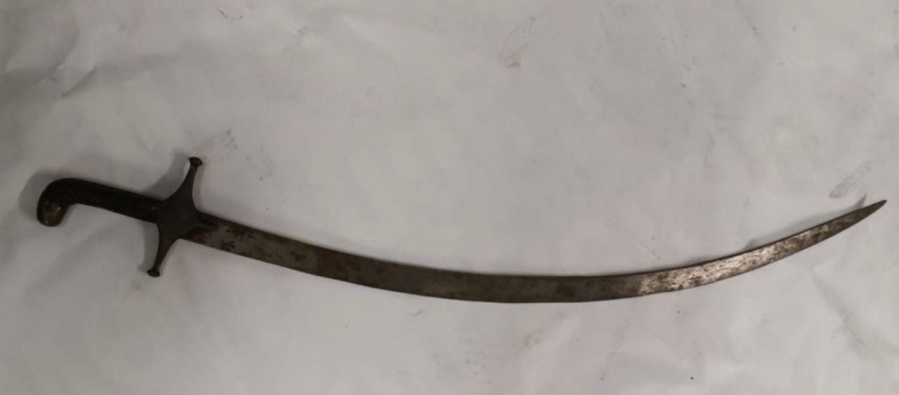

Nothing better than an example:
Not talking about money but this all rusty shamshir I have per example,
bought less than 80 Euros couldn't stay like that...
now I can sell it for a fair price but I prefer to collect...
Experience, passion and good skills helps too,
I worked in antique furnitures and collect blades since more than 20 years
it helps ! , half of my garage full of stuff like ferric acid , choji oil, sand stones.
It's like a second job !
Sure if its too damaged or costs an arm and a leg,
better consult a specialist ( difficult to find for japanese swords per example and expensive as David said )
or leave it like that !

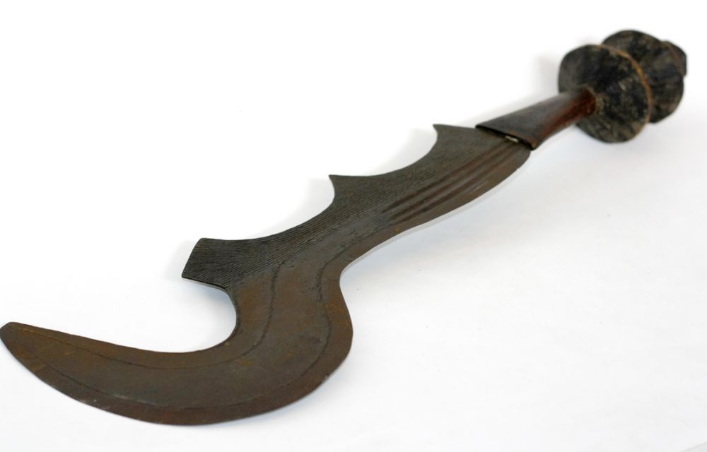

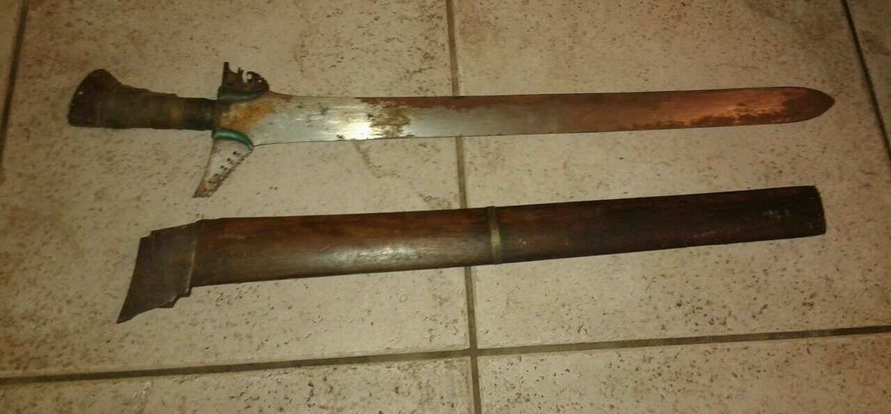

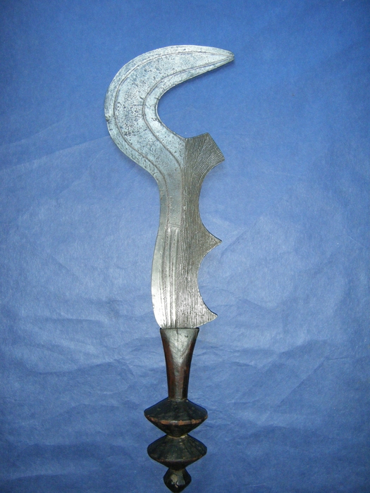

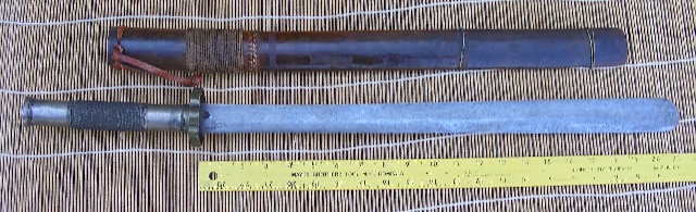

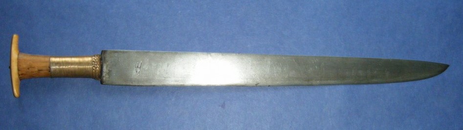

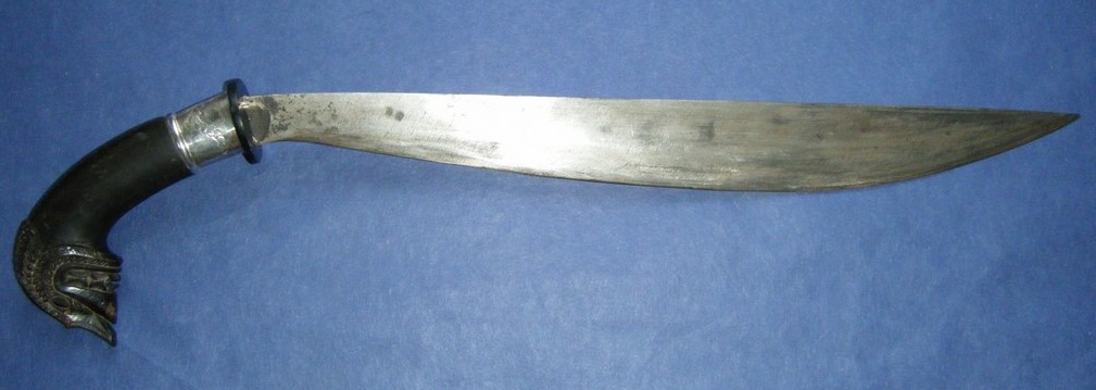

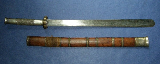

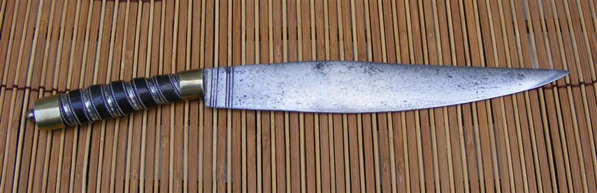

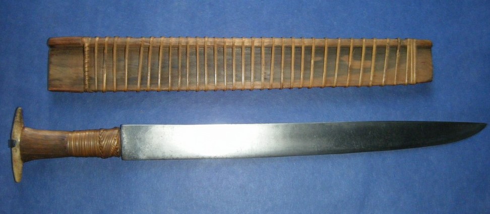

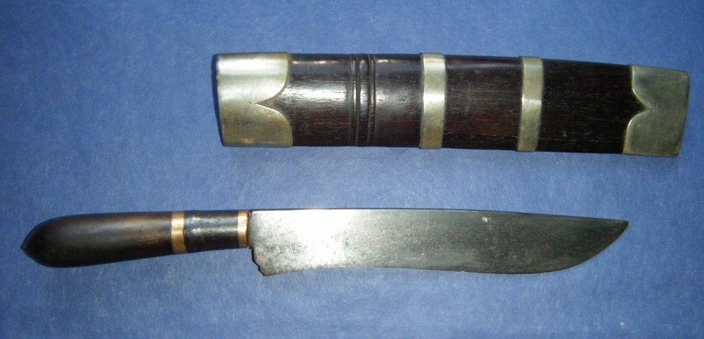

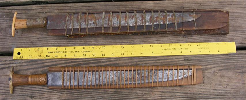

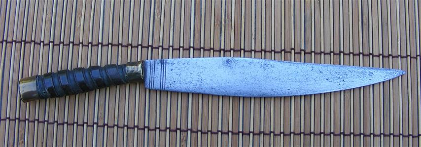

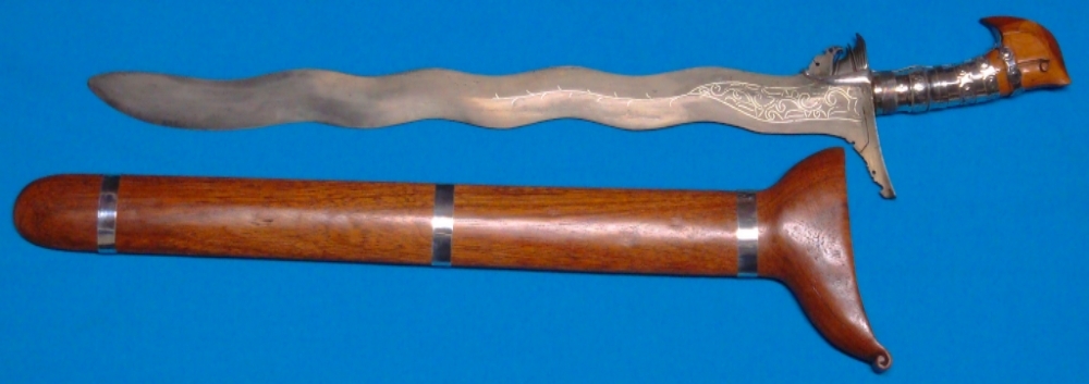

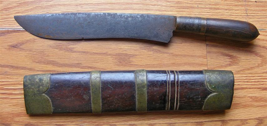

I personally see it like with old cars, either bring it back to former glory or bring it working and in a usable condition. Who wants to collect wrecks?
Some samples of my collection before and after, choice by self!
Old 24th January 2021, 02:13 PM   #8
A few more. I would be able to show several more examples.

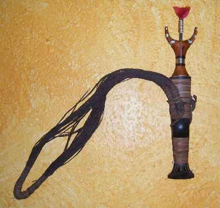

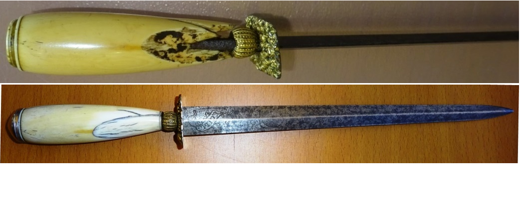

Default Just curious ...
Would you Gentlemem say that this kind of restoration should have not taken place ?

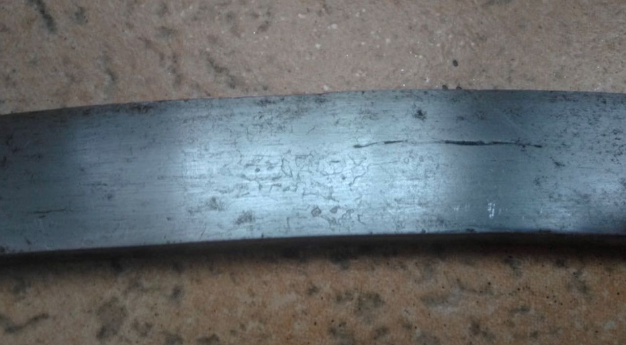

A real problem with amateur restoration, even cleaning the red rust with 250 or 400 or 600 grit can smoothen an edge (I mean, an edge of a fuller, the two edges of the back etc...) when it is normally sharp. I have seen a lot of «*cleaned*» things, finally harmed more than cleaned. I would say that the best to clean active rust is to use dear antler and oil. And let the black rust and pitting to professional

Definitely yes, restoration exactly like this. Restored to the original look!

it is beautiful and of added value ( moneywise I would not know as I lack that knowledge but defenitely from a conservation point of view. Respeito

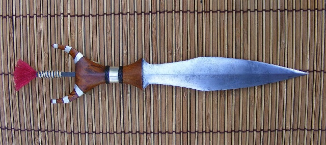

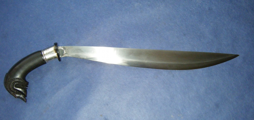

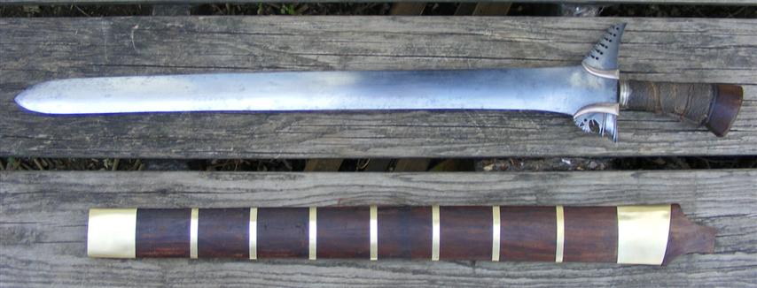

Yes, this I see similar! I've learned by my first job education to file a set square from a piece of iron so I know what I am doing and what I am not able to do I give to people who are able to do it, see here: http://www.vikingsword.com/vb/showth...t=visayan+kris I was sure that this blade was ruined by a real amateur restorer but a good friend was able to give the blade back it's original shape.
Another example is this Visayan knife which seems ruined by an amateur but Roland (our member Roland_M) gives it back the typical beveled edge.

very beautiful done. Question: as the blade looks like new now, what about the grip? Do you do something with or to the grip or leave it as is ?
FYI:
I treated the wooden handle of some pre 1870 pinfire revolvers with almond oil to feed the wood and avoid it from drying out...
Also bone handles of Bosnian ones I treat with a drop of virgin olive oil for the same reason.
Or is this not done with cold weapons?
Old 25th January 2021, 09:59 PM   #24
Hi Gunar,
I don't know about wich blade you speaking, the Visayan kris or the talibon similar blade in the pictures. And yes, both blades received a polish.
All bone, horn, ivory and wooden parts get linseed oil when I receive them. I have nearly closed a big crack in an ivory handle by long bath in linseed oil.

the Visayan knife is a beauty !Cantik.
For me it is never a question of making a weapon look "new" as much as "whole".
I still believe that the less you do the better, but that sometimes it is better to do something than nothing at all.
