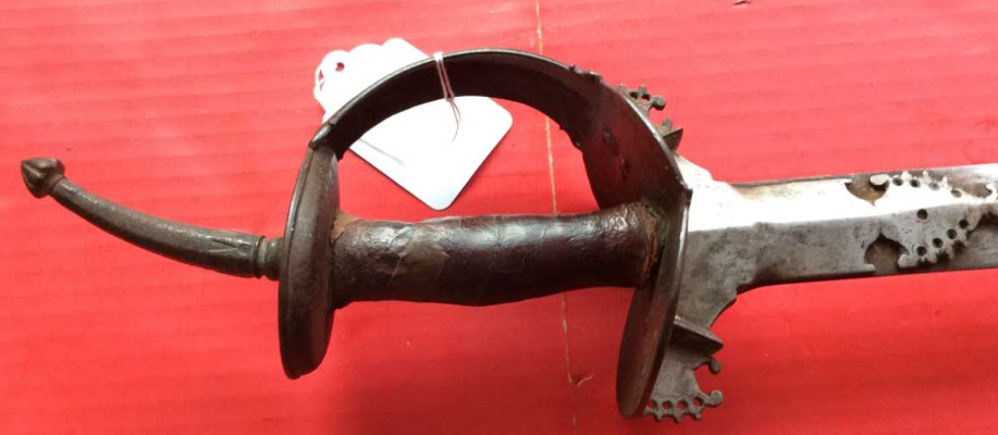

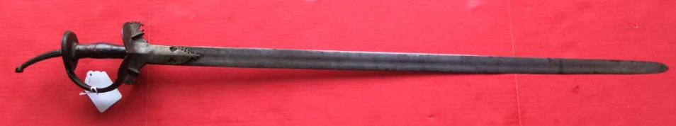

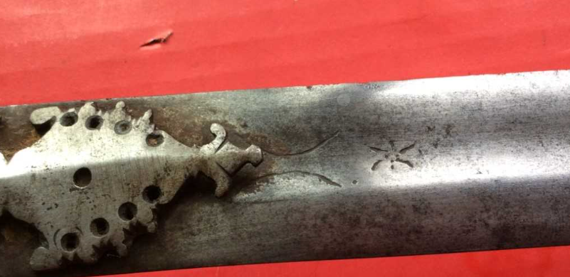

Recently there was a dearth of Indian weapons on the Forum.
To break the spell, I am showing my Firangi. It has a complete handle, even with fully preserved finial, and the leather on the grip is virtually congealed.
I think it is a REAL Firangi, because it has what I think is an old European blade.
It is very springy, 34" long and has a single wide shallow fuller.
There are markings, and you can see them easily.
Any opinions on the dating and the origin of the blade?
Hi Ariel,
I have two questions about REAL firangi.
Is it because it has an European (foreign) blade? If yes, then half of the Indian swords are real firangi.
Or is it because the sword has his complete (typical) basket hilt and an European straight blade? If yes, then you are caught to the "name game" and "collector trap" like all of us...

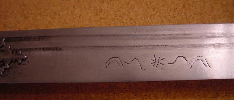

... There are markings, and you can see them easily.
Any opinions on the dating and the origin of the blade? ...

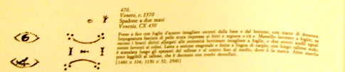

Italian ... XVI century ? .
Old 4th May 2020, 01:28 PM   #5
Thanks, Fernando! Do you think the “ jaws” are Genoese?
Old 4th May 2020, 01:39 PM   #6
Don't take my hint as a solid one, Ariel.
OTOH, have you never heard of Portuguese navigators acquiring blades from Venetian traders and go introduce them in India ? ... thus the Firangi attribution .
See the center symbol in my ex-Firangi ... just for the fun .

Yes David, it makes perfect sense: combining a 16 century European blade with an old European handle makes much better economic sense than using an Indian handle :-)
On the other hand a “ Europe/ Orient” combination may be fully legitimate. The best example is the use of trade blades; also, British sold their outdated blades to local Nizams and Rajahs in the first half of 19th century and let’s not forget about the trophies: even Tipu had one. Also, high ranking British officers used local Indian wootz blades with their regulation handles.
I am beginning to think about a new topic: legitimately old chimeric India-related swords. Might be fun:-)

I would say the markings on the Indian 'firangi' in the OP, which is what I would consider a handsome example, resemble many of the combinations used on North Italian blades, and these were produced for schiavona and other swords typically like this in early 17th c. +
The application of the 'star' by Indian artisans would typically not be added to the familiar 'eyelash'/'sickle mark, but was well known on true Italian blades (see Boccia & Coelho, "Armi Bianchi Italiene").

I have shown this firangi in previous threads, noting that I believed the blade to be of European origin on the basis of its flexibility, presence of 'blisters' (forging flaws) and marks in the fuller (unfortunately rubbed beyond being deciphered).
Since then I have had the opportunity to make a few elemental evaluations by XRF and found that the blade proper shows measurable traces of manganese and sulfur, while the stiffener (presumably of 'local' Indian origin) does not show detectable traces of these two elements. Lesser distinctions were seen for some other elements.

Jim, indeed the sickle/eyelash symbol is not necessarliy Genoese. In fact, and observing (as quoted) Boccia & Coelho's work, we notice that the largest number of those pictured are Venetian (or Veneto); only one from Beluno and another from Genova. But far from such little 'inconsistence', how would we compare rustic marks made in massive trade blades with those perfectly engraved in fine weapons signed by master smiths; unless we judge them as counterfeits ... and hardly rely on them as being their true geographic origin.

As mentioned in the original post, and with the nice example of Indian basket hilt sword, there has been a notable absence of Indian swords of late. With that it seems terminology and classification debates always ensue, with the term FIRANGI being one of the key topics.
In this case, we have focused on the blade markings, which resemble the well known 'sickle' (eyelash, hogs back etc.) type which occur often on blades from numerous sources. As I previously mentioned, early writers typically regarded these as having originated in Genoa, while they actually occurred on blades from other North Italian centers as well, and collectively used variations. There were examples which had the name GENOA actually bracketed by the sickle marks, further fueling the classification as Genoan.
In "Armi Bianch Italiene" (Boccia & Coelho), this most important reference is basically a catalogue which presents many weapon examples from various sources and holdings. As noted, many of the examples' markings are variations of the 'sickle' type, and indeed from Venice...without consulting my copy, I believe there were other locations shown with such marks as well.
Mostly, the 'Genoan' attribution I would consider a generally held notion derived from the case of these Genoan ports and stations being the source of many trade blades, which often bore these type markings.
In time artificers in other locations began spuriously copying these marks, most often the dentated arcs typically seen with three dots at each end of the arcs. In East Europe, these often bracketed the FRINGIA term; and these often are seen in variation on Styrian swords, with Solingen also using them to bracket terms such as ANDREA FERARA.
Having noted all of this, and returning to the topic of the classification 'firangi' and assessment of examples in order to warrant such classification, here we are viewing the markings on this blade as one means of doing this.
It is difficult at best to assess a sword blade to determine whether it is European or a native made example by photos, but the excellent entry by Lee using the metallurgic approach is one viable means.
As suggested, with the preponderance of markings on blades, especially trade blades, there is a degree of fallibility in using these as a determining factor for the geographic origin of blade manufacture. However, making observations on the character of a marking offers some insights based on the method of application and execution, content and positioning of such marks.
In many cases of spurious markings, they are often detected as such by superfluous or incongruent other markings which accompany them. The German use of famed Spanish markings accompanied by other marks which would never have been paired, as well as misspellings etc. is one case in point.

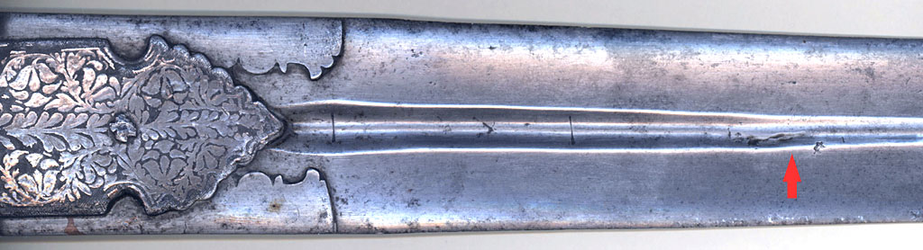

I understand your points, but having handled a lot of Indian blades I am virtually certain that the blade is European.
I do not think I have seen such wide and shallow Fuller on Indian blades and the general appearance of the steel, its sheen, are distinctly not Indian. Together with markings it supports the European origin. And, yes, we cannot pinpoint the origin of the blade other than a general feeling of North Italy.

Old 8th May 2020, 02:57 PM   #28
Default For a change ...
Ariel, i wonder if you have this Elgood PDF work in your library.
Worthy of note is the different way the author uses the Firangy term; as he attributes it to the blade itself and not to the sword as a whole.
Also interesting how he establishes the origin and follow up of the sickle mark.

Old 8th May 2020, 03:23 PM   #29
Kubur
Kubur's Avatar
Posts: 2,145
Yes it is litteraly what it is: firangi blade = european blade
More I look at Ariel blade more I think that the mark is engraved - and not stamped - and therefore it is more likely an Indian blade...

Well observed Kubur, on the engraving or scribing of the mark. As previously noted, relying on photos is typically less than optimum for such determinations, and a caveat I would add is that adding such marks using these methods does not specifically denote India as a source of the blade.
The many entrepots in trade network circuits were well aware of the increased value of markings (especially those associated with quality and integrity on volumes of European blades). It was not unusual for less than skilled persons to attempt to duplicate these in those places as they offered these blades to customers.
The point I made regarding the pairing of the sickle arcs and the 'star' was that in my view, such spurious application of markings did not typically add the other markings often accompanying the key markings in European context configurations.
In native regions ethnographically it was not surprising to see well known European markings copied, such as the 'sickles', however the added marks were not usually added and not regarded as relevant.....it was the key marking which carried or imbued the 'power or magic'.
Also, we cannot discount the fact that even in European settings where unskilled workers could well have applied such marks to trade shipments destined for native markets, such amateur examples are occasionally seen.
