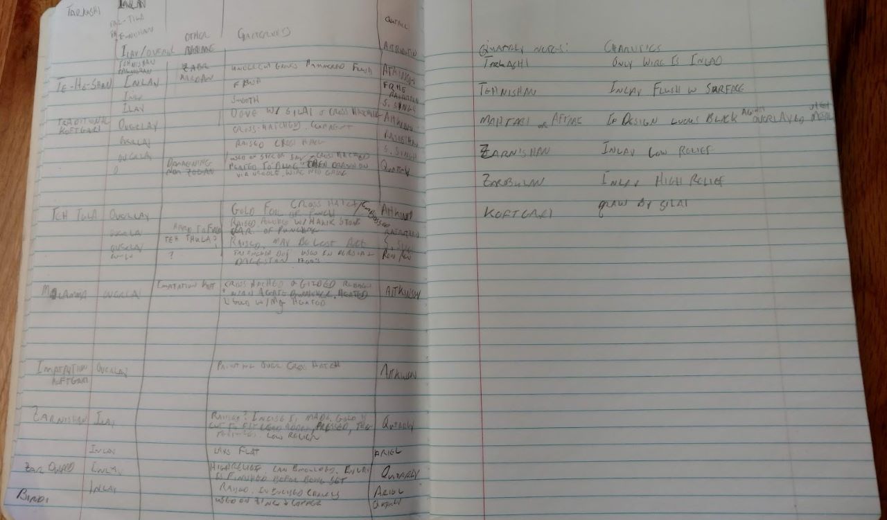

I've included my notes of trying to assimilate and synthesize all these different sources. Provided you are able to read my handwriting this may be a helpful summary of my reading to date. I have been held back in my study by only being fluent in English and reading only a couple more none of which seem to have much source material for this region and art form. Therefore I have been dependent on translations. I have been looking at Russian and Danish books hoping to find a translation. That said I have found at least a years worth of quality material to digest.
Ariel an interesting note on terms meanings drifting across regions seems to be that in Indian parlance there are 3 gradations of inlay relief. While in Caucasus region zarnishan my be flush?
From what I've understood so far is the punches on this blade would most likely be would be of fairly modern origin as they are round and there do not seem to be large kindjals with providence to the 18th century. So probably a modern copy of a redecoration of a later 19th century piece.
