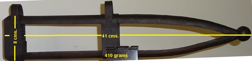

I would love to know what you guys think of this one.
Assuming it all starts by its age, what would you say; old, very old, recent, very recent...
The first two pictures show how it was before i gave it some (hopefuly) non invasive cleaning with penetrating oil and a super soft brass brush.
Rust came off in lose particles, but also in the form of some entire layers from its interior; only one bit is left. I don't know what to think of that upper rivet, that shines white. The spherical (ball) point is secured with a rivet (nail), not just attached by pressure. Those two (sort of) hooks would be for securing the body plates ...
Your comments ill be so much welcome .

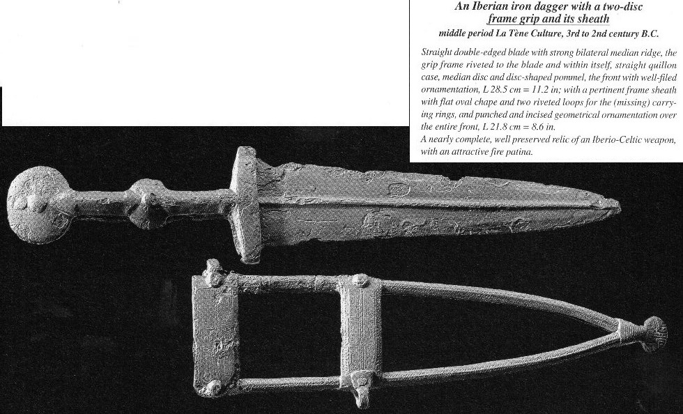

Mel, i would be surprised if this were indeed a tool protection device, with its hanging loops and other design details.
David, that was my own initial atempt at identify this thing. Let me show you what has influenced my thoughts.
Now, my doubts on its age and authencity remain unvanished.
That shining rivet kills me .

When i mention the ball in the end being secured with a 'nail', was just to describe the fixation technique. Actually when i check it again, i can see a pin going through the whole thing; pointing out in both sides

I was told the area that it came from (post #7); a small penisula once occupied by the Romans until the 6th century. Whether it was excavated from under the ground or found at the open air, is something i wonder. But i am almost certain that it was unearthed. However i am not afirming that there is a link between this piece and the Roman occupation.

I think the features are just too close for this not to be the frame of a scabbard for a Celtic / Roman knife of the style shown above. Sometimes we do see Celtic iron artifacts with provenance of good repute that are in amazing shape for being two millennia old, so I'll not casually dismiss this as impossible. I was once led to a nice Celtic long sword with a sheet iron sheath by a thread in another forum ridiculing it an impossible survival. However, in these days of forgeries of just about anything collectible, suspicion of more recent work is also hard to confidently dismiss.

What size is it?
Welsh trench sword scabbard doesn't have those side mounts, it's wood core wrapped cris-cross in OD canvass and has a frog suspension. It's essentially a large romanesque short sword not a knife. It's similar to a giant smatchet, about twice the size.

Size and weight in my post #4.
