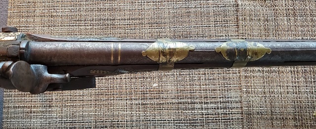

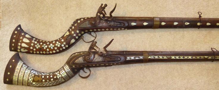

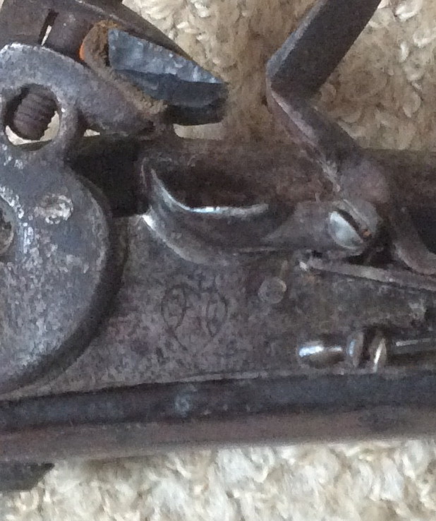

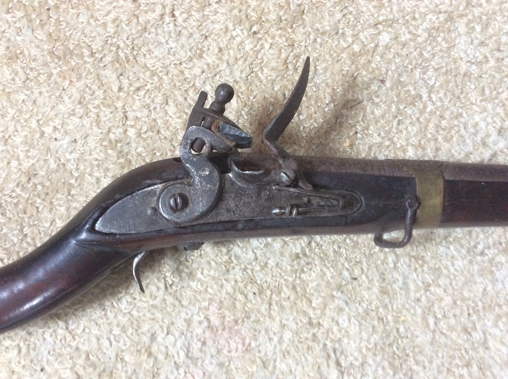

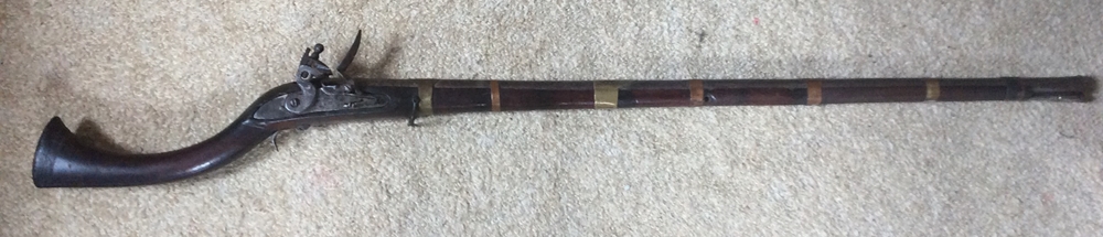

I somehow came across this jezail, in Albuquerque of all places, and have always wanted one after all the years of reading about them here, so I got it.
While it clearly is in the 'tourist' category, and most probably came from the Kuch-e-Morgha (Chicken Street) in Kabul, I would like to think that perhaps it came there from the Khyber regions, and was genuinely fashioned for a Pathan tribesman some time ago.

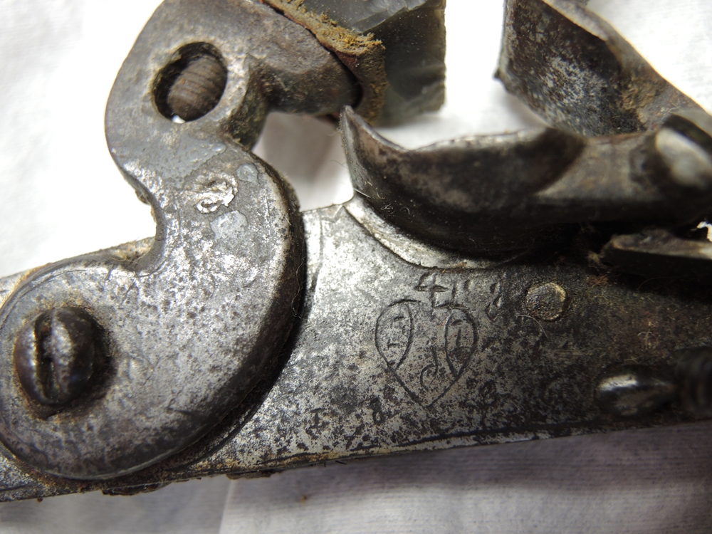

After reviewing as many images as possible of EIC gun locks, I feel that this is quite possibly a genuine lock from probably a Windus pattern Brown Bess that was acquired in the First Anglo-Afghan war in 1839.
The use of the rampant lion on the lock seems to have begun around 1808, with the date on the tail of the lock.
Both these and the quartered heart with initials of EIC seem to have abound in these Afghan regions ever since, and while they were widely copied, this seems close enough to be authentic.
The gun itself highly embellished in style that was used often authentically by tribesmen, was also of course widely produced as souvenirs, often using authentic locks as refurbished from worn old guns.

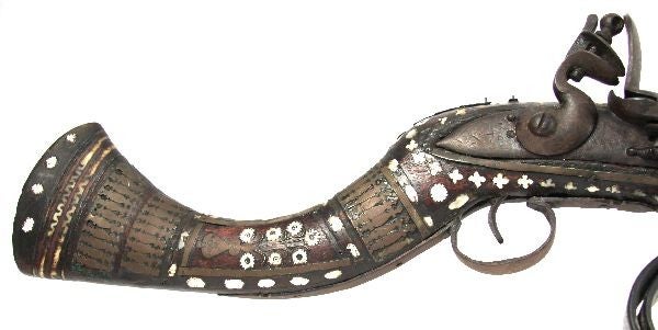

The pics are of the one I acquired, said to be .58 cal. smoothbore.
The red backed lock image is of an known authentic example as comparison.

Jim, the barrel on your new acquisition looks promising and could well be dating back to the 19th century. We will wait for you to receive the gun and take better pictures. I cannot comment on the rest.

Thank you Teodor, I have the gun, I found it in a shop here in Albuquerque. Here is another pic of the barrel. I never realized how long and heavy these things are.

These guns are so - too - many on the market and as you said most of them are decorative.
Then even in the original and functionnal ones, you have some of them made with good and old original pieces English and Persian, then the others locally made but functionnal.
I have some serious doubt about your lock... Of course Rick will tell you everything about your gun.

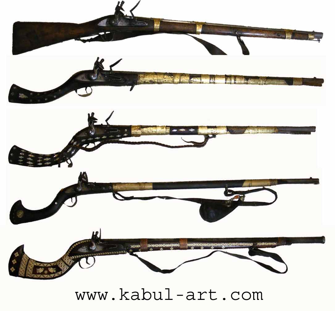

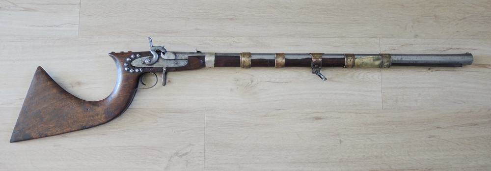

Hope you have somewhere suitable to mount your Jezail in the "Bookmobile"!. Nice example by the way.....
Yes as Kubur says, Rick will no doubt be able to comment on the genuineness of the lock but if you can post a pic of the inside of the lock it will give a clearer idea of origin. Also does the touch hole line up with the bottom of the pan?

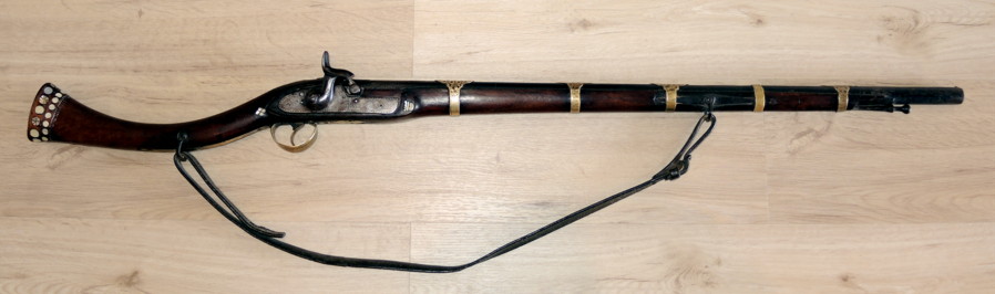

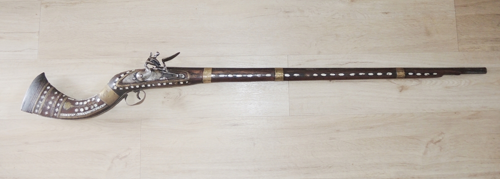

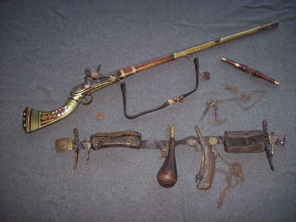

I have a similar Jezail which, though probably functional in terms of shooting, appears as if it could be, though not definitely, made for tourists, as it is also (like yours), prolificly decorated with MOP.
Pics of a couple of my Jezails.

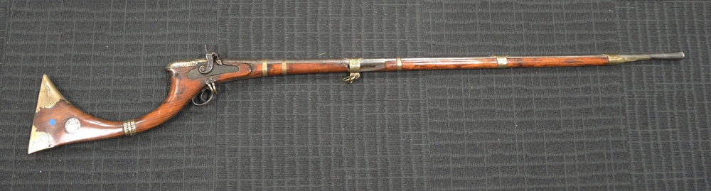

Not to digress from the Jezail, there is another gun of similar shape which is also attributed to Afghanistan, though it's origins are more Sindhi/Baluchistan. It must be remembered that when we today discuss Afghani guns, that the borders have been many times redrawn since colonial days, and what was once part of Afghanistan is now part of Pakistan.
A couple of pics of these guns attached also.

Whether or not your lock is original EIC is difficult to say from the photo's. The main components look as if they could be; but if so it has definitely suffered some local tinkering in that all the screws would appear to be replacements.
Richard

Thank you Kubur, Stu and Richard! I really appreciate this input as I know you guys are well seasoned in the collecting and study of these.
I have had doubts about the lock as well, but in comparing it to some of the examples known authentic it is remarkably well done if indeed a copy. As far as I have known the Afghan copies have never been that faithfully copied, only rendered interpretations. All of the screw positions etc. seem to line up, and the 'work' in adding this lock appears to use similar technique and even hardware to other Afghan components. While the profiled outlining on the perimeters of the lock seem slightly crude in joins, it seems most Afghan examples dont even bother with this detail.
These are just my estimations based on research to get up to speed as I cannot claim any great experience or knowledge on these.

Can anyone share more on the locks on these with closeups and insights on them so as to put together a bit of identification compendium?

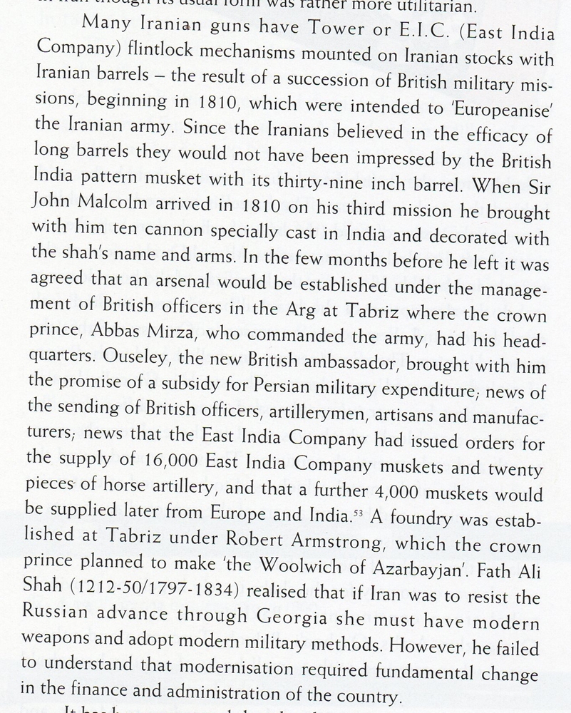

Of course, first i think your lock is an Afghan copy decorative or not i don't know.
Second i think Elgood mentionned somewhere that British had a factory in Persia and then many locks are English made in Iran...
It would explain the quantities found in Afganistan.

Thank you Kubur! and I am inclined to agree, my example does appear to be an Afghan copy, it is not nearly as well executed as the example in the photo (with red background) which is deemed an authentic British lock.
I very much appreciate you sharing this page from Elgood, which I do not have with me presently.
Interesting that the British had manufacturing involvement in Iran, just as they did in Afghanistan with the Machin Khana in Kabul. At the Kabul factory though they did not produce spuriously marked locks etc and the factory had their own use of the Afghan royal stamp.
The spuriously marked locks seem to have come from the independent tribal artisans in Khyber locations such as Darra Khel and others.
Here is the full section relating to EIC guns made in Tabriz.(From Firearms of the Islamic World in the Tareq Museum Kuwait by Elgood).
I seem to remember reading somewhere that Tabriz was not the only place in Persia where these guns were made, but can not remember where I read it.

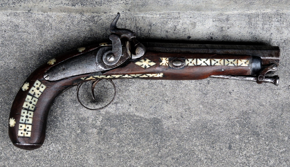

Also an Afghan pistol which is locally made. I do not wish to detract or confuse the current theme of this thread, so it is only posted for interest only and not for comment.

Hi Jim,
Here are pics of the lock of the second jezail shown in my pics. This gun has no trigger guard (as made) and the lock bears the heart shaped bale mark of the EIC, but not the rampant lion. I would class this lock as "genuine" as the lock parts are fixed with screws rather than peened. When I get a moment I will post pics of the other locks.

The so-called sindhi muskets are in fact Balutchi
I would like to see a sindhi with a sindhi gun...
To come back to Jim's musket
They are Pashtun, from the North Khyber pass...

Hi Jim,
Stu
Excellent Stu!!! That is exactly what I am trying to gather here, close ups and detail on these locks.
It seems the rampant lion came in around 1808 with the EIC but as always exact dates are unclear.
The EIC heart seen in your example here has rather than the quartered heart, what is known as the 'flaunched' heart, which has curved lines rather than quarters.
I had always thought that the VEIC stood for Venerable East India Co.
but I learned from David Harding that it was actually United East India Company (or to that effect as the 'U' was seen as a 'V' in those days).
It is amazing to me, and pretty exciting, that the Afghans so thoroughly copied these British markings from the many Brown Bess they obtained during the long years of campaigns in these rugged and vast regions.
Hi Kubur,
As stated in my earlier post to Jim's thread, the boundries have been much redrawn in later times. If you refer to the old map kindly posted by Ibrahiim, you will see that Baluchistan covered a significant area of what is now southern and eastern Afghanistan, and modern day Pakistan.....so,.... the so called Sindhi gun, whether Baloch or Sindi, can be legitimately included as an Afghan weapon. The tribal link (Pashtun) which you allude to is just that....tribal, which according to the more modern map which you have posted, covers many regions of Afghanistan and not just the Khyber Pass region.
Stu

Glad you liked the article Jim. The last rifle I thought looked rather similar to yours. The EIC flintlocks have a charm of their own I must admit.
