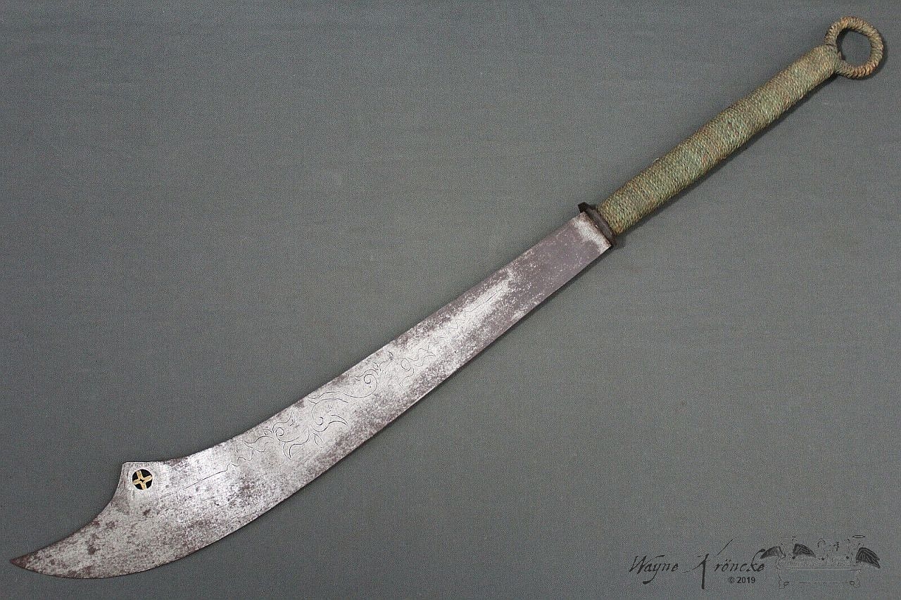

My Vietnamese Truong Dao has a rudimentary 'guard' plate at the grip/blade junction that is essentially a small octagonal steel plate. The Sword above has almost exactly the same plate with the upper guard branch and the knuckle bow emenating from the upper/lower flat edge of that octagonal plate.
