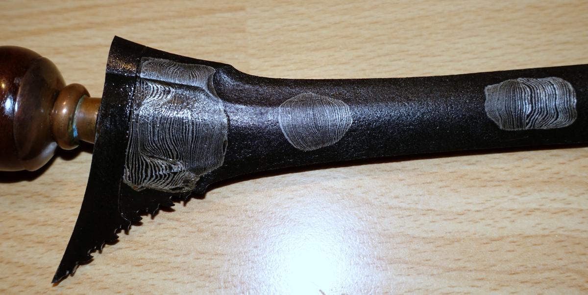

Another newly aquired keris I would like to know more about.

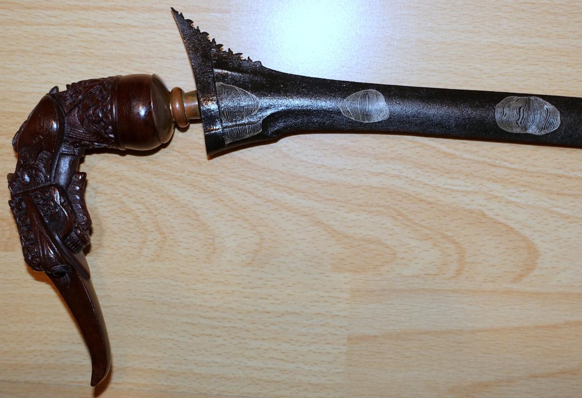

I'm not so sure the Tajong hilt goes with a Sumatran style execution keris, but that blade...…. oh my, I like that.
That's EXACTLY what caught my eye and made me buy it! The pamor of the blade.

Gorgeous blade and a lovely hilt, but to paraphrase Rick, it is not a match made in heaven.

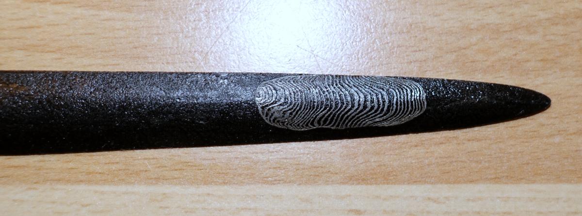

Very beautiful blade, is it pamor tambal?

Yes, that's a beautiful keris penyalang (or panjang). Looks like it is really nicely crafted. But the tajong hilt is completely wrong for this style keris. Below i have posted a number of styles that would be far more appropriate and if this were mine i would replace it with one.

Thank you very much for the very interesting information.
So the pamor is?!
For the time being I have no replacement hilt and I will have to keep like this at least for a while.
Anyhow, I have seen at least another long keris with a similar hilt so maybe they are not that unusually wrong?!

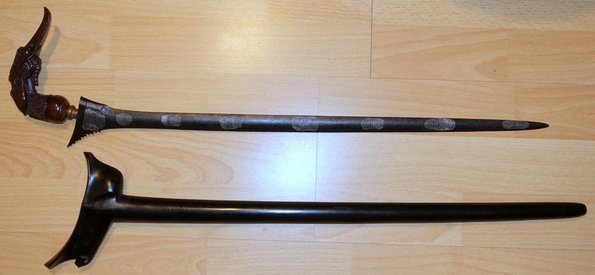

IMO not only the hilt is not appropriate but also the sarong with a notch on the back side in Palembang style? Yes, the blade looks nice with the patches of pamor tambal but I wonder whether this is an old piece as old panjang/ alang/ bahari blades have no visible pamor? Please also compare the fine greneng carving with the one on David's blade which is typical of such old blades.

It does look rather fresh Jean, still I'd take that blade in a heartbeat.
It looks nicely executed (no pun intended) .

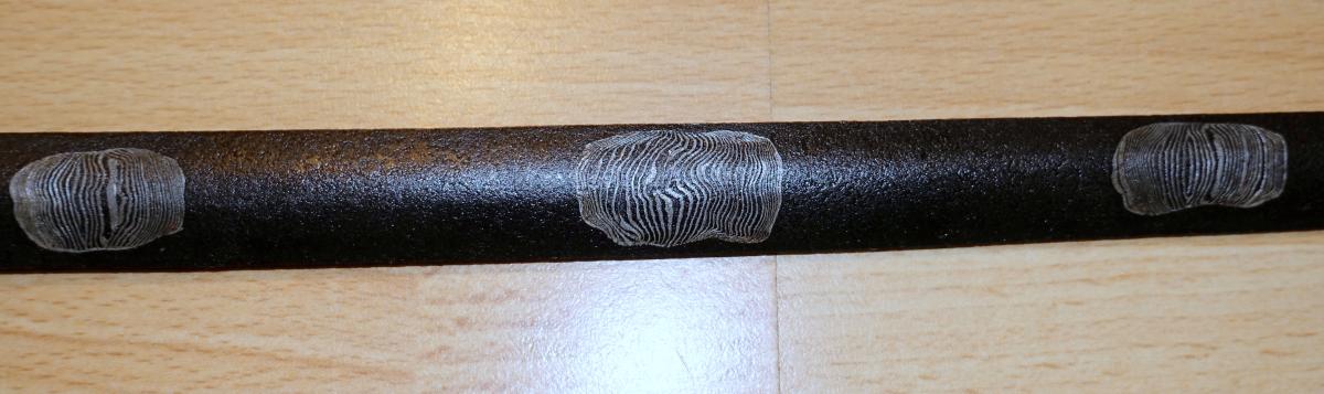

Several things.
Pamor is koro welang tambal. This is a popular pamor in Jawa and Madura.
The greneng appears to be more Javanese than anything else.
Keris panjang were made in Central Jawa after, probably, 1850, and certainly in the PBX era. Some of these keris did carry pamor, but I have never seen nor heard of a complex pamor miring in one of these Javanese keris panjang.
Pamor koro welang is a complex pamor miring.
I have both owned and seen quite a few keris panjang, both with and without pamor, in various styles of dress. These styles include several Javanese styles of dress and Bugis/Peninsula styles of dress. I have never seen a keris panjang in Balinese dress.
There is a distinct tendency amongst present day collectors to want blades that are identifiable as coming from a particular geographic location to be dressed in wrongko and hilt from that location. Taken as a guiding principle this could possibly be acceptable. But in the real world it ignores the way things truly are in keris bearing societies.
For many & various reasons keris blades move around the entire keris bearing world, and indeed, far beyond the keris bearing world. Javanese blades were exported all over S.E. Asia, and as far afield as Sri Lanka, as far back as the 15th century.
We can routinely expect to find keris blades from one area in old keris dress that is associated with another area. In fact, when we move away from centers of population, and areas that were under the influence of one royal house or another, we will find genuine, old, highly regarded keris in a mixture of dress that the previous owners have used, and that reflects the changing fortunes or associations of the previous owners, rather than any geographical influences. For a broadly based collection, perhaps the very best criterion is one of quality.

I had assumed this was indeed a more contemporary blade Jean, and can't really use that as a criticism against this keris. I don't think Marius presented it as an antique. I just find it beautiful and well crafted.
As for the dress it is presented in, yes Alan, we can indeed find keris in old keris dress associated with other areas. But what we have here is a keris panjang that you see as possibly having Javanese origins dressed in a Palembang sheath with a Malaysian Tajong hilt. Firstly tajong keris have their own cultural norms as to the form of the sheath as well as the type of blade they contain. So now we have this Malay hilt form on a keris panjang. The panjang is in a Palembang sheath that is of the panjang type so if it is fitted properly i think we can consider that a good match. But this is not an regular keris. Unless i understand the form incorrectly a keris panjang designates a certain status, does it not? Certainly we do find genuine, old, highly regarded keris in a mixture of dress, but where would a status keris like a panjang be considered appropriate with a tajong hilt? It seems far more likely to me that this keris was dressed with what was available in the dealer's closet than for any authentic usage. I would still be looking for a replacement hilt if it were mine, but it is still a nice keris to look at as is.

David, I have absolutely no critisism of this keris at all.
None.
The blade is indeed finely crafted. No dispute about that at all.
Yes, it could be a dealer's montage, and in this day and age, that applies to many more things than just keris, and it possibly goes without saying that with virtually everything we look we need to have this idea in the back of our minds as we look.
Yes, in the society of origin, the keris panjang probably did have a status level attached to it, but did this status level transfer, along with the keris form, to other societies where the form appears? In so far as Central Jawa is concerned, I can pretty definitely say that it did not.
In respect of this particular complete keris, my assumption is that it has been put together at some time during the last 100 years, it certainly does not look pre-1900 to me.
If that is the case, I personally would be reluctant to tag this keris as anything other than what we can see. I would not assume a dealer's meddling, I would not assume the actions of a private owner in a keris bearing society, nor would I assume the tastes of a collector.
To me this keris is exactly as it is, and able to be described in terms of its individual elements. Anything other than that is pure assumption.
Then, of course, we have the long and continuing association of Palembang with Central Jawa. I personally do not find it strange for a blade from anywhere at all to be presented in Palembang dress.
But is this dress Palembang? To me, it looks Palembangish, ie a Sumatran style of dress that has some echoes of Palembang, and the hilt also looks more like an echo than an original --- not that I am specialist in this field of Sumatra, nor of kingfisher hilts, so don't take these comments of mine as being even verging upon gospel. Perhaps others may care to look just a whisker more closely at the images?
Yes, Palembangish sarong, Tagongish hilt, newish panjangish/ Javanish blade, and tambalish pamor! A nice piece but not suitable for an old-fashioned colector like myself...

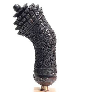

This is not a genuine Tajong hilt - very likely an Indo copy.

I tend to agree with Kai. Am pretty sure that the Tajong hilt is an Indonesian copy, and thus, fairly current.

Alan, i have no doubt that you have keris with a Bugis style wrongko and a tajong hilt. I have also occasionally seen such a combination, though the vast majority of tajong keris i have seen use the more traditional sheath form. And you must admit that just because such a combo may have been married for some time there is no telling exactly how and why this came to be or if such a keris was ever worn in a cultural way or if it simple came together this way in a dealer's back room. I realize that for both you and myself, Keris of the Malaysian Peninsula and Southern Thailand are not our focus of attention, but if you have paid any attention at all to our Malaysian membership on the topic, Tajong is a bit of a serious business and Malaysians tend to be rather critical of such "misinformed" combinations as well as tajong hilts that are made outside if the Peninsula. In fact some seem to view these Jawa and Madura carved tajong as a bit of cultural appropriation. Most tajong keris i have seen that are considered by Malaysian collectors as "real" are indeed dressed with the more traditional sheath and the majority tend to have pandai saras blades, though sometimes some other form of Malay blades do often appear. Though never have i seen such a combo with a panjang. Yes, we all know that strange things do indeed happen across the archipelago, but i don't see how informing Marius of the oddness of such a combination is incorrect simply because sometimes odd combination happen, especially since everything seems to point to the unlikelihood that his combination was ever one that would have been serviceable in a societal context.
I know you are aware of what the proper tajong dress looks like, but here is a link for those who may be wondering.
http://www.vikingsword.com/vb/showth...ghlight=tajong

Yes, David, tajong are nobility hilts and expected to come with suitable attire. Granted, also nobility can fall on hard times and tajong scabbards are pretty fragile.
Marius‘ hilt is not a proper tajong hilt though and the whole ensemble may be regarded as modern art. However, the quality of this hilt is quite poor IMHO and a tapa kuda hilt would look much nicer. Considering the blade, a large Sumatran-style planar hilt might be an even better fit - very difficult to obtain though!
