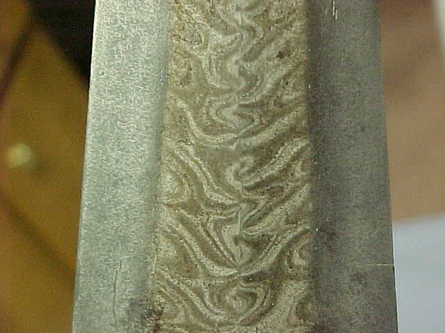

I was looking for khukuris on Ebay when I found a khuk, spearhead, and a puukko in the same auction. All my favorites in the same auction! How lucky is that? The spearhead looked promising, but I didn't get my hopes up. Pictures can be so deceiving. It looks Philippine? Moro? It's laminated, but the pattern is subtle. Thanks for any comments.
Steve
as received
Old 22nd April 2006, 10:09 PM   #2
Posts: 6,435
Sure looks like a Moro budiak to me .

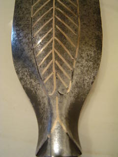

Here's another Budiak Spearhead

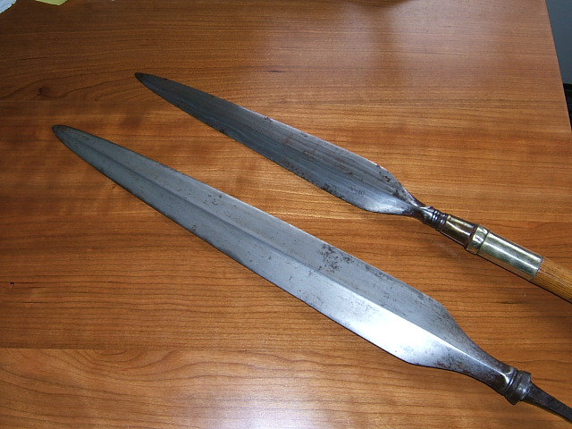

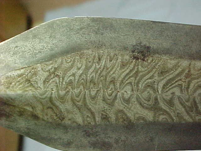

And another ...
I'm always amazed at how short the tangs on these blades are

Rick, is that a twisted core spearhead? what a beauty
panday is offline   Reply With Quote
Old 23rd April 2006, 05:02 PM   #8
Posts: 6,435
Hi Panday , I guess it is ; the veins of metal stand up a little ; you can feel them when you run your fingertip over the panel .

Rick, if it's not too much trouble, could you please post pics of the ferrule and the tailpiece? I was toying with the idea of mounting mine and would like to know what the ferrule looks like.
Thanks!
Steve
Edit: That is gorgeous! And Panday, thanks for the picture of your very nice piece.

Beautiful puppy Panday. Possibly an early budiak?

Here you go Steve ,
The buttcap I added to ; originally this spear came with the two dark metal sleeves you see in the picture . The end of the spear had been drilled to accept a butt spike which was missing . I got lucky and found one on ebay made from brass ; to completely cap the end I bought a vintage brass 10 Ga. shotgun shell and drilled out the center ; the shell just fit under the original sleeves and the spike then went into the hole drilled through the shell casing .
It seemed to me a nice way to finish off an obviously incomplete end for the spear ; all pieces are vintage and could have been found in the Philippines in the 19th C. making it within the realm of plausibility as a treatment for this spear .
The ferrule is a casting and would require either a talented machinist to fabricate from brass stock or would need to be made out of jeweler's wax and fabricated with the lost wax casting method .
This budiak also has a waisted haft that swells at either end where it meets the fittings .

Is that inlay Panday ?
Old 23rd April 2006, 09:35 PM   #13
panday
panday's Avatar
Posts: 50
Yes Rick, that's an inlay, not sure what type of metal though, I was gonna say silver, but it's kind of reddish yellow, any idea?
Old 23rd April 2006, 09:38 PM   #14
Posts: 6,435
Mmmmmmmm .. Suassa .
Really a beautiful point Panday !

Hi Ferg
Here are two from my collection.The smaller one may help you with your rehafting project.
Good Luck
Lew

Probably brass, perhaps with more copper than usual.
Ian.
Originally Posted by panday
Rick,
Old 24th April 2006, 03:19 PM   #19

Hello Panday,
I'm pretty sure that's really silver (alloy). I've seen this kind of yellowish "patina" with several blades (probably all etched with fruits) - one example would be this inlayed kris: http://www.vikingsword.com/vb/showthread.php?t=1243 (the uncleaned inlay looked even more brownish/dark-yellowish than the pics shown).
Old 27th April 2006, 05:54 AM   #26
panday
panday's Avatar
Posts: 50
Originally Posted by kai
Hello Panday,
You're probably right Kai, I just finished comparing the tone of your Krises inlay to my spearhead's, they're about thesame.

Kai, you make a good point. Especially if the copper content is high, like in coin silver (80% silver 20% copper) or lower, the patina/tarnish can look yellow or even brown versus the usual black for sterling (92% silver 8% copper) or higher.
