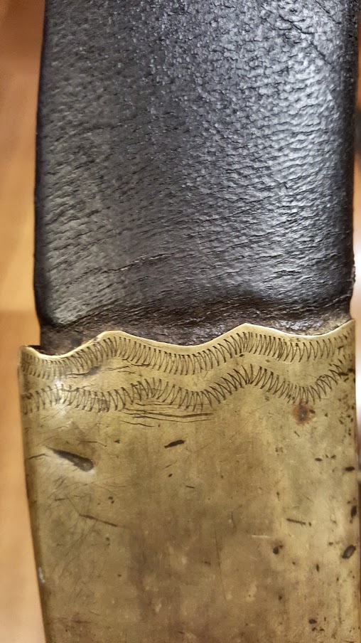

To me it looks Balkan, based on the brass scabbard furniture and the style of the inscriptions on the blade, which is very similar to what you find on Bosnian yataghans. But styles and decoration techniques traveled far and wide within the Ottoman Empire and it is hard to put them within specific borders.

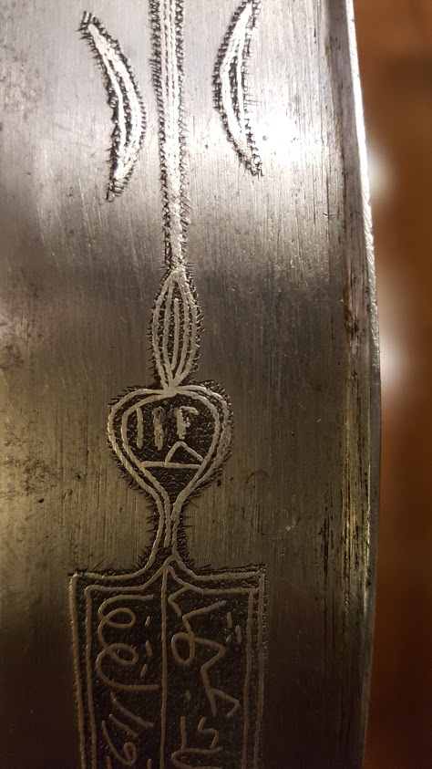

I was able to receive some partial translation:
لافتی الا علی لا سیف الا ذوالفقار
There is no brave young man like Ali, and no sword like Zulfiqar

The zig-zag decoration on the brass scabbard parts also looks like a typical Balkan decorative element to me.
A lot of arms made in the Balkans at one point traveled to Syria and Egypt - seeing a pala in a Syrian context means it was used there, but does not automatically mean it was made there.

I've found the date on the blade and tried to match it with islamic digits.
For me it looks like 1248 which gives 1832
qusko is offline   Reply With Quote
Indeed, weapons traveled throughout the vast Ottoman empire and were produced and used in different places. They did not only move from Balkans to Syria, but other way as well... especially Kilijes and Palas I would think
Similarly, the zigzag decoration was/is not typical Balkan element. It is very common Ottoman (and many other locales) technique.

In the cartouche over two lines is the Arabic …(which I cannot get the second line of... but the top line says in transliterated English)
Ahmed iliyas farhar sahib al malak al ahad
which means: This is my sword made for me by Ahmad Illyas.
Thank you Ibrahiim for translation
