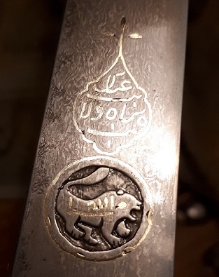

I have this 19th century ottoman shamshir. It has a rather common makers mark and a lion carved in the blade. It has been discussed several times on the forum and I have read Olivers article http://auctionsimperial.com/om-the-p...f-assad-allah/.
I do not however know what the text in the lion says. Any guesses? I does not quite look like the exampel in Olivers article.
EDIT: looked deeper in the forum and found this thread: http://www.vikingsword.com/vb/showth...ht=assad+allah
Looks to me like its says "Assad Allah" like in that exampel from that thread, only mine looks kinda crude compared to that one

G'day Drabant1701,
Yours is very similar to mine discussed on this thread.
http://www.vikingsword.com/vb/showthread.php?t=23381
Cheers,
Bryce

The inscription on the lion appears to read, MASH'ALLAH-- God's blessing.
Please post a closeup.

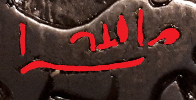

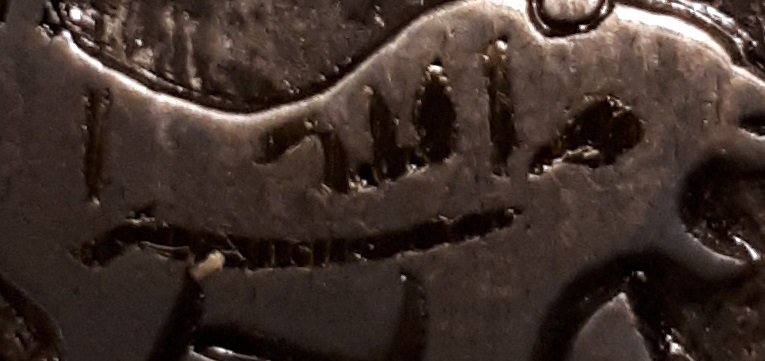

Drabant1701
Drabant1701's Avatar
Join Date: Apr 2015
Location: Sweden
Posts: 181
Thank you Oliver. Here are some close-ups. I dont know if the dot to the far right is the tigers eye or part of the word, seem like a weird place to put an eye imo.
Drabant1701 is offline   Reply With Quote
Old 29th December 2018, 04:22 PM   #5
Oliver Pinchot
Join Date: Sep 2012
Posts: 478
Please repost the large pic without the red marks
Larger picture.
