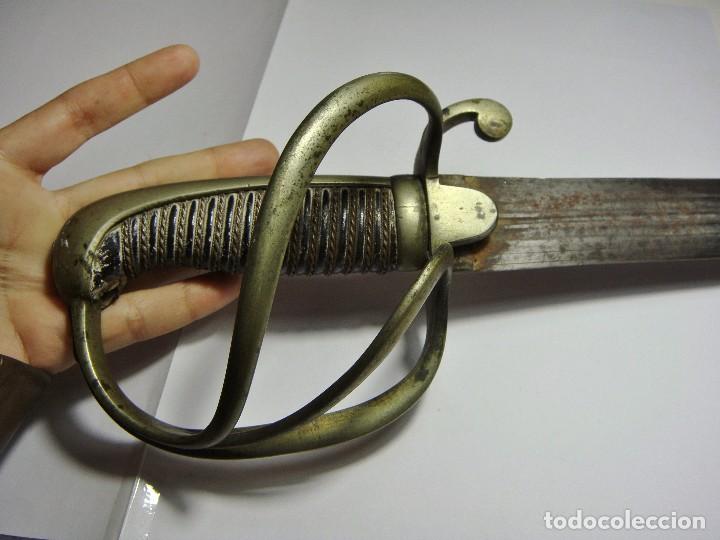

Here we have a Spanish broadsword or cutlass from the first quarter of the 19th century. This distinctive hilt form is discussed in 'Spanish Military Weapons in Colonial America:1700-1821' (Brinckerhoff & Chamberlain). See plates 174 175,176.
This form of hilt consists of a small shallow cup with a curved cross guard, flattened quillons, a three branch guard with screws or rivets securing them to the knucklebow. Grips on these colonial pieces are bone or horn, often scored and sometimes of a 'plump' swollen form such as this example.
This sword stands out in that it doesn't have a curved saber blade. Instead it has a much older straight broadsword blade, probably German made with rounded tip and three line fullers. The old corrosion on the edge is a testimony to age and possibly from salt exposure.

The interesting dot pattern decoration and small design on the cup ( a pic of a bird? Snake?) is commonly seen on these colonial pieces. The riveted branches of the guard always reminded me of later Mexican spurs and iron work. Note the 'fat' horn grip...

I believe these swords are rather from the 1850s. They have usually Solingen export blades from that time, made expressly for the South American market, and therefore marked as Toledo and spurious dates (made in the 1840s but dated in the 1820s).
Possibly they are contemporary of the Chinaco sabers of the rebellion against Maximilian.
This one is marked as Toledo 1827.
They are another step towards the Guerrilla Commander swords of Porfirio times (last picture).
