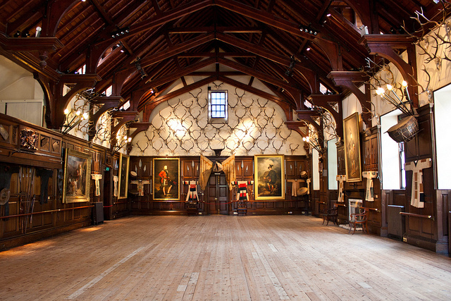

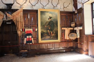

Digging around, I have come up with two further images of these shields, one in the Governor's palace in Khartoum, the other in Blair Castle, Scotland.

Great photos! Are those suits hanging on the wall of Blair Castle padded cotton horseman's tunics ? Strange coincidence that by following the links in another post just added (wanting help with a german translation) you get to a drawing of a Sudanese horseman wearing armour and also to an illustration of a shield similar to the ones we have been discussing. The German paper is about the Beja, which seems to be a catch-all name for groups living between the Nile and Red Sea if you believe Wikipedia.

Thanks. The image I believe shows a chain mail jacket, however Blair Castle does have a padded tunic(s). Here are a few more images.
