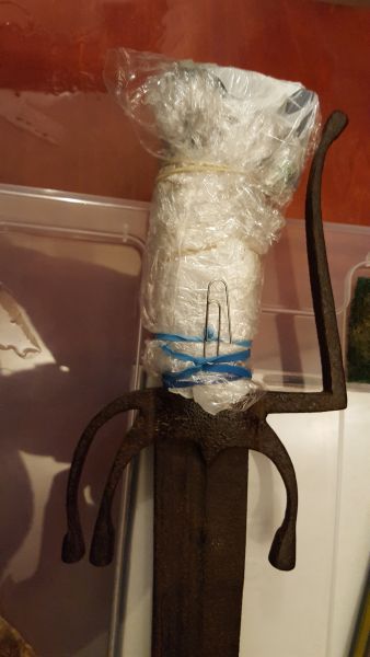

Hello, this is my first post. My name is Kamal. I recently acquired an antique Moroccan Nimcha, the mountings are all very solid but it was in frightful state. Completely covered with a thick layer of red rust, and the horn handles had started de-laminating.
I applied a copious quantity of olive oil to the horn handles, and wrapped them in plastic wrap to have them re-hydrate. Then I used a commercial rust remover on the blade with very light scrubbing with green scotch pads, and a brass brush.

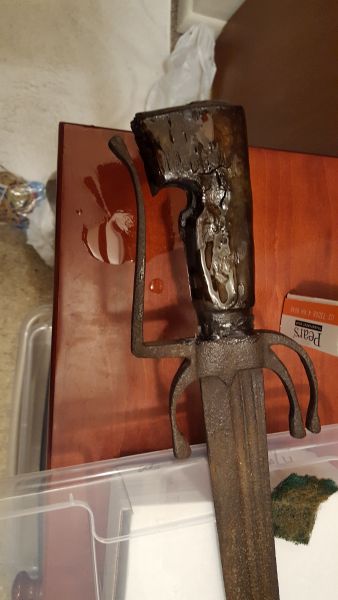

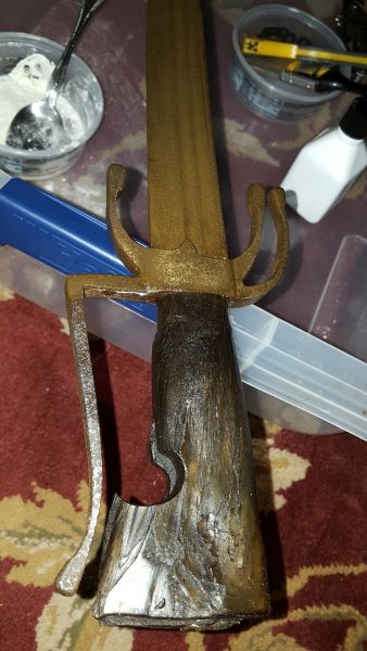

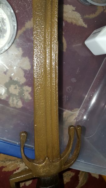

Thank you everyone for the replies. These are a few pictures of the blade and the handle. The shiny stuff on the handle is oil. I decided to apply olive oil and wrap it to let it soak in.
kamals is offline   Reply With Quote

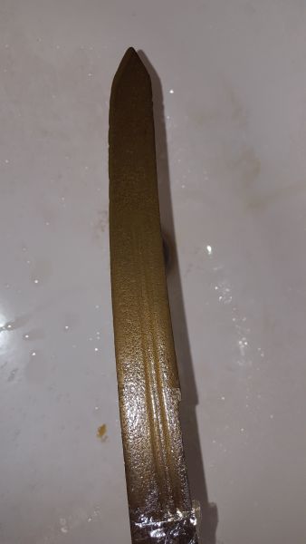

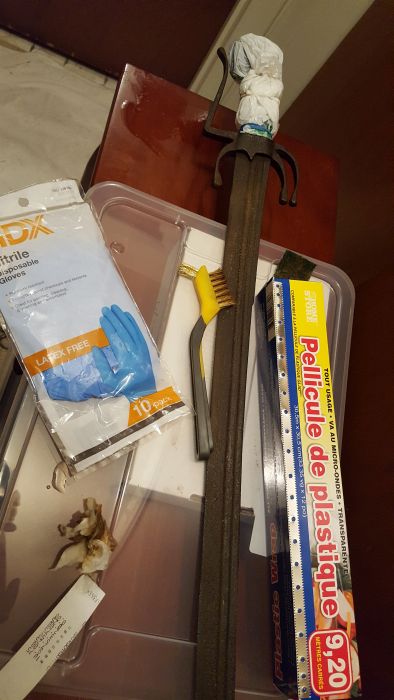

kronckew, it's a beauty. A pity about the aggressive sanding. I almost caught myself doing the same thing! I started a bit of sanding with 2000 grit paper then stopped myself before I did any real damage. I just got a bottle or Renaissance De- Corrosion fluid, it was expensive but so far seems to be helping. Last week, before that I tried Metal Rescue Rust Remover Bath brand, painting it liberally on the blade and guard then saran wrapping it all for 48 hours. Then I took a brash brush to it. It helped some.
These are all from June 15th

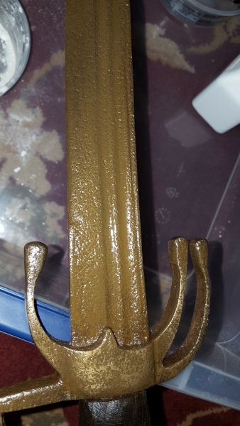

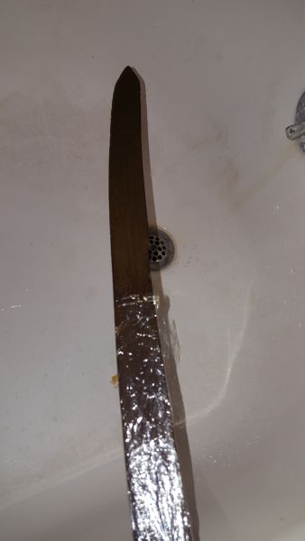

These are from tonight. The rust is somewhat gone from the guard, though there is deep black pitting.
In the previous photos the glossy stuff on the handle was oil. Unfortunately it deeply darkened the horn. Which is, itself, pretty badly de- aminated (I'll try to get a good close-up picture of the handle).
Cheers everyone, thanks !
