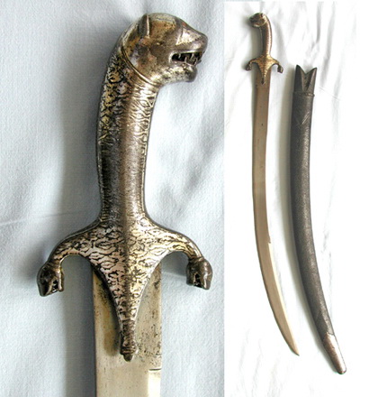

I doubt that the hilt is a 'Tipu hilt', as I dont remember to have seen a horse head on any of the hilts attributed to Tipu.
The way the ears are turned points towards a Marwari breed.
A hilt attributed to South India, possible Maysore 18th century can be seen in 'A Passion for Indian Arms' pp. 266-268.

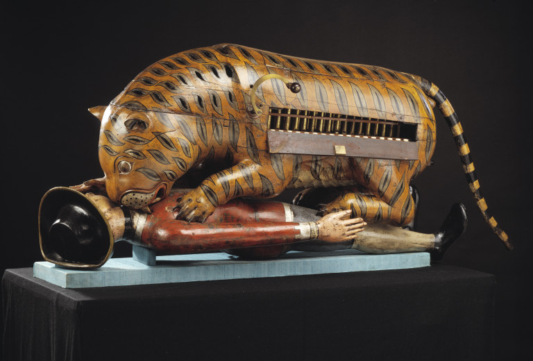

The emblem characterizing Tipu Sultan was the tiger. He identified strongly with this symbol and was called the "Tiger of Mysore." There is a very famous item in the V&A Museum called Tipu's Tiger that is a mechanical musical device portraying a tiger eating a European.
As Jens states, I cannot recall any iconography associated with Tipu that featured a horse.

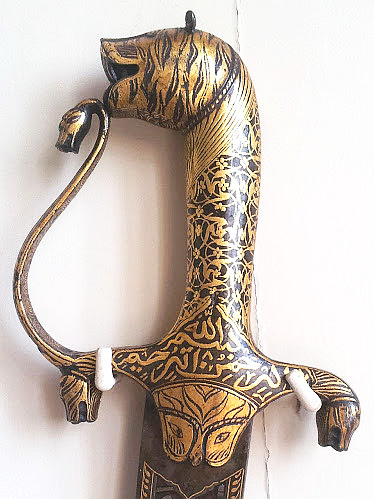

If you look closely Ian and Jens you can see a tiger on the quillon and also on the chappe. Also you can see bubri stripes which were used by Tipu as a trademark on almost everything he owned. Here is another example:

You are right, but the main thing is the top of the hilt - a horse head.
The hilt you now show is a different hilt as the one you showed earlier, and 'maybe' this could have some connection to Tipu - I dont really know, as I am not a specialist on Tipu.
Maybe the 'bubris's' are not that, maybe they are 'cintamani's'.
Attached the sword I referred to in my former mail.

This interesting mechanical toy was indeed most symbolic to Tipu, who had gained a deep hatred for the British, and is keenly representing him(the tiger of Mysore) killing what is described as a 'European' but the allegory is clearly toward the British. It allegedly represents the death of the son of the British commander who was killed by a tiger Dec.22, 1792, but the larger meaning is clear.

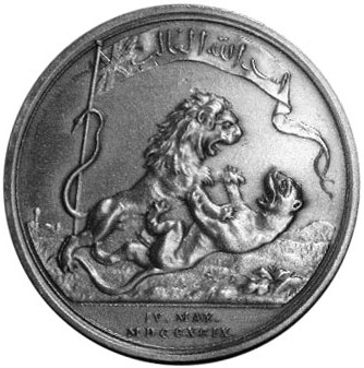

Such totemic symbolism is seen in the Seringpatam medal issued by the British in 1808, with a British lion killing a tiger (Mysore).

Thanks for the beautiful and detailed response Jim. You are a true scholar and a gentleman. Tipu Sultan was unique among Indian princes because he developed a design element around the tiger which makes objects associated with him so easily identifiable. Here is an example:
