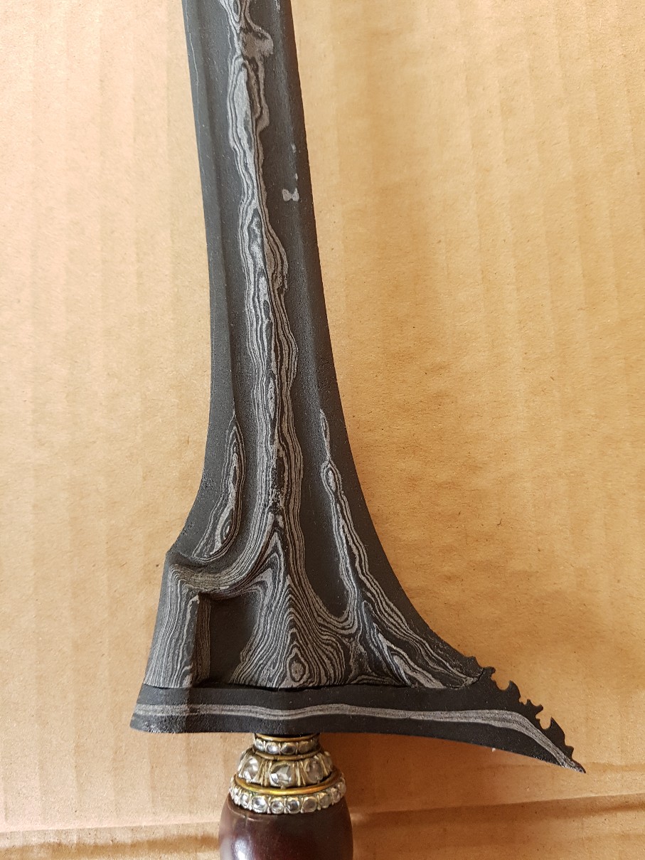

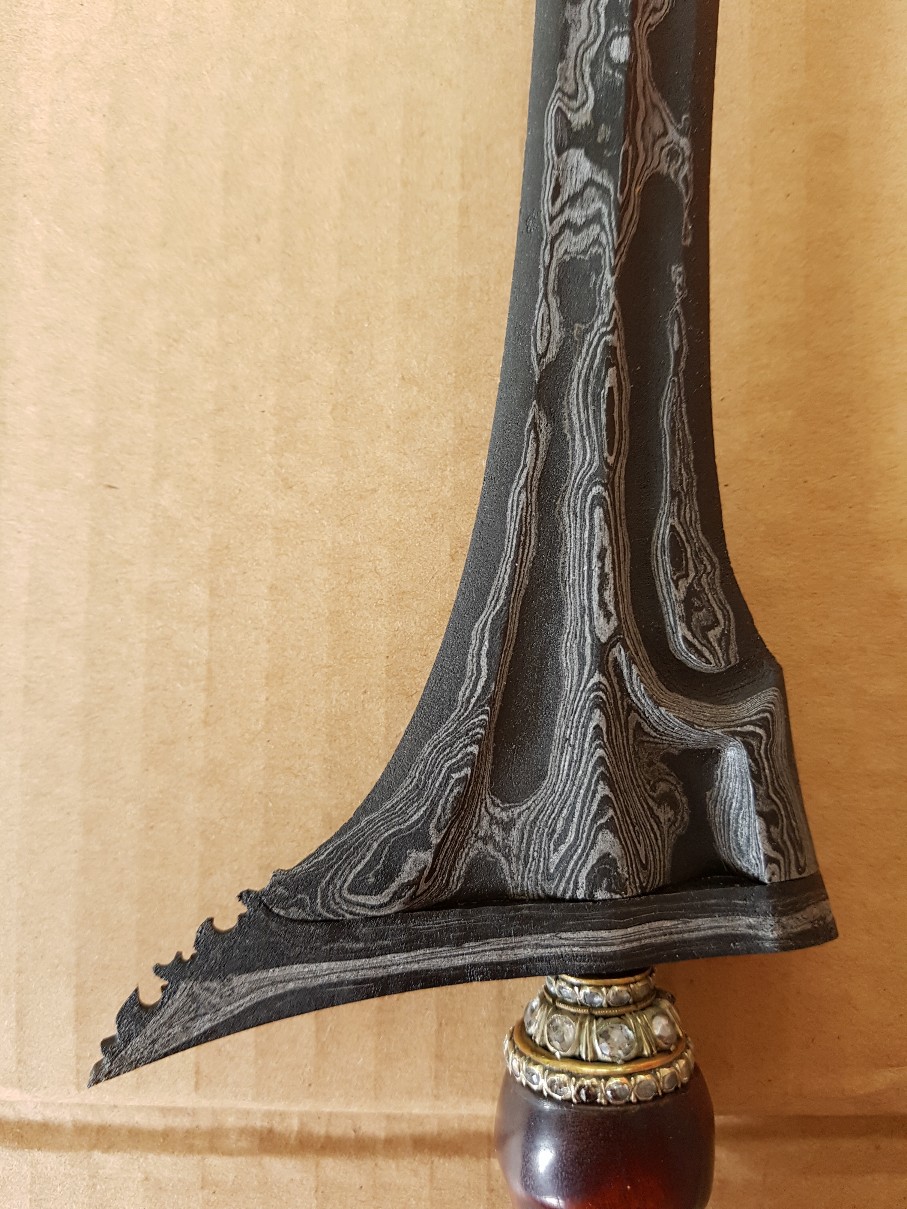

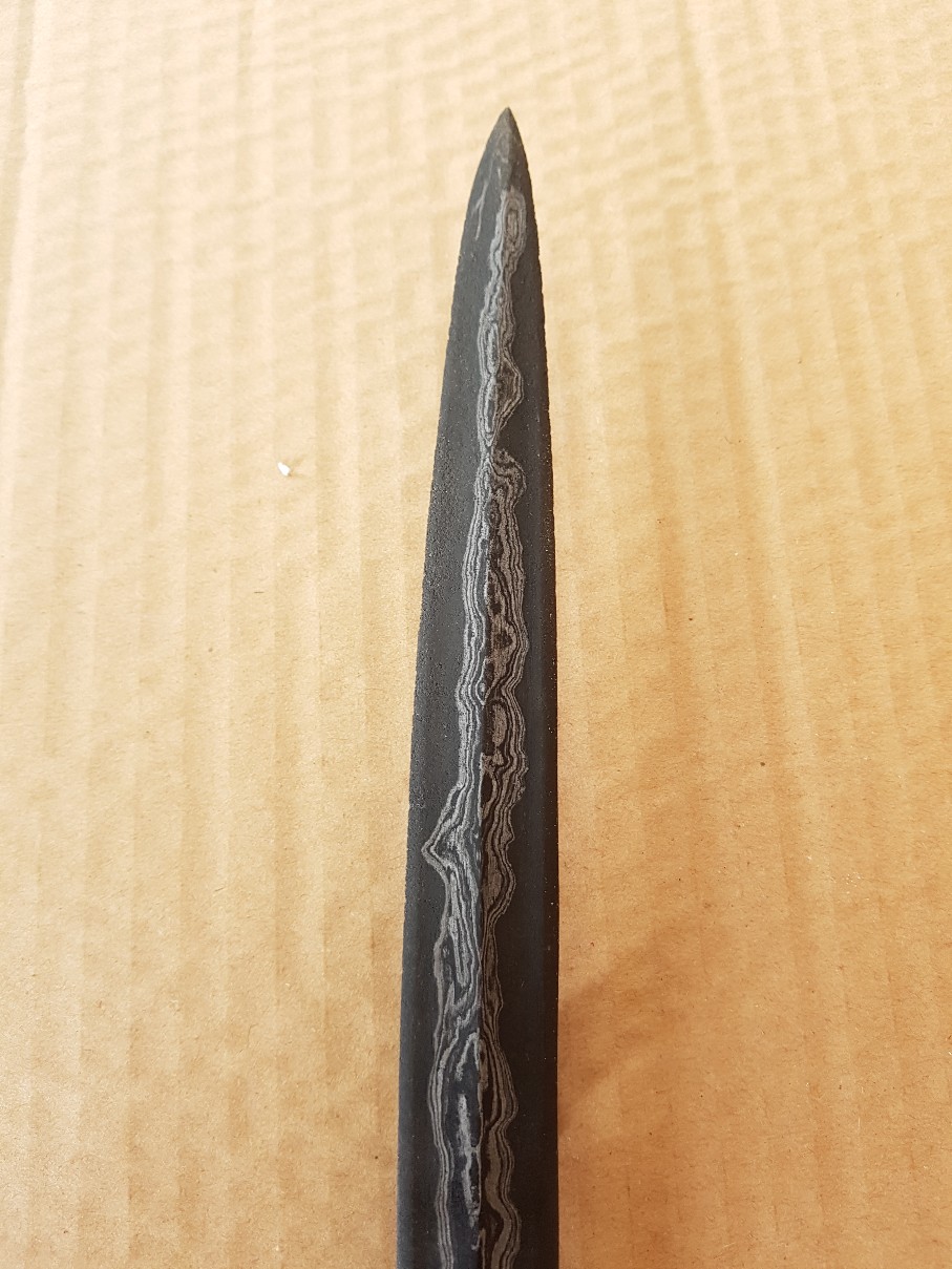

I bought this keris because it had uncommon pamor visual. The pamor had a malela looks. (Hard to describe, will add the picture below). But, when I cleaned (warang) it again, the pamor's visual become quite normal now. There are a couple of things that confuse me to determine whether this keris is sepuh (old) or kamardikan.
In my opinion, things that indicate that this keris maybe old:
1. The form of the greneng. I think it is hard to find this kind of greneng in kamardikan keris. But, maybe I haven't seen enough samples to compare with mine.
2. There is some corossion in the wilah, like in the landhep part, in gonjo, and in the some part of the wilah that looks like it was formed due to long times. But, once again, kamardikan keris timeline is quite long, has been 70+ years now. Maybe in decades it can creates some corossion that similar to my keris.
And things that make me doubt to determine is sepuh:

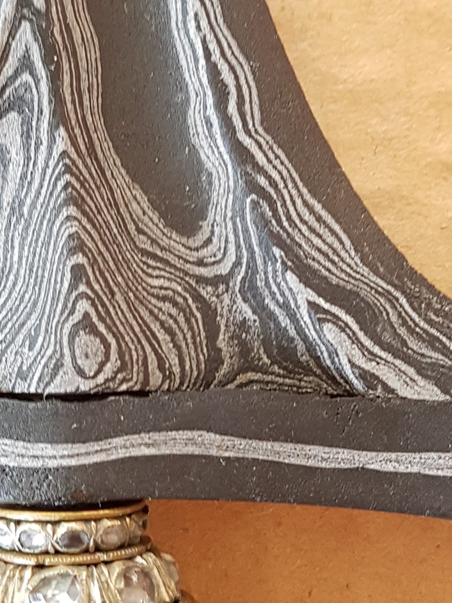

1. There is some rough work in this keris. There is some scratches in both side of tikel alis dan pejetan.
2. The form of gonjo. Like in the picture attached, there is a uneven thin bulge on one edge of the gonjo.
3. There are scratches on gonjo and pesi joints. I have never seen that kind of form in other kerises.
Hope anyone is willing to share his opinion to me.
Thanks,
Joe

Hi Joe.
Photos would undoubtably help.

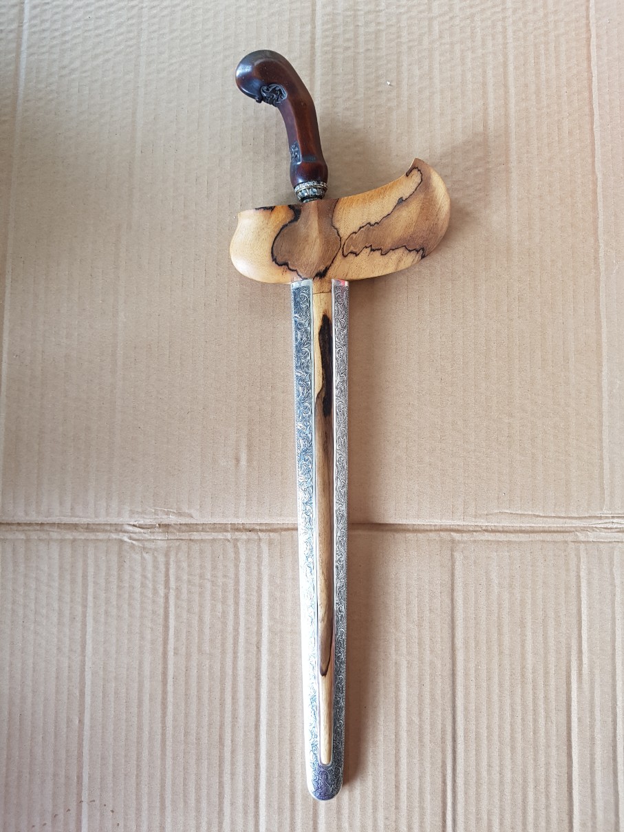

Hello David,
I have attached the photos, but I dont know why they did not show up. Thank you for your information . Hope the photos will shop up now
Additional information :
Gayaman in the picture is the original warongko when I got this keris. I just replace the old gandar and pendok (banyumas bunton style use mamas) with new ones like in the picture. My mranggi just resharpened the edges and "gebeg ulang" (dont know the English words) the gayaman.
Thank you,
Joe
Bejo is offline   Reply With Quote

More photos about :
1. The original warongko and still dirty keris.
2. The keris after the first warang with more malela looks like pamor.

What a mess around the pesi hole!
Hello Jean,
Yes, I agree with that. Do you have any idea the cause of that scratches?
Thank you,
Joe
Old 8th August 2017, 10:57 PM   #9
Posts: 7,255
Yeah, the way in which the gonjo has been fixed is a bit untidy, but whoever has done it has probably done the best he could.
From the pics, it looks like the hole was too big, or the pesi too small, so a collar has been made to reduce hole diameter, and then that added collar has been tightened by punching with a drift. This sort of repair is an old one, before we had things like wonder adhesives. In my opinion it is an enhancement to the collectability of the keris, rather than something undesirable:- it tells the story of the keris.
Thank you for your explanation. It enlightens me about this keris more.

Hello Gustav,
I really agree with that statement. Happened to me sometimes. Just dont look for the mysteriousness, but be grateful when you feel it.
Just my guess, maybe my keris is done by the Panjak. Maybe he still in the process for perfection, so there is still some rough work in this keris.
Hello A. G. Maisey. Thank you for sharing information about Empu keris. It gives me better knowledge to know more about keris.
Thank you,
Joe

You are most welcome Joe.
Yeah, I think you could be right about the possible maker. In fact, I think it is possible that more than a few of the lesser keris that we see were made by somebody associated with keris, rather than empus, or pandai keris, or even smiths.
In Solo during the 1980's, there was a m'ranggi who worked for me, in fact I knew him for 12 or 14 years, and he made a few keris. They were Solo pattern, and pretty good productions, he had a smith make the forging then he carved it. Also one of Pak Pauzan's panjaks (striker) used to make keris, he forged them in Pakpus' forge in his own time and took them home to carve.

Alan, thank you for your kind initial reply to my query. You say the core is clearly visible. That, of course, is when you know what you are looking at, and you know what to look for. I am struggling to see the core, and the reason is that I don't know what to look for.
What is a core? In my limited knowledge, a core is a hard steel sheet inserted between the laminated pieces at a certain stage of the forging process. I understand by that, that the core metal is virtually covered (hidden from sight) by the pamor. Inspecting post #3, in which Bejo gave us good pics, I see with my untrained eye a refurbished blade (appearing so new as to have been made yesterday) with a laminated pattern that looks like islands of silver-colored metal lying in a sea of black metal. Of course, we have here an iron-pamor combination. But what does the pamor consist of? It would be "dark" iron and either nickel or white (phosphorus-rich) iron. It gives a sharp contrast. But in Bejo's blade I see ONLY two colors: very light and very dark. Where does the core steel lie? And what is the color of the core steel? Surely it should run all along the edge.
Alan, you say the core is the narrow black border between the blade edge and the start of the pamor. Well, then ALL the very dark metal I see = core material! Can that be? I thought the steel core was nearly fully imbedded between the pamor layers, and that only a very narrow strip can be seen at the very edge. This I fail to see in Bejo's pics. So it is clear from the above I am as confused as ever!
I'm making many statements in the above as if they are facts. However, there is a purpose to that. If I do not report what I think I see, no-one can help me see where my reasoning is faulty. Please could someone put me on the right track? Thank you!

Hello Johan, at this picture you can see clearly the core. Hope this helps.

Johan, a keris blade is made by forge welding a piece of steel between two pieces of pamor material that has been made by forge welding iron and a contrasting material.
If the forging is well made and then well carved, the edge of the steel core projects beyond the pamor material around all the edges of the blade.
The diagram that Detlef has drawn shows the steel core where it has emerged from the pamor and now forms the edge of the blade.
The blade is in fact a laminated sandwich, pamor on the faces of the blade, steel core running through the centre of the blade and forming the cutting edges.

Yes, Sajen, thank you for indicating it, and this is what I expect to see, and it is clear on the blade that Gustav has presented. And it is a nice illustration of what Alan is describing. But I have been referring to Bejo's blade all along, specifically the excellent 3rd picture from the top on Bejo's post #3. I'm looking for that same edge showing the steel, but I do not find it at all.

Hello Johan,
use the picture from the uncleaned blade and make it bigger on your screen and you will see.

Johan, if you look at the deep fullers in the blade base, you will also see the core, in cutting the fullers (kruwingan) the maker has cut through the pamor material and exposed the core.
In post#3, third image down, on the left hand side of the blade you will see a very faint lighter line. This can indicate one of two things, the first is that the blade edge was forged down prior to the cold work being done, the second is that we can see a weld joint in the core. Impossible to know which from a photo, this would need examination under magnification.
All of the wider black areas that we can see on the blade are most probably blade core. There is a very, very faint possibility that the inside layer of iron in the pamor was left thicker than the outside layers, and what we can see is not blade core, but rather an attempt to economise on work time and fuel, but this is unlikely.
Think of a pamor blade as a ham on rye sandwich, with the ham sticking out from the bread; cut the bread too thin, and you'll likely see bits of the ham trough the bread.
There is a method of blade construction that was sometimes used in very old blades, Mataram and before, where steel core construction is not used. It is an older method economises on steel by using an overlapping double V construction, similar to that used in Viking swords, where a steel edge is welded into the solid blade core.

Alan, I see the faint lighter line you describe. I had in my imagination expected the core strip to be more apparant. Thank you & Sajen for the trouble to point these out.
