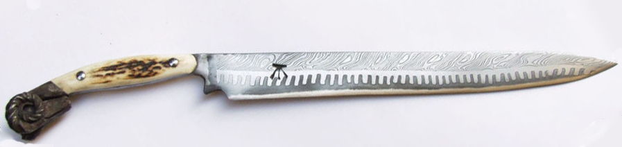

just to show the extremes of colourisation due to steel compositions, here is a recent knife. the back is of twisted 'damascus' (pattern welded) and the hard steel cutting edge joins serrated to the middle rod of mild steel. the actual cutting edge is bright because it's been sharpened on a diamond 'stone'.
