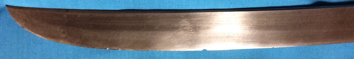

Here are some blade pictures that I did not alter except to resize for posting.
Some of the notches on the blade edge are "V" shaped, indicating edge blade to edge blade contact, even though this is a ceremonial weapon.
Note: I did not etch the blade at all.
I remember few years ago to have seen children playing with antique swords of their father and hitting some stones "just for fun"...
It's not the first time that i saw comments about blade / sword use and really you are very strong if you can tell how the damages have been done!

Hi Jose,
That's a good quality blade which is probably about the same age as the fittings. Your sword was likely intended for a sawbwa (local leader) originally. As I noted above, this is a prestigious sword for show and not for use. The delicate ivory hilt would likely split from the percussive forces when being used as a weapon.
It's a pity about the edge damage. As Kubar notes, it is hard to know exactly how it occurred. Many of these high quality swords were taken back to England by wealthy travelers, British officials and plantation owners, etc. during the colonial period of Burmese history. Many of the Burmese dha that come on the market are from the estates of these folks and their descendants. Such swords were, indeed, subject to damage from kids getting hold of them and trying to cut all sorts of things. Some nice kukhris and Indian swords suffered a similar fate. English dealers refer to such damaged items as having been "kidded." We may never know if your sword suffered this form of abuse, but it's possible.
Nice daab Battara. That is interesting to see the nicks in the blade. Some of the nicks are more "V" like and others more broad "U" shape...I wonder if that says something about the hardness of type of material it came into contact with or angle of percussion. One time I remember a weapons restorator commenting on a piece of mine that had several "V" nicks in it that this most likely meant the heat treatment was not good and that a properly tempered blade should have more "U" shaped nicks. Yours you can see the temper line...but looking at how the spine is finished towards the tip it makes me think this is a later 19th century made.
