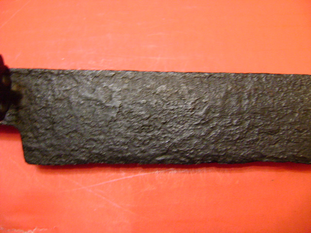

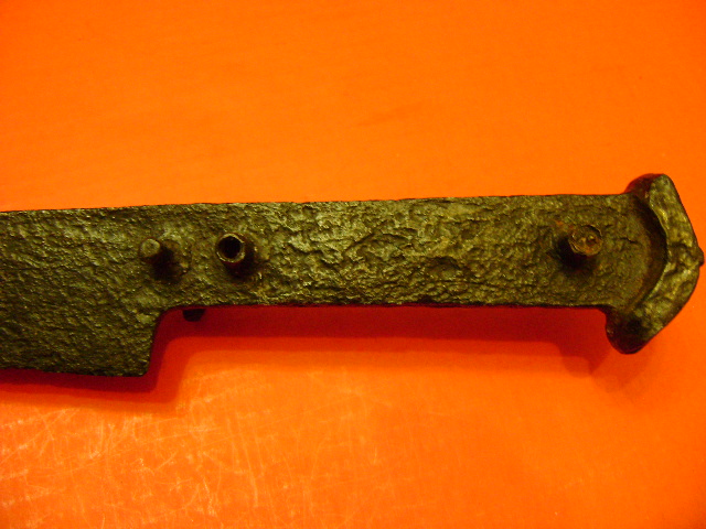

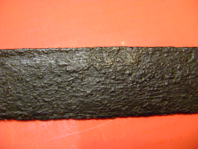

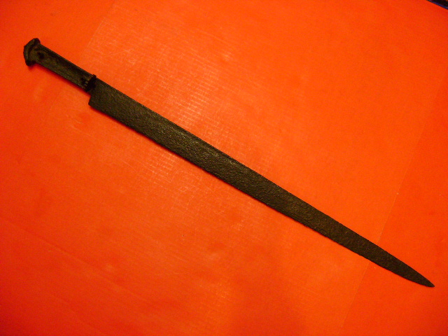

I have shown this 15 cen excavated Bauernwehr before, but think it might be useful here.
Stabilized with tannic acid.
There are commercial Rust Converters: tannin, polymer and a bit of phosphoric acid

Old 26th December 2016, 10:28 PM   #18

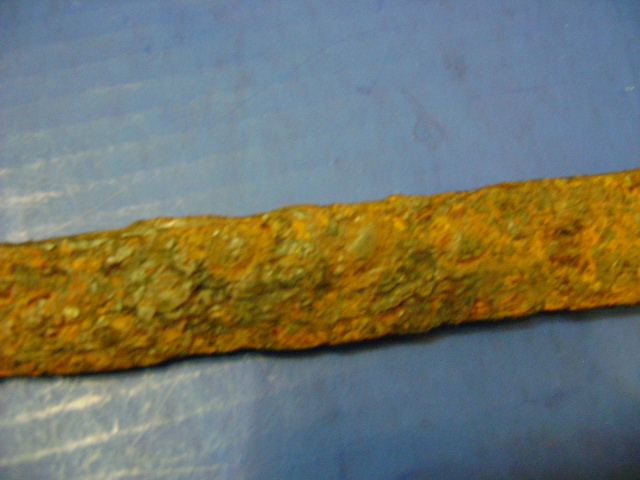

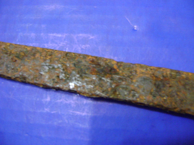

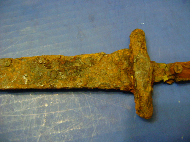

OK guys,
Having read tons of contradictory recommendations on the net, appealing for help to professional conservators in several university-based archeological museums ( standard answer: put it in a plastic bag with some dessicator, close the bag and never open it again) and even buying a book of practical pearls of wisdom by a renown restorer ( useless junk), I decided to take the problem into my own hands.
Alan, you should always listen to your parents: lime is removable with vinegar.
Recipe: buy a plastic bin with the bottom longer that the sword. Put the sword in and pour distilled vinegar 5% to cover it. Close the lid ( I did it in the laundry room and my wife refused to go in because of vinegary smell).
Keep it there for a couple of hours. Scour the sword with a nylon brush. Clean narrow spaces ( rivets, crossguard) with a medium tooth brush.
Having worked on it for 15 minutes, take it out, pour the vinegar into the sink, wash the sword and the bin with water several times.
Put the sword back, cover with water, add shitload of soda, let it sit for another 15 min ( scour missed areas meanwhile).
Wash again, dry . Finita la commedia!
Lime is gone, loose rust is gone. Now I can even see the remnants of the wooden handle, the tunkou and the terminal double-edged diamond-shaped segment of the blade. A classic Khazar!
Now the question: should I cover it with Renaissance Wax or with Rust Converter ( tannate + polymer) to make it look black like the Bauernwehr I showed earlier?

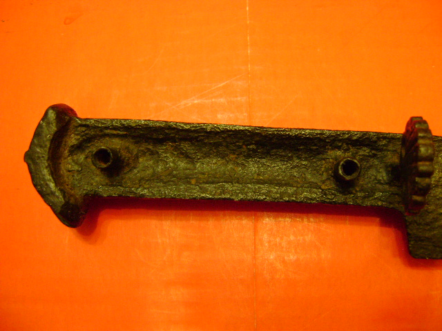

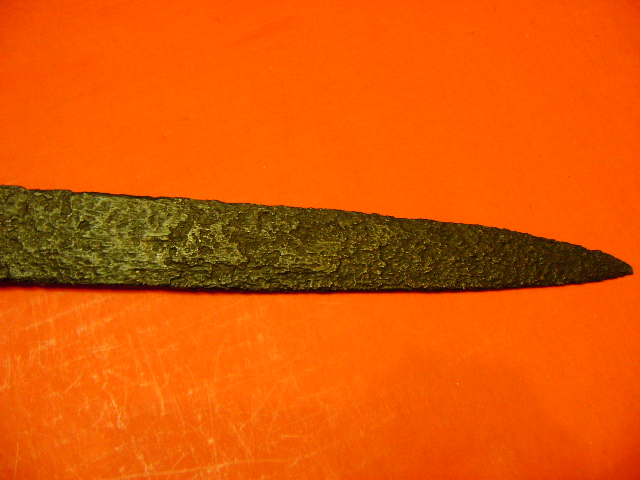

Old 27th December 2016, 02:12 AM   #20
As for vinegar, been using that stuff since I was little kid, like maybe 6 years old. True.It was one of my jobs as kid:- clean the saucepans.
I am glad you remembered the lessons of your youth:-) BTW, your remark was one of the highest inspirations for my attempt of "archeological conservation" . Many thanks!
So: what do you think of my final result?
Old 27th December 2016, 03:50 AM   #21
Posts: 7,229
Actually, if I look at the botom pic, it seems as if there is good solid metal under all that rust. If this is representative of the rest of the blade, I feel that I might be brave enough to do a little bit of mechanical cleaning by picking off pieces of rust flakes. Maybe you might be able to get it back to solid metal --- but don't blame if you finish up with a fragile web of holes.
If you took it very slowly by picking and brushing with vinegar and washing, you might finish up with something.
