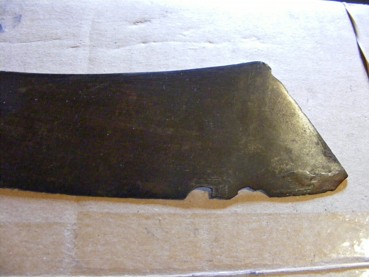

I should also mention the (yet again) extraordinary work Robert did in bringing this Parang back to life. It was in quite a sorry state when purchased, as usual Robert did an amazing job. Following are a couple of images prior to his efforts.

Great work from Robert as always, how he has repaired the nicks in the edge?

Originally Posted by Sajen
...how he has repaired the nicks in the edge?
That baffles me a bit as well.

The blade's edge was not ground down or the tip reprofiled. The nicks in the blade as well as the broken tip were welded back by the use of both mig and tig welding and the use of heatsink paste. As I have already promised Detlef a line drawing showing how this was accomplished if anyone else is interested I will also post the drawing here as well. Please remember this procedure it not one to be taken on by anyone who is not an accomplished welder in both methods that I have mentioned and can easily result in damaging the blade even more or its complete ruin if not done properly. Thank you all for your kind words in reference to my work.

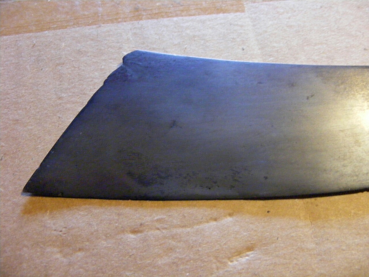

Default Close-ups
Before:
Old 4th November 2016, 12:16 AM   #11
russel
Join Date: Jul 2012
Location: Tasmania, Australia
Posts: 238
Default Close-ups
After:
Robert
WOW!
I am familiar with the procedures you described but I still couldn't fathom that you can achieve this level of precision. What you did is way beyond norm in the craft and, in my oppinion goes more in the field of art.
Thank you very much for sharing with us the secrets of your "magic"!!!
