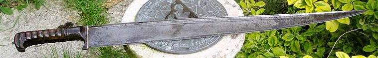

just won this at an online auction in norfolk, uk.
listed as: 19th Century North African Flyssa sword with scabbard a/f
i seriously doubt that. no dimensions, no significant bidders, i won it for less than the packing & postage. it appears to be a turkish (no integral bolster) style karakulak yataghan with silver fittings, now black. scabbard chape may be missing, leather need a bit of TLC near the throat. blade looks laminated, with a indented stamp on the left side. pommel may have some silver-work, as well as some worm holes. will know more when it arrives. i do know it's NOT a flyssa. (they sold another 'flyssa' a few lots before that looked suspiciously like a salawar yataghan (khyber knife) for not much more than i am paying)...
will list more info on arrival.

Old 25th September 2016, 01:58 AM   #6
There was no "Greece" till 1821. Just as there was no Serbia, and no "Bulgaria" till 1908 ( in 1878 they got an autonomous state).
Integral bolsters were specific for Bulgarian karakulaks and Zeibek Yataghans. The rest had thin hollow bolsters similar to Afghani khybers. There are very few minor decorative features attributing yataghans to specific localities: all silver nielloed , small-eared Cretan, smooth round corals from Foca, karabela-like handles from North Africa... Blades were made everywhere, but mainly in Anatolia and Bosnia and sold en masse. Very few are signed with Christian names or Gregorian dates.
Kronckew's question is superficiously simple ( it is a yataghan, not a flyssa), but older flyssa did have a yataghan-like appearance, suggesting their origin.
And I am not surprised that Brits called Khybers Salavar (mutilated Selaava) Yataghans: many of them do have recurved blades. This begs a question.....:-))))

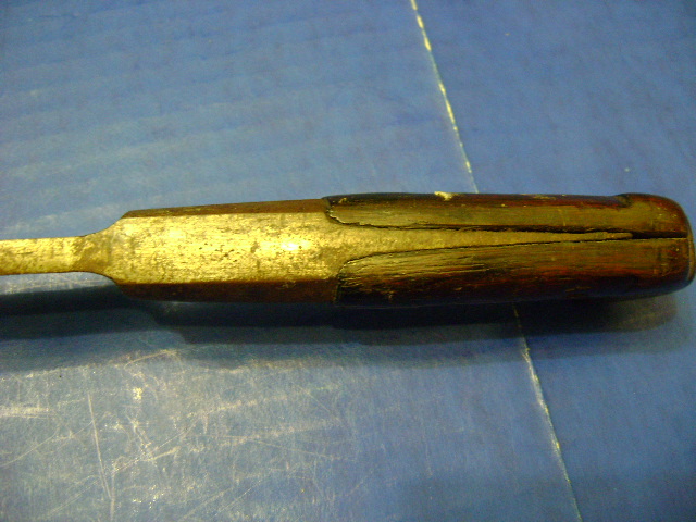

photo of my integral bolster karakulak yat/bulgarian shepherd's knife from a dealer in varna also attached for comparison.

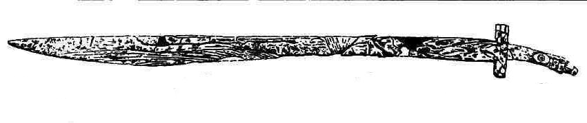

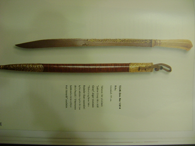

And if we are just at it, here are 2 Crimean sabers and a Quipchak knife of 12-14 centuries from archeological excavations by Ukrainian scientists. All predate Ottoman yataghans by at least 3 centuries.
Reminds you of something? :-)
And the last one is a yataghan of the last Crimean Khan , Shahin Giray bin Adil Giray, ( 18th century) faithfully following older Crimean examples shown here.
I do not have pics of the old Crimean bichaqs from 16-18 centuries, but their closeness to the neighbouring Bulgarian Karakulaks is remarkable.
The above archeological drawings are taken from a paper by Sergey Samgin and myself we recently published in the " Waffen - und Kostumkunde" 2016, Heft 1, pp.49-60, " A new hypothesis on the genesis of the Ottoman Yataghan: the Crimean connection" .

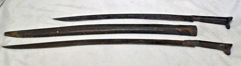

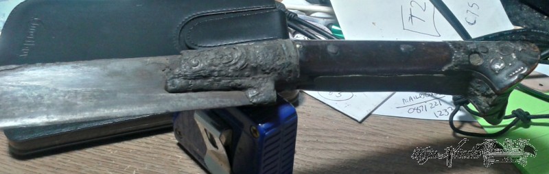

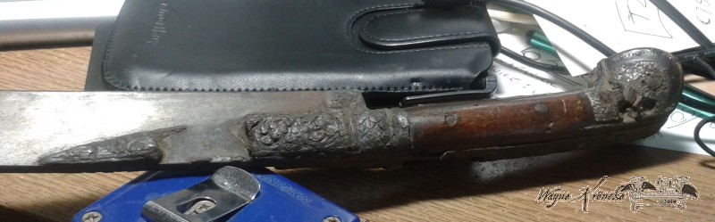

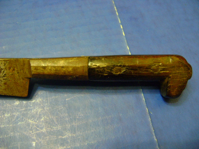

yat finally arrived!
485 grams ex. scabbard, 27 in. blade, roughly 1.25 in. wide, 0.25 in. thick near bolster. blade has a shallow fuller both sides, turkish ribbon pattern welded, no pitting at all, some patination of the steel. tarnished black silver/(or pewter(?) decorated bolster missing a few bits, as is the strap covering the tang/scales joint, one 'ear' is cracked and loose, the ears appear to have some shallow rounded holes that may once have held gemstones or coral. the ears also have remnants of silver pebbled decoration. grip appears slightly offset to the right but feels like that is deliberate, the scales curve to fit the offset. it fits the scabbard fine & with no wobble. the scales look like they are a dark brown wood, possibly they were once all covered by the silver?
scabbard shows some stitching loss near the mouth and near the tip, where a few inches of wood are exposed, wood is a bit split but essentially intact to the tip. mouth has a decorated metal covering, mostly black now..
overall, it all needs a good clean & oiling & a bit of TLC. last photo shows it with my shorter bulgarian karakulak. all in all, i'm happy with the under £50 it cost me.
some hd pics from my galaxy phone:

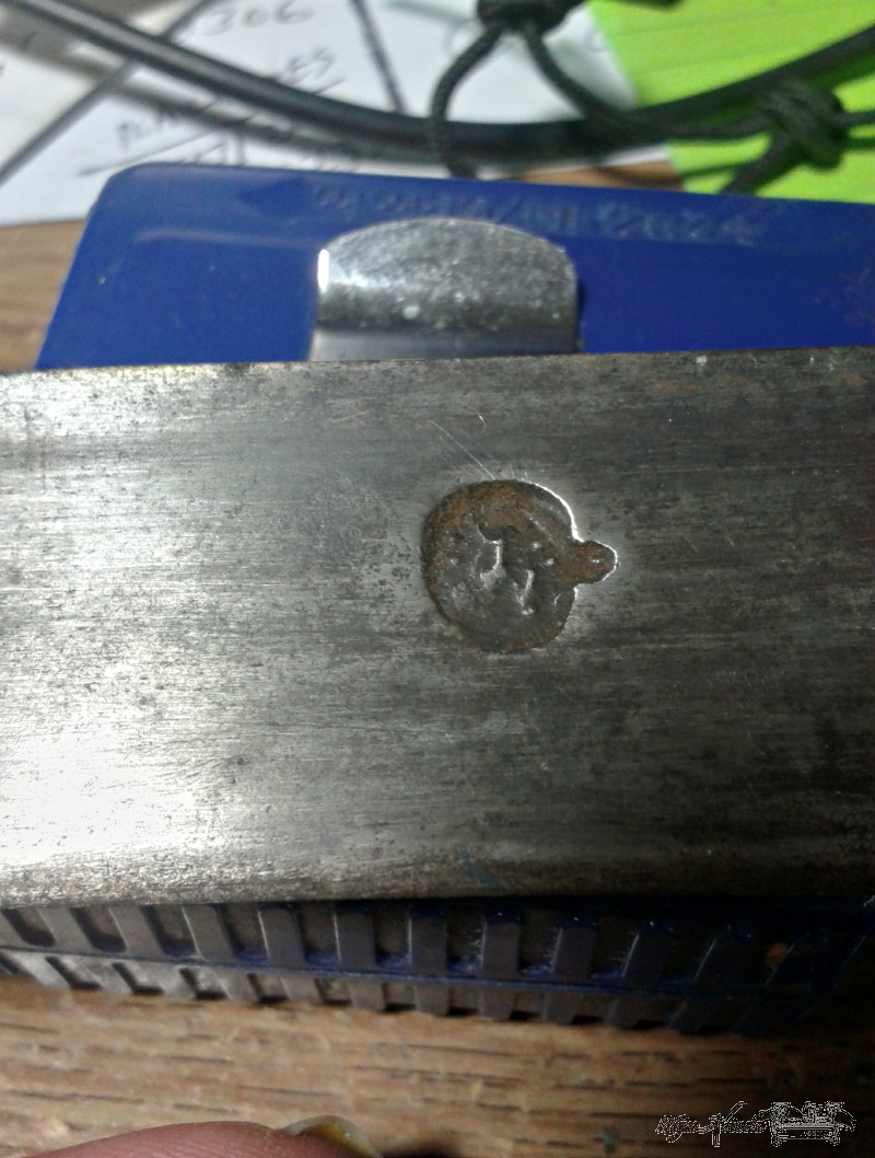

Please see http://www.vikingsword.com/vb/showthread.php?t=18469 for a possible link to the stamp...ALI...?
Below a Saint Irene stamp for comparison.
Old 18th October 2016, 01:09 PM   #22
archer burak
Location: İstanbul
Posts: 22
This ' kayı ' stamp , Ottoman sultans origin of Oğuz Türk klans , its use like a proofmark of weapons
