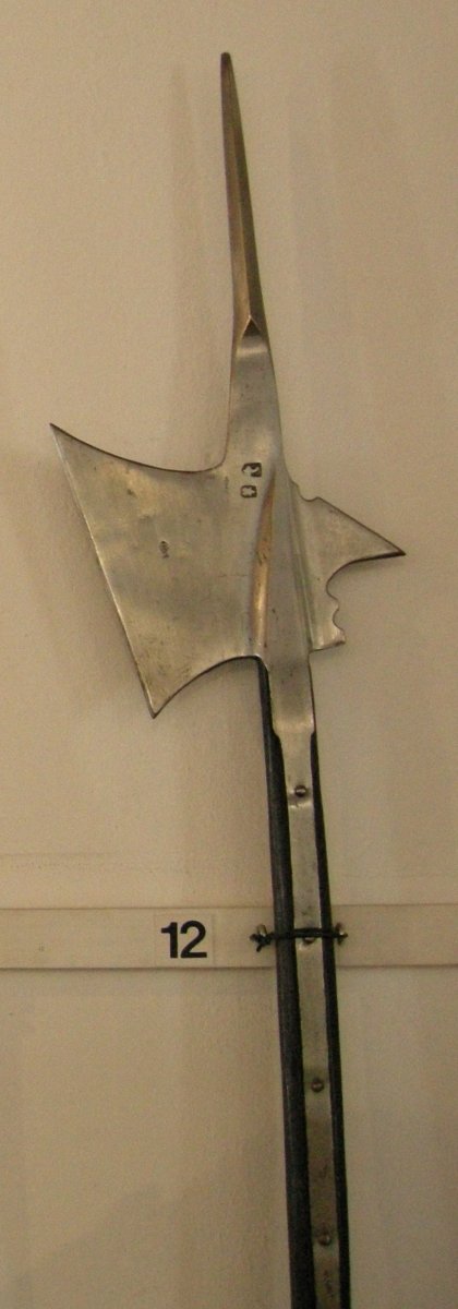

I took the liberty to enquire about the mark in your halberd to the Graz Museum in Styria and here is the answer i got from Daniela Assel, a scholar of that institution:
actually we do have a halberd in our collection which has the same mark. I am sorry but we cannot identify the halberd smith but most of our staff weapons were bought from Upper Austria in the second half of the 16th century.

In researching some Italian polearms, I found that a number of them of the 16th century , both halberds and falcons (guisarme) were marked with distinctive scorpion marks (many with +B on the scorpion body).
It seems that these were from Brescia, Lombardy, Venice and others, so singular arsenal provenance seems out .
What I thought was interesting was that in European context these polearms were in cases referred to as a 'scorpion'.
So here was an instance of weapon 'description' aligned with a unique type marking on their blades, which does not seem to apply to armoury, maker or guild.

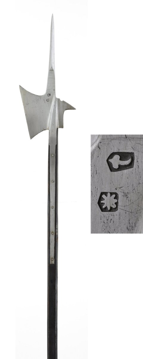

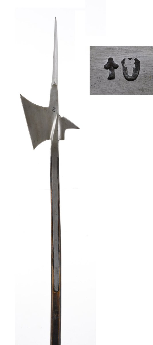

While searching the collection of the Swiss Museum, I found a couple halberds that might offer a hint along these lines. In a small number of cases two different marks appear, each individual mark appearing more commonly alone... One of the marks is a familiar star mark. The repeated marks each include a similarly shaped mark of a leaf or spade, though the mark is executed in two different ways... coincidence? One possibility could be that one mark is that of the smith, the other that of an arsenal...

That is very helpful, and I agree that these pairings may well be the result of such combinations. While makers seem to have recorded their marks with guilds, ironically it does not seem that guilds, arsenals and armouries left record of their markings.
The general motif of piercings in deliberate configurations, motif etc are also interesting as to what prompted their use on these polearms.
