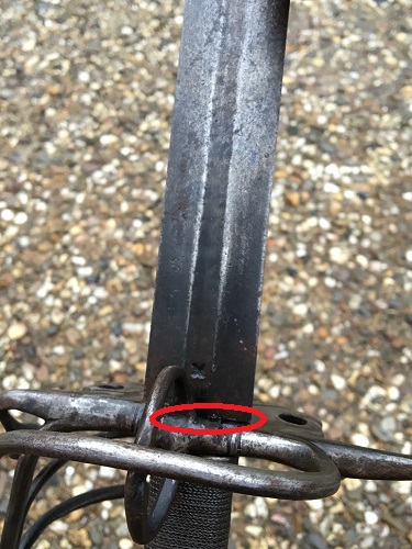

I could need some help with the identification of some pieces. This is an rapier/sword I recently bought. Its a sleeper. I hope someone can tell me more about it. I don't know if it is an authentic piece, I've got some doubts.

it seems a 19th century or 20th century reproduction to me.
reason for this opinion are; the welded construction of the thumb ring, the bands on the grip I/o Turkish heads and the absence of a short ricasso @ the beginning of the blade.. furthermore, it is quite "rough" ironwork and the patination looks artificial especially @ the thumring/ricassoblock of the guard.sometimes you see slots in the shell guard to hold/break the blade of the opponent, but round holes have no function here.
For me too. I think the side bows are too thin and the whole grip with its pommel might be therefore to be too light in relation the long and rather wide blade.

I agree with Jasper that the grip rings , grip and the guard is more recent, the pommel looks good and the blade looks like a 17th C blade that has been adapted to use on the composition of parts to build this sword. See picture 5 , red oval.
The sword is of the walloon type or felddegen, most of these have no ricasso it would be exceptional on a sword like this.
The grip rings are recent but on this type of sword a correct restoration or fake, some of them had rings and others mostly officers had Turkish knots.

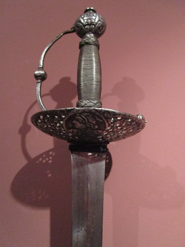

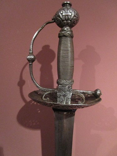

Here are some pictures of similar types , some with rings on the grip other with Turkish knots, none of these have a ricasso.
So In my opinion your sword is a composition of parts some old and some more recent.
