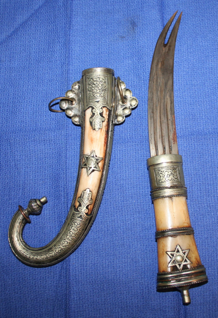

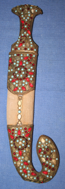

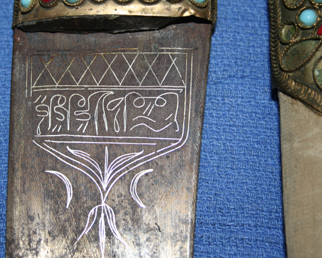

These two knives arrived in a group of mostly 70s era tourist crap from Yemen. There were a few keepers, but most of it is junk. The embossed backs on these two make me think they also belong in the junk pile. I would appreciate hearing what others think of them. Thanks!

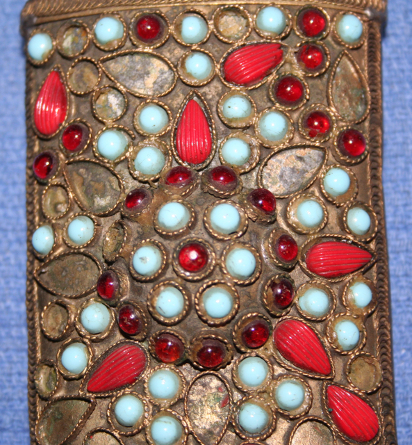

Harry,
These are considered to be Turkish knifes, but also were made in Egypt during late Ottoman period. The more elaborate sample can be seen HERE, yours fall in similar category. The blades on yours are sheet-metal and silver and brass overlaid, they're not real but decorative knifes, early to mid 20th Century. The smaller one looks to have corals, but likely plastic or paste, and glass and paste beads on top one. They're ethnographically authentic, hence do not belong to the junk pile!

Yes as Alex said all good. If you dont want them i will take them
The good ones have very nive repousse silver work on their back side.

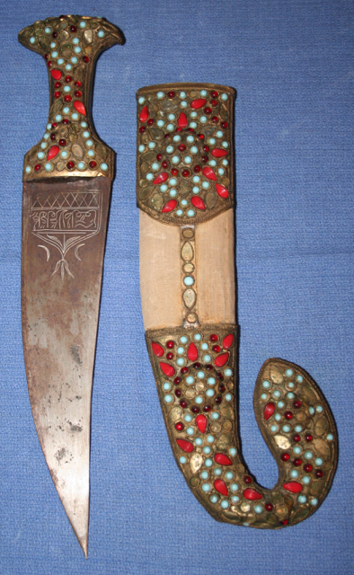

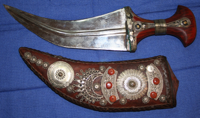

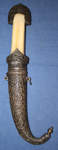

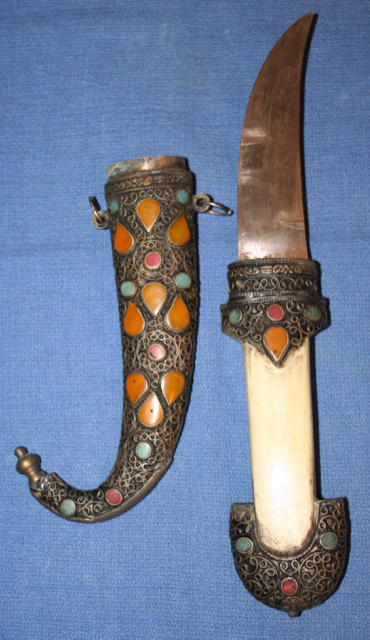

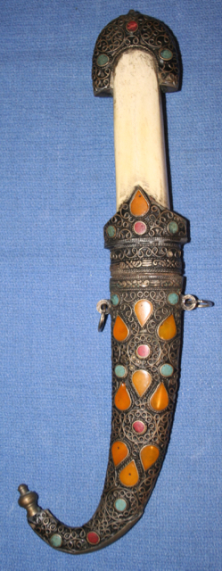

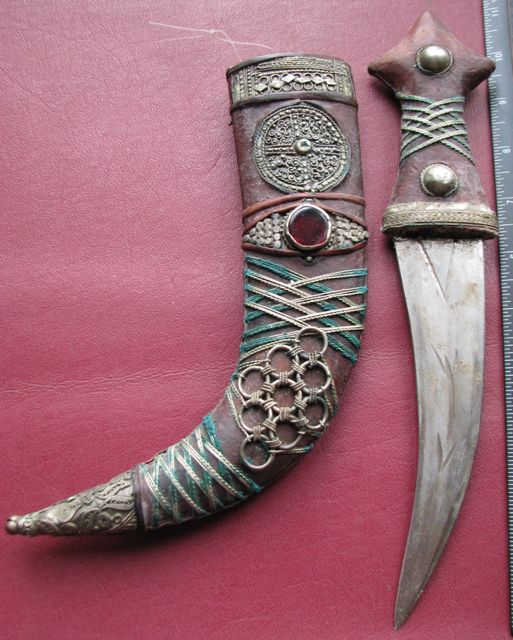

These two were also in the same lot. They have similar decoration but are better quality. The one with the canvas midsection on the sheath also has a flat blade like the two that started this post, but is made of better steel than sheet metal. Possibly still a tourist item, but nice. Has some heft to it, and it is big: 15.5". I would call this a real knife.
The one with the white hilt (bone, I think) is 14.5 inches and has a Koummya blade. I would call it exceptional. That it was in the same lot with the others was a surprise. Well made, solid knife, and not too hard on the eyes either.

Some of these stones are colored bone and others glass. These other pieces are from around Morocco and are sold to tourists.

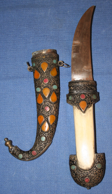

Looks like the entire lot was tourist crap. I am guessing these belong in the same pile? Thank!.

Well...........yes unfortunately. The only possible exception might be the red hilted one on the left, but only better pictures would help me and I would want other voices chime in on that one.

The Morrocan daggers are not very old, around 1930 maybe more late, I have a bad feeling about the Yemeni ones... The Turkish ones with the coral stones, even from early 20th c. are still very valuable..
