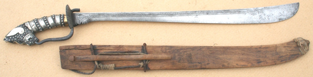

A friend recently picked up this sword on eBay, he thought it was North African. I tend to think it's from the East Indies.
What are your thoughts?

my first thought was mexican, espada ancha.
Old 30th May 2015, 05:32 PM   #3

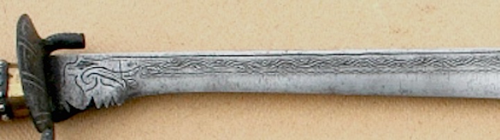

I, for some reason, am thinking of Borneo: kind of Parang Nabur-ish ricasso and blade incisions.
Old 31st May 2015, 01:50 AM   #4
Posts: 4,719
Looks Spanish colonial to me, especially the hilt.
Old 31st May 2015, 08:41 AM   #5
Posts: 4,285
that's what made me think it was an espada ancha (possibly not mex, that wasthe 1st that came to mind. )
the blade is also quite machete shaped

Nice sword. The hilt form reminds me of this one, on a sword I posted on the forum some time ago, also thought of as probably Colonial Spanish American.

Here is one of mine from the old UBB forum. It has a triangular blade and the inscription "Recuerdo Republicano." There are also floral designs at forte that seem similar to those on the first sword in this thread. My sword was thought to be from about the time of the first Philippine Republic in the early 1900s. The accompanying leather sheath is typically Filipino and would fit that period.
Ian.

I will give you my opinion. I'm not an expert of this kind of sword. As our colleagues said above, you have to see the Spanish colonial swords like another type that you can see in this thread:
http://www.vikingsword.com/vb/showth...berber+morocco
Philippines, Mexico, Cuba, Morocco, they were all under Spanish influence. I think that's a big mistake to try to put these swords only in one box.They were produced locally following more or less the Spanish models quoted previously. Yours looks North African to me.
Kubur
Old 31st May 2015, 07:41 PM   #10
Posts: 10,852
Thank you for bringing up that thread Ian, and as you well note, there is a great paucity of data on Spanish Colonial arms, and as keenly noted by Kubur, it is virtually impossible to regionally classify most. The "Spanish Main" was a vast trade and colonial network which survived into the 20th century, and the influences of these sword styles diffused into many of their trade entrepots.
I am inclined to think of this particular version as from the Filipino spectrum(as seen in another variation in your post #8).

Well, I'm surprised that we haven't found the consensus on this piece yet. Proves that some of the weapons are still not an open book for us.
I knew it had an East Asian feel to it, and was leaning towards the Philippines myself. The hilt may be generic, while the blade ricasso and the blade decorations could be the ticket to this piece's proper attribution, imho.

I wonder if, perhaps, the original sword in this discussion is an old variant of the Bicolano minasbad. See the following example of a minasbad for comparison. The hilt is obviously different but note the "saw tooth" file work at forte and vine decoration on the blade.
Ian.

This is exactly what I was referring to.

I think you have a consensus now, although not a very strong one, that this is a Spanish-influenced sword from one of its former colonies. Most likely it comes from the Philippines, and more specifically from Bicol in the southern region of Luzon. Unless there is someone out there who can say with greater conviction (and has an example to show) that the sword you posted is something else, then I think you have reached as much consensus as you are likely to find at the present time on this forum.
It seems safe to say that nobody here who is willing to comment has seen an identical sword before, and it may well be a one-off piece made for a specific individual. That said, the various comments above seem to have narrowed the likely sources of the sword's features (and therefore its probable origin) fairly accurately. Without an inscription, provenance or other documentation, that is about as good as it gets for a "unique," mixed culture weapon which this one seems to be.
Your friend is very fortunate to have found such an interesting sword.
