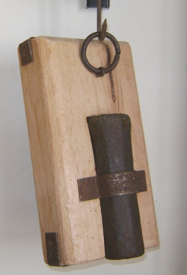

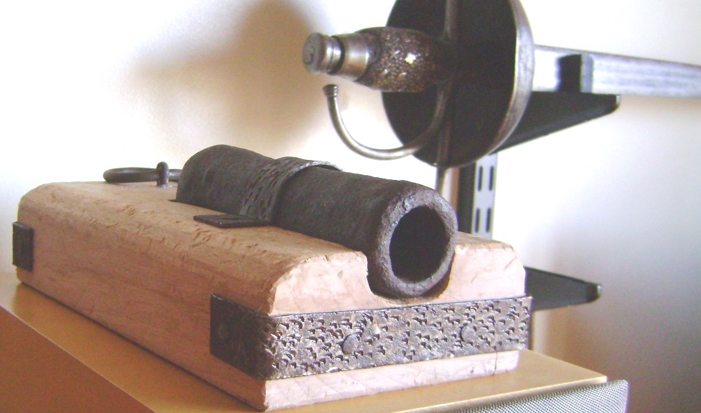

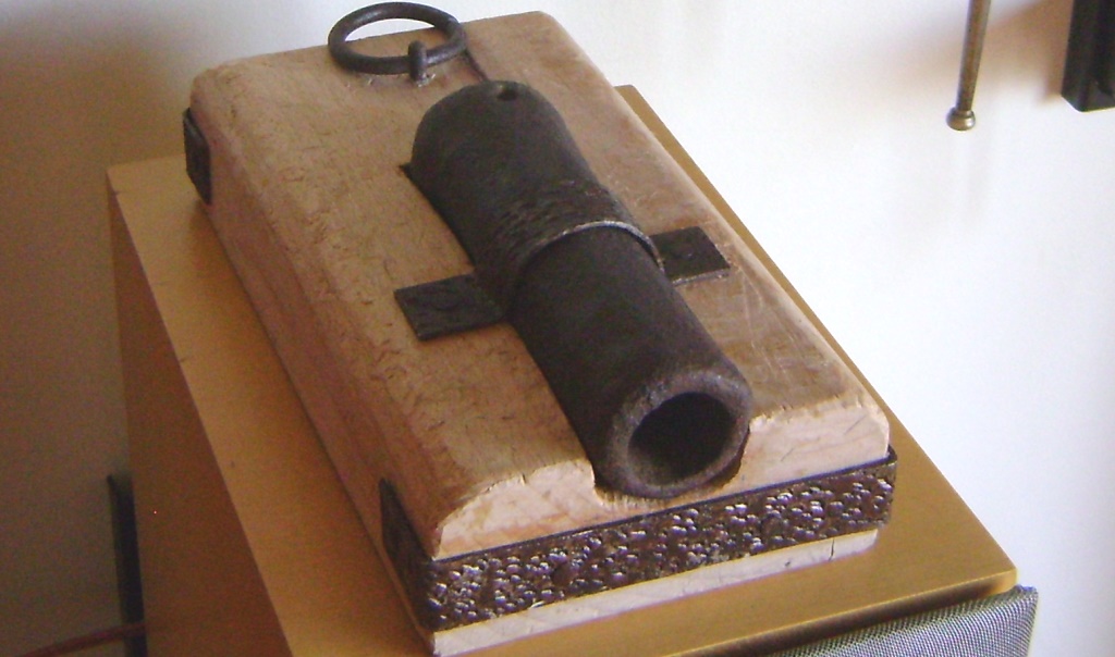

Giving wings to imagination ... or in other words, a conjugation of several cannon bed types seen around with a barrel that potentialy had a rather different stock .
