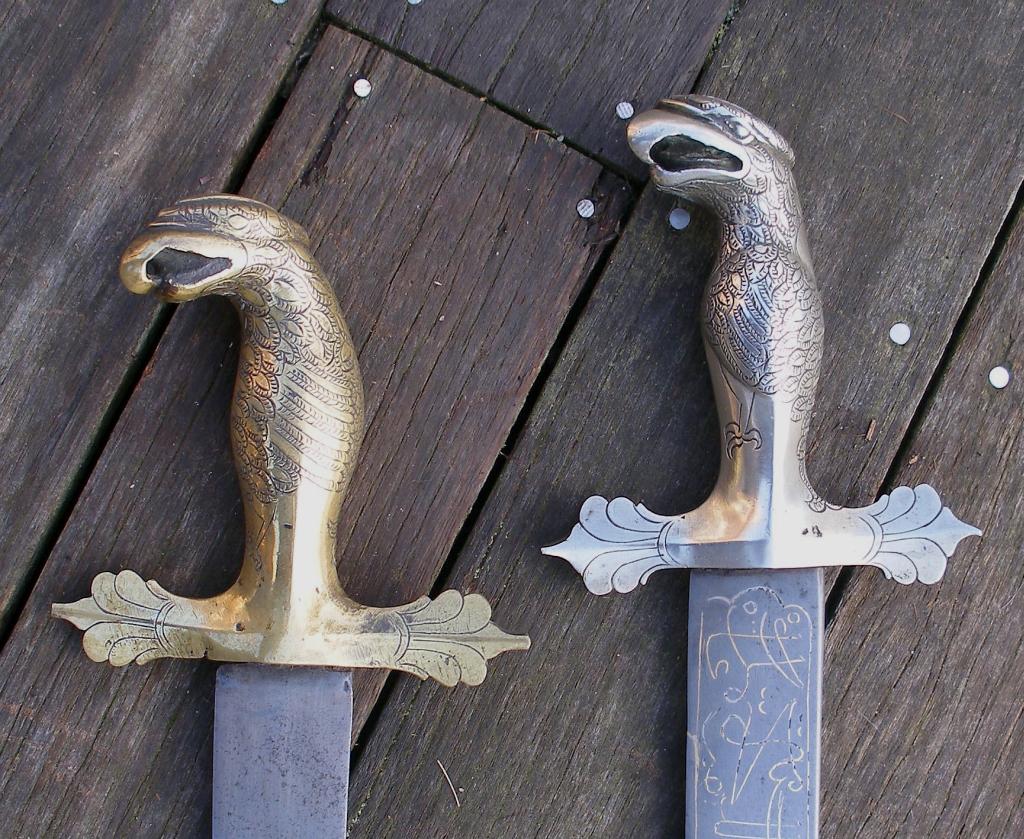

This is a piso podang, and quite a nice example of the rarer eagle hilt. I am especially intrigued by the script on the blade.
Though piso podangs are classically associated with the Battak, I would not necessarily attribute this one to them. Trade allowed these blades to be seen throughout the Indonesian archipelago and into the Malay peninsula.
These blade type seems to be especially popular on the eagle hilts. I would not be surprised to find a pattern welded blade, but would be surprised to find wootz on this particular type.

This looks like a good blade; not sure whether it will be wootz; but if it is anything like the blade on the example I already own it will be well tempered with a nice hardened working edge .
Charles, you definitely get around more than I do; this is only the third example of this sword that I have ever seen .
I'm very doubtful that the script is Arabic; it reminds me more of Batak
phonetic script .
Wherever it originated I'm glad to have won it .

I am betting this is what you will find, if not pattern welded. Please post when you have it and have had a chance to etch it.

I tried a vinegar etch on my present example; it didn't come up as pattern welded; it looked more like monosteel .
Still, that sword is a good 'cutter' .

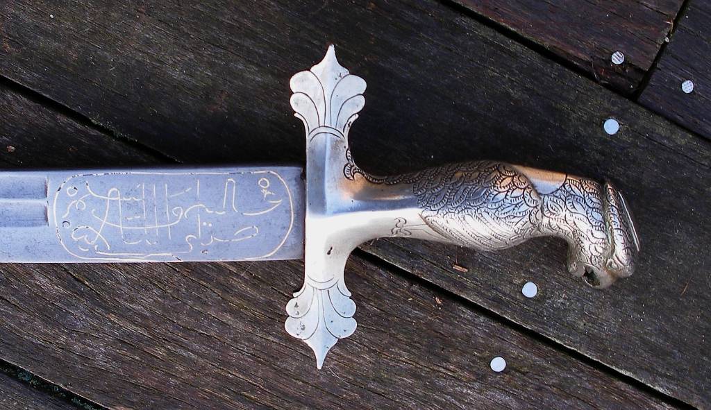

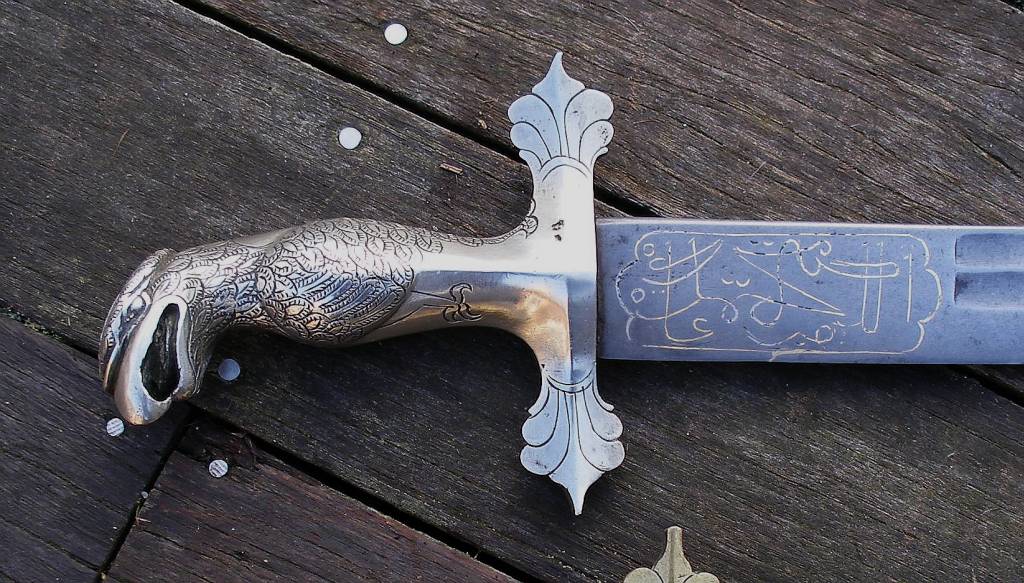

Cool Cartouches For Translation ?
Pictures of the cartouches .
Translation anyone ?
Interesting about these; when you look at them the work looks a bit sloppy what with the material running off the edge .
Well, it actually carries across the edge and links with the cartouche on the other side .
Any ideas anyone cares to float about this phenomenon ?
The blade is not wootz as far as I can tell; I hit it pretty good with ferric chloride diluted to 20% .
