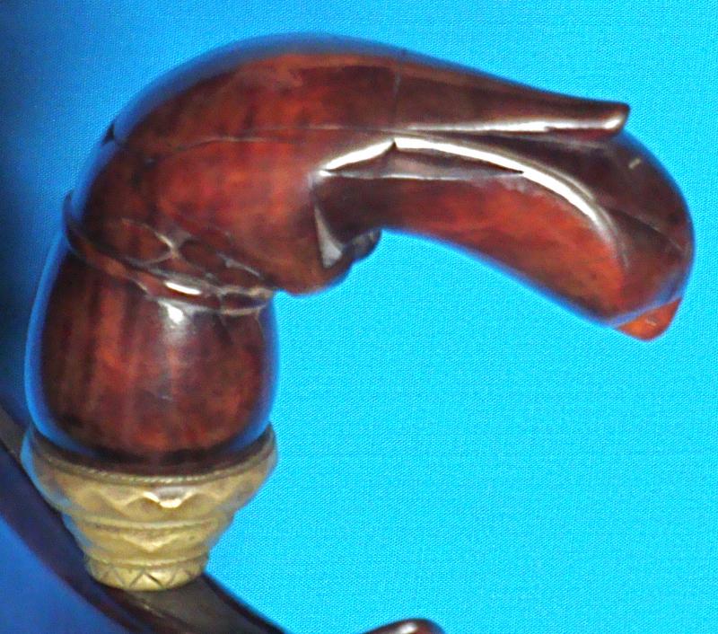

Here are pictures of the hilt, and an emblem on the back of the scabbard that sort of looks like the name "Allah" or perhaps a bismallah.
I will try to test the metal tomorrow and let you know my findings.
Old 13th November 2013, 07:29 AM   #4
Posts: 7,303
After seeing the hilt i am still inclined towards Sulawesi.

The hilt looks like a Minang styled form.
The 2nd pic is a calligraphy of "Allah" and "Muhammad", inter-weaved. The 'Muhammad' is a little stylized.

From the pictures the blade seems old but of common quality (indistinct pamor) and the nice pendok has a contemporary design. The hilt looks old and not Minang IMO but it has a specific design (mix Jawa Deman/ pengulu) probably from East Sumatra but other opinions are welcome.

my best guess that it is a Sumatra (Riau?) Bugis keris. I also think that the handle show Sumatra influence (Minang, Riau?). Sheath form isn't pure Sulawesi form. Pendok is maybe a more recent addition. Gilded "pendoks" could be simple a sign of wealth but it could be that it was added by a selling purpose.
