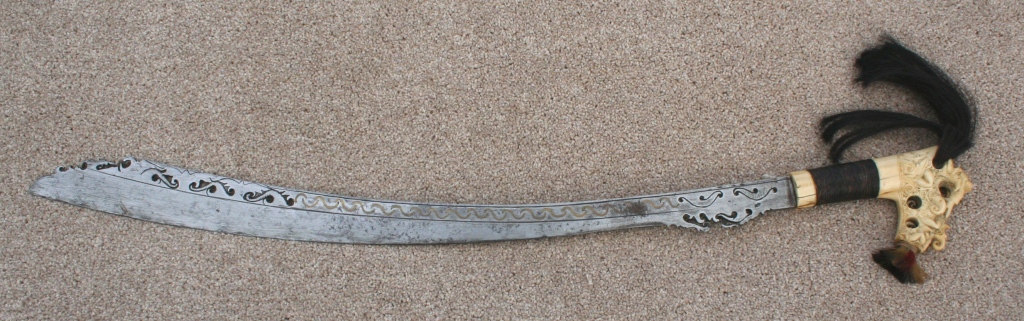

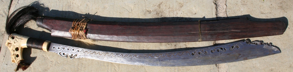

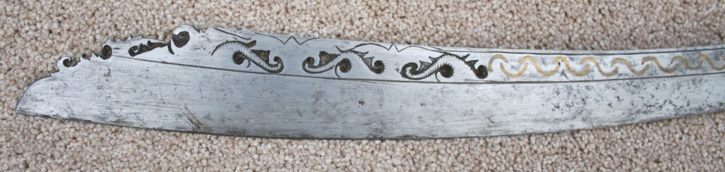

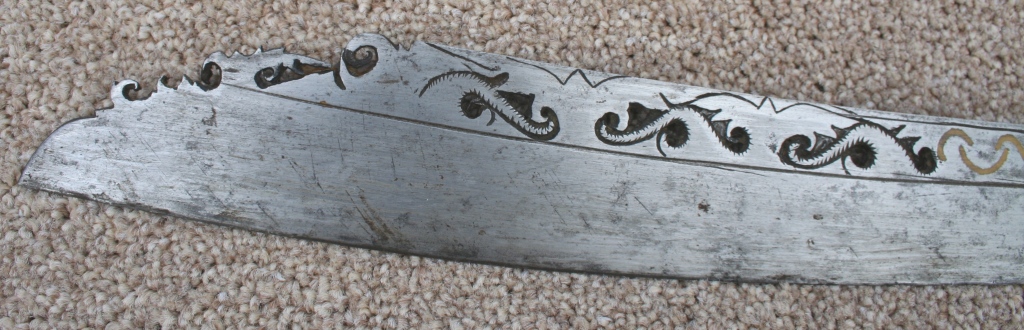

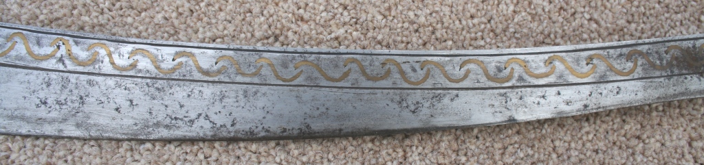

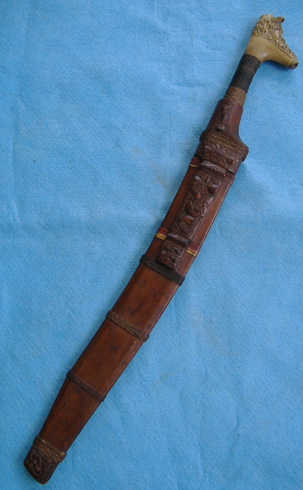

Were it 15 years ago I would simply have identified the sword pictured below as a Dyak mandau...on the assumption it's Dyak, so it must be a mandau.
Probably about 7 years ago I would have changed that assumption to rename it a jimpul...it is Dyak and curved, so it must be a jimpul.
I would have been wrong on both counts....
Over the last several years our Borneo specialists, most notably VVV, Maurice, MandauKudi, and Asomotif have proven to us that we can explore much more deeply the correct classification of Dyak weapons based on specific details and nuances.
Now I am trying to correctly identify the latest addition to my Dyak collection and I can best ascertain from Shelford/Banks that this is a tilang kamarau, and according the Shelford is a later addition to the Dyak arsenal(post 1902).
I am hoping the "Borneo gang" will chime in and tell me if I am correct or not and feel free to correct me if I am wrong and add anything, hopefully the likely location of its specific origin.

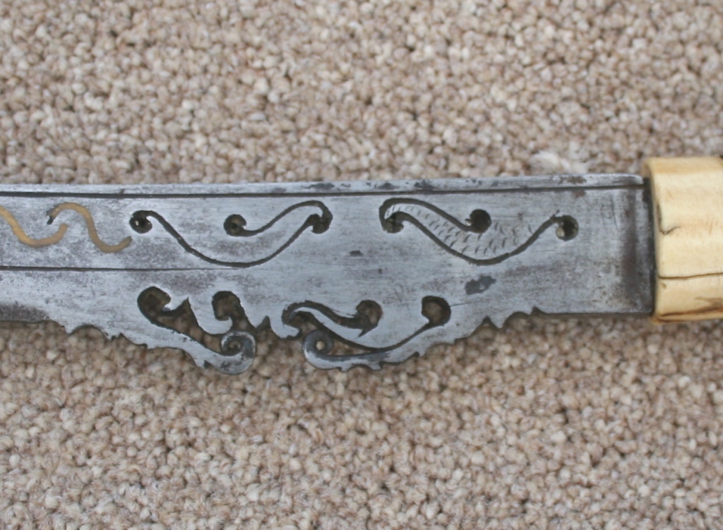

Yes Charles, you got it (a tilang kamarau, as described in Baltimore)
I would place it as from South Sarawak and the hilt might be later than the blade.
Maybe you should be a bit careful on using Shelford's date of 1902 as anything else than an indication on when he first saw a TK...
Michael

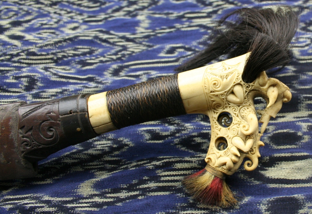

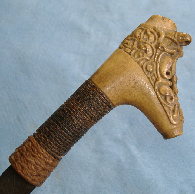

Thanks Michael! What features of the pierced hilt suggest that it is later than the blade?? It has a very nice patina.
Regarding the date, are you suggesting the type/style could be earlier, just unknown to him until then??
I just have the impression, based on the motifs and how deep they are carved, that this style of hilt is later.
It is always hard to judge age from pictures so I go more on the choice of motifs and the workmanship.
But if it has more patina than what it looks like on your pictures I might be wrong in this case.
On the date, I am a bit skeptic on Shelford stating a certain year without mentioning what he bases his statement on.
So if 1902 was the first year that Shelford saw them they might be a bit older.
But not as old as the parang niabur and even the langgai tinggang, of course.
Michael

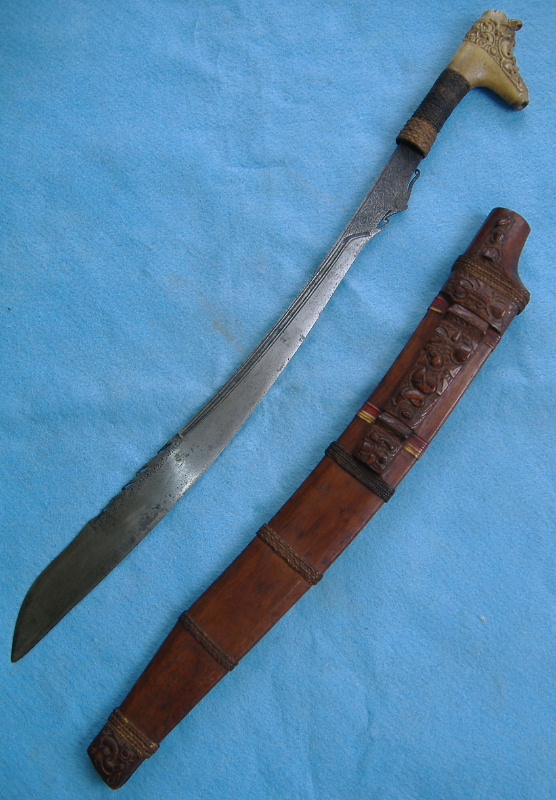

A Very Nice TK Charles!
I would classify this as a Tilang Kemarau also, based on Banks.
But if I was really an expert, I could tell you exactly the differences on all aspects between a "Tilang Kemarau" and a "Suai".
As I do have some ideas about it, I'm not sure about them!
But maybe nobody can tell the exact differences between those two, so we're only driven students of the few in the "top level"?
The blade looks very nice! I myself have the feeling that the blade is the oldest on the TK. It looks to me that the handle and the scabbard could be later and might be from the same date.
Michael described the hypothetis on the handle allready, which I agree upon.

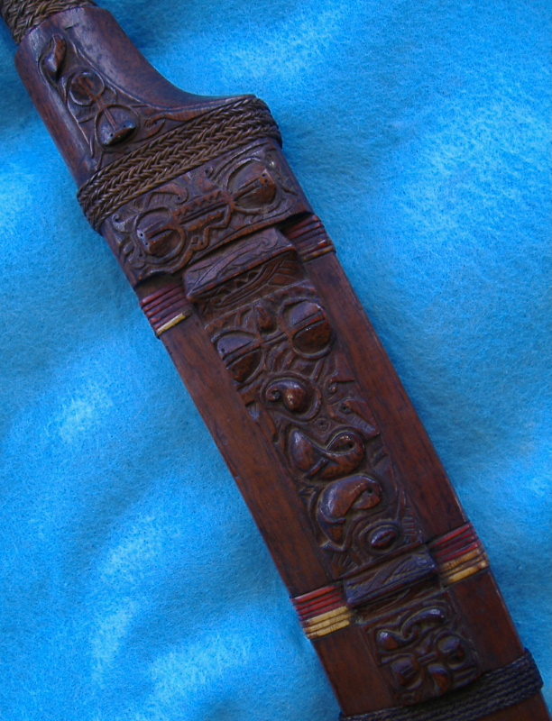

I think the scabbard looks too perfect, and this in combination with the patina made me have this assumption of being also later.
Could we have a close-up of the carvings on the scabbard?
Maurice

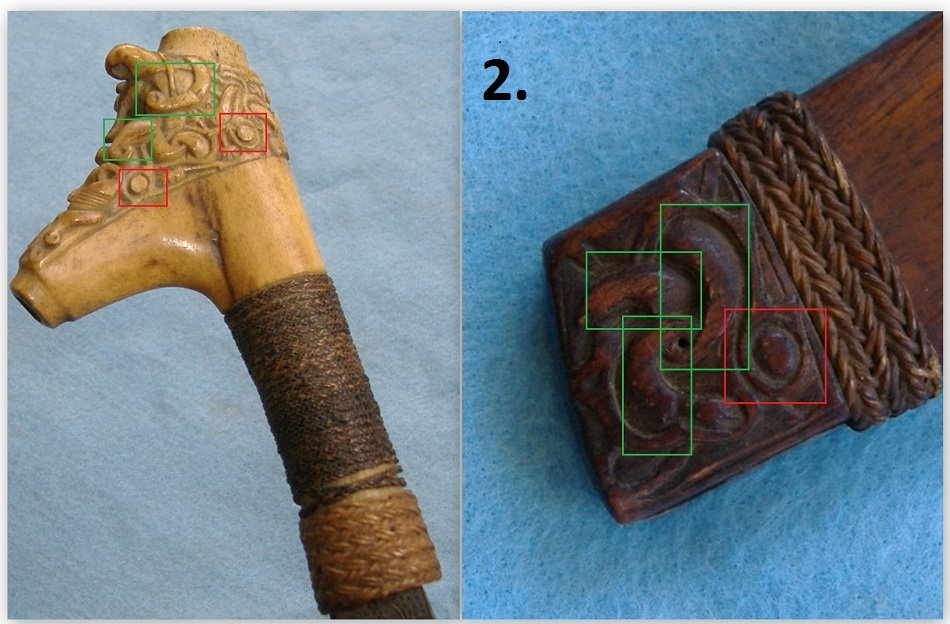

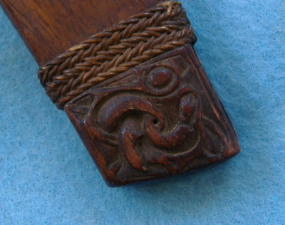

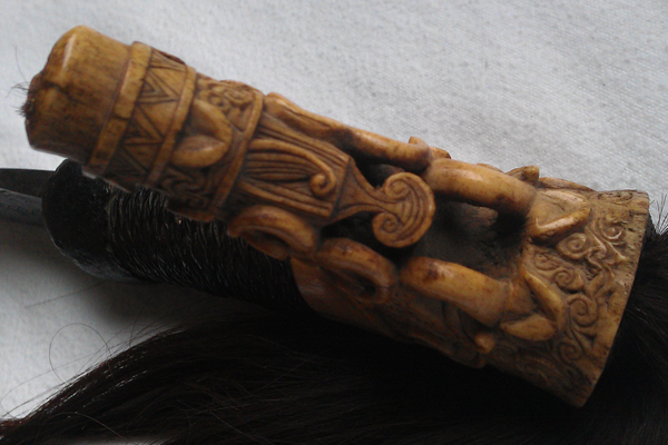

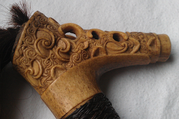

Maurice,
Here are some additional pics of the carving. Let us know what you learn from them.
Old 21st April 2013, 11:37 PM   #10
Maurice
Maurice's Avatar
Join Date: Jan 2007
Posts: 1,464
Maurice,

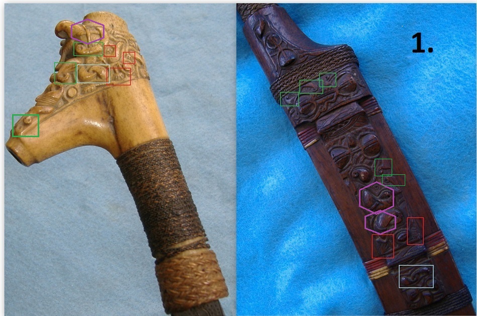

Thank you Charles for the close ups.
I have the feeling the handle and scabbard are from the same age.
There are a lot of similarities to be found, and they look like they belong together.
As the leeches and other motifs (circles etc.) are not uncommon on handles and scabbards of that area, the combination of some of them on the handle and on the scabbard are a good match.
For instance the little "impellers" (marked with a red square in image 1) on the handle we can also see in the scabbard.
And there are other marks which I also marked with different colours.
I hope you're not color-blind
Maurice

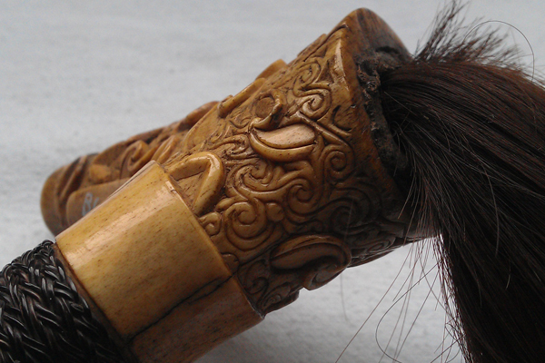

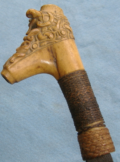

Smile Korambi?

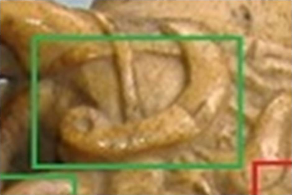

Interesting: this leech(?) looks very much like a korambi!!
Actually, I think it is a korambi.
I don't recall, I have ever seen it before on a Borneo swordhilt.
Albert is online now   Reply With Quote

Albert you have great eyes....that surely does look like a korambi!
Old 22nd April 2013, 12:10 PM   #13
VVV
VVV's Avatar
Location: Sweden
Posts: 1,637
Quite unusual, indeed.
However, if it is a korambi then it is an additional indicator of a later date of the hilt.
Michael
Old 22nd April 2013, 12:52 PM   #14
Maurice
Maurice's Avatar
Join Date: Jan 2007
Posts: 1,464
Yes Albert,
looks like a korambi indeed.
However I think it's a coincedence that it's looking like a korambi, as there are more like these leeches (kind of curls with this little hole) made as decoration for the handle.
And which you're pointing out is the only one that happens to look like a korambi...
Maurice

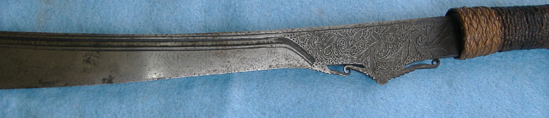

Like Charles, for the last few years I have been calling this a Jimpal.
Should I be calling it a T.K ?
I second Albert in requesting information on the Banks article.
I have been trawling through the web and can find plenty about Banks and the museum but not the 1935 issue.
Has anyone noticed that the latest edition of the Journal also has an article about swords ?
All comments welcome
Thanks
Roy

Roy,
Your T.K. is an interesting and unusual hybride of elements from Sarawak as well as Central Kalimantan.
Even if it is probably 20th it seems to be a one of a kind...
I have read the latest article, too, and it is mostly a discussion of Shelford's and Banks' articles.
Michael
