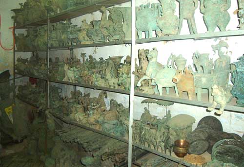

A PICTURE OF A TYPICAL CHINESE SHOP OF WHICH THERE ARE CERTIANLY THOUSANDS IN CHINA JUST ONE OF MANY SHELFS IN THE SHOP.
