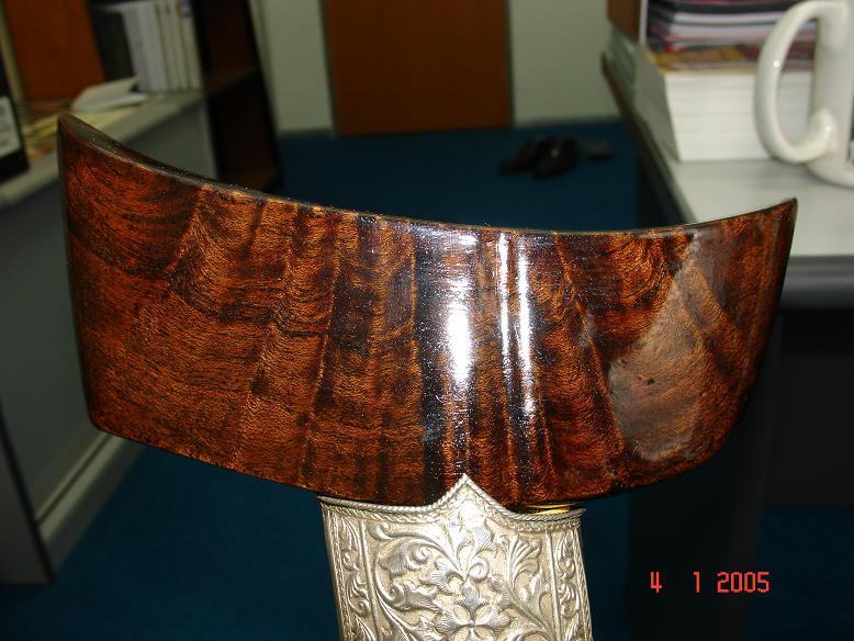

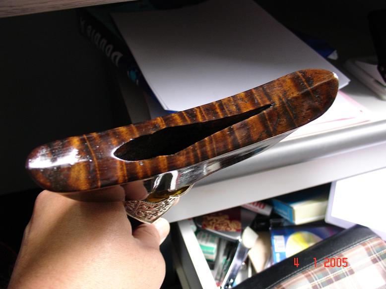

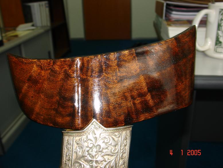

Hi guys,
As promised, heres the pictures of the sampir after restoration. Its still too shiny and i'm still trying to get the right sheen using french polish. Too tired to try again now...

I do hope that you apply french polish and other types of finishing with adequate ventilation! I have a friend that had to stop using that method because he had heart problems from it. Of course he probably did more than you do, because he is a musical instrument tech, but it'd good to be very safe with materials that vaporize.
By the way, the grain looks stunning! you did an excellent job. Remind me to ask you when I need that kind of work done!

Thanks guys. Actually i the wood itself has quite an impressive grain but is not enhanced before. Whoa, i dont know that this sort of thing can cause heart problems. Thanks for the advice Montino, and i will be happy to help anybody in restoration works. Thanks also to Dave for introducing french polish to me.

Make sure the drying area is dust free, I can see speckles of dust in the finish. It appears, just a little thick, hence the high shine, but for the first time at it great job. You can try smoothing out the finish/dulling it with #0000 steel wool.

That's a beautiful grain Rasdan. What made you paint it to begin with.

Thanks for the advice Fred. I'm thinking of redoing the thing all over again, but i've tried more than a couple of time during last weekend, perhaps maybe next week.
Actually, painting (laquer actually) it black is just my experiment to see how much that the colour of the wood could change after the laquer had been cleared. It appeares that it does absorb some laquer but the color change is not quite significant.
