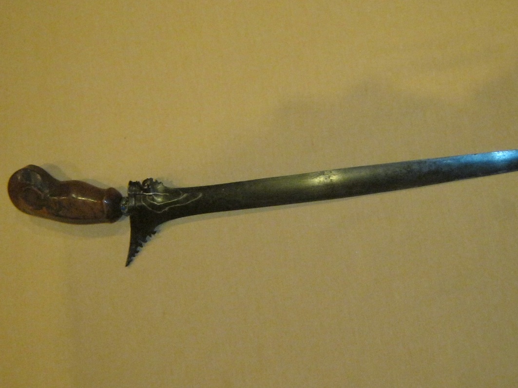

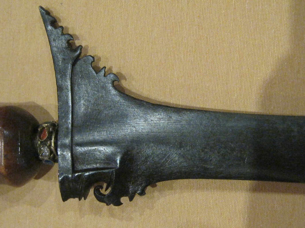

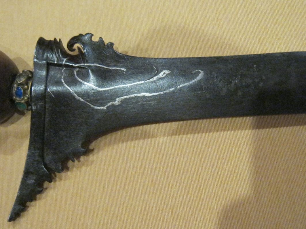

Dear members ,
This keris from Bali with a very smooth and black shining blade has a strange pamor on one side only .
Is that a mistake from the maker , is that a " fantasy " , or is that something we could classified ....
Thank you for your thoughts
Henri

Hello Henri,
Such a unsymmetrical pamor is called pamor tangkis, see examples on Google.

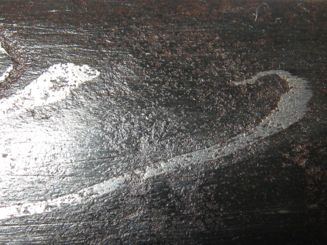

"The pamor motif looks to be superficial so it may have been made more recently than the blade itself."
It's funny that you say that - my eye is untrained and my knowledge fits on the head of a pin - but, when I first studied the pamor, that exact thought entered my mind. It just seem "off" to me.

Yes, Jean, I agree: The pamor looks very superficial -- almost like painted on ...

Frankly, i have seen at least as couple of Bali keris that people have painted "pamor" patterns onto that were that were actually half way decent keris, not the tourist crap where you'd expect that, probably because that thought they could sell it for more that way. So there is precedent for that. I also thought that the pattern here looked a bit superficial at first, but the photos alone just don't give me enough information to form a strong opinion either way.

David, I agree with you, although the picture is clear it is not possible to determine if the pamor motif is genuine or fake (applied or etched with acid) but if the case, it is more smartly made than usually. It also seems odd to do it on one side of the blade only but who knows?

From " fake " to " painted " or etch applied " .... when I take this keris on hand and look at this pamor very very closely I can assure the pamor is real but yes the nickel is not dep into the blade ( photos below ) . This keris was part of a lot of 10 I bought sometimes ago to a collector in the UK who passed away and pretty sure he has not bought this one in a tourist shop during a visit in Bali ! But .... never never know !

According to my understanding this is not pamor tangkis.
Pamor tangkis is a different pamor on each blade face.
This keris has a small seemingly accidental patch of pamor on one blade face only, the other blade face has no pamor.
This cannot be classified as pamor tangkis.
