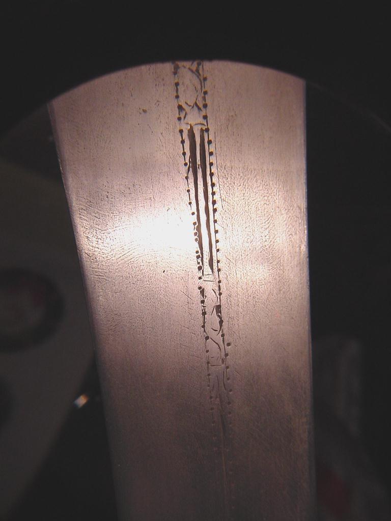

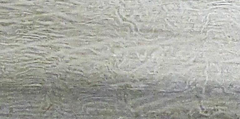

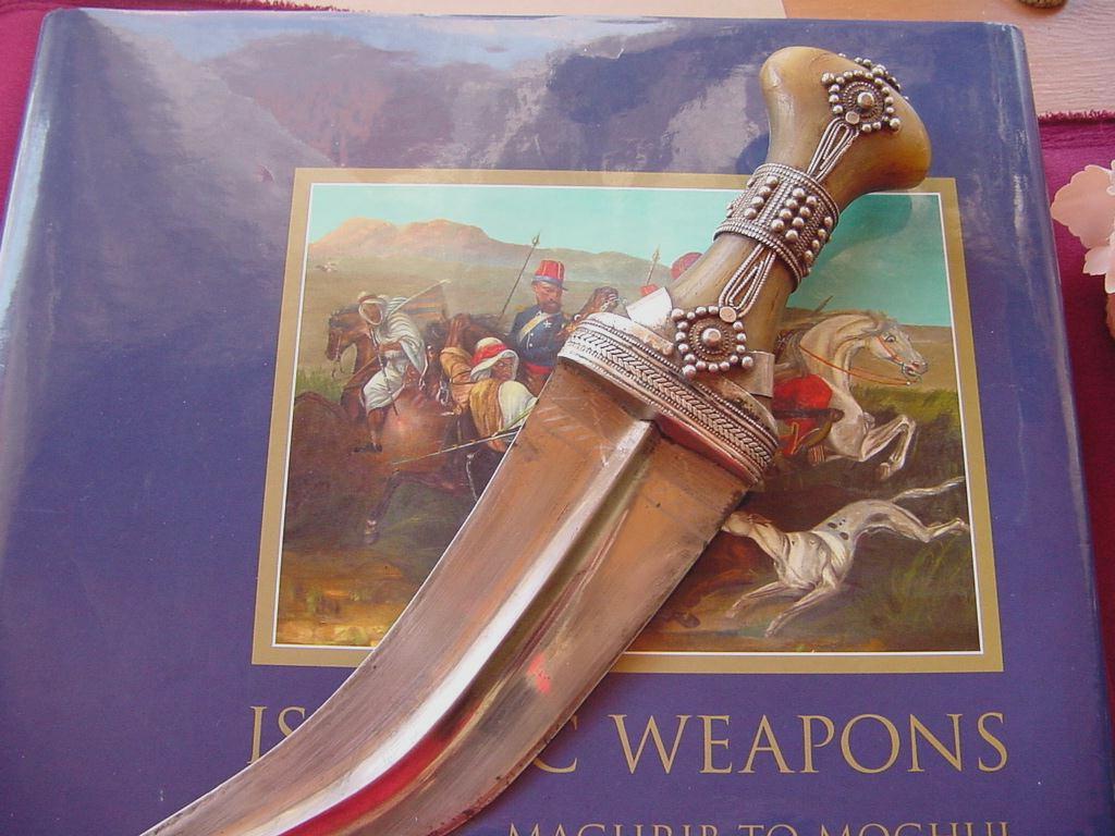

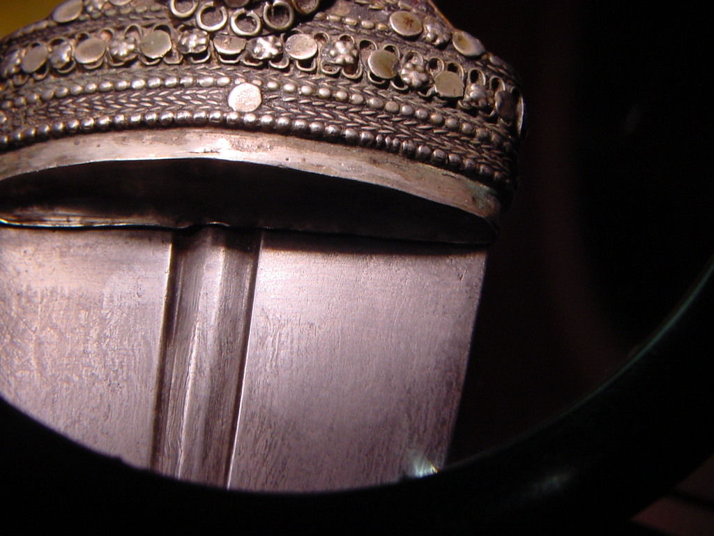

Awhile back I posted this Jambiya and used the sellers photos, opinion was it is Shear Steel. I found information about this type of steel but photos seemed scarce.
I've included some better photos of the blade and I'm very curious to hear your opinions. Photos from M. M. Khorasanis Arms and Armor from Iran, show Persian Sham and Striped Sham. This blade starts out grainy the gradually goes linear, maybe due to scarfed billets?
Very recently I found that there was an exceptionally nice Jambiya, that has a Persian wootz blade http://www.antigaarabia.co​m/uploads/102-103.pdf
Well this got my interest going again. I must be overrating my blade or as has been asked before. Are there others lurking that have been overlooked??
So, please lets your opinions. Thank you in advance, Steve
The previous post:
http://www.vikingsword.com/vb/showth...t=Wootz+Wahabi

Steve,
You bring a good topic. Visually, it does look like sham, and the opinions will vary. My personal opinion is toward layered or shear steel. Sham is one of the wootz patterns, and based on complexity and type, I'd not attribute this particular pattern to wootz. Some references above are M. Khorasani's opinions, and leave some room for discussion...

What I find funny is that the pattern fades towards the end near where the blade meets the hilt and there is a defined edge which could be some type of faux etch ? Could be shear steel or blister steel or even some type of local carbonized wrought iron?

Default Eye opening feedback Thanks
Ric, Your input is always valued your hands on experience in making and forging shear and crucible steels gives first hand expertise. Your comment that this is something else, has impact. Does the apparent pattern loss Lew mentions give us a clue?
Alex, Your wootz opinions have always been of interest. This could be Mechanically produced. I've included a couple of photos where I thought to
be the result of scarfing. the thicker pattern at the hilt may be the result of
extra forging required in shaping the hilt vs. the finer lines toward the blade
tip. I'm guessing that this pattern was visible even unetched.
Lew, Your point about the disappearance of the pattern in the hilt area may
well be a clue to how the blade was made. Most etched Jambiyas show a V
of some sort where they were quenched in tempering. I've included odd lines
on My other Wahabite Jambiya and a photo of one with typical V but the pattern etched again towards the hilt???
AJ, Your correct Sham is a lesser quality Crucible steel and no doubt the root for the English word " sham". Sham Shir always gives Me pause. Are you serving in Afghanistan now?
Thank you all for your interest and great input.

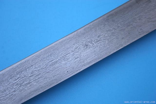

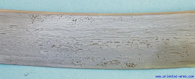

Default A few Sham Photos

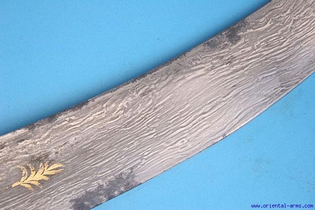

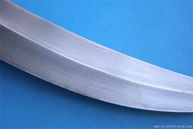

Shots from Oriental Arms Search for Sham and Low contrast Sham. added a couple Damascus as well. To help us decide with visual aid.

Archer that "V" is a matter of cooling the steel in the quench..notice on the first the edges are darker photos 1 and 4 and the "V" points to the tip...as the blade is quenched it cools faster on the thin edges and then the center...so when dipped in, held and then removed the center will still be hot...which make the "V" pattern.
photo 5 shows the "V" pointing the other way..which is really not possible on the typical quench.
The photos from Oriental Arms appears to me to be a different material source than what crucible steel forms..far closer to well forged shear steel or bloomery steels with levels of phosphorous. It is in fact possible to get a surface pattern when you have no carbon in the iron at all...though I believe all those pictured are in fact some form of steel...I can not say with any authority what that steel is.
I'd like to chemically analyze some of that material.....I am at a point now where I have seen many things and some of my opinions have changed even since last year...I'm trying to be opinionated for all the right reasons and not because I simply have not seen something before. To say something "IS" something is a bold statement...and knowing the chemistry or how it looks under a microscope is one more page to the book so to speak.
In fact I am gathering samples of various ethnic blades for that reason...to create a sample body.
Whatever it is it obviously was a traditional material...I am not saying any of these are not old...just arguably not crucible steel. I would throw none of then out of my collection should they one day join.
Ric

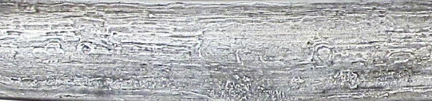

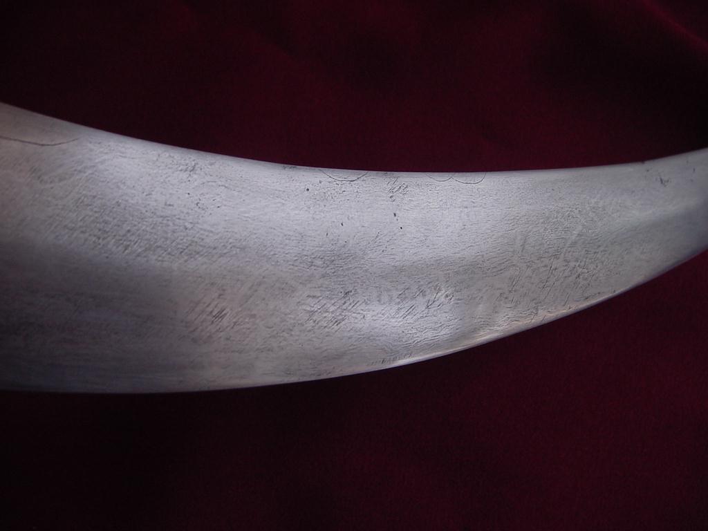

Ric, I'll re etch the top blade in the fifth photo, it maybe a burnished area?? Note the one in photo 4 has the V in both directions too. The Balkan jambia has the same markings on both sides. Is is possible after annealing the tang hilt end was tempered for strength /rigidity.
I think you are on target with the not likely crucible steel and only testing would tell. I'm not
convinced it is Shear steel leaving that open. It's most likely Mechanically produced given the
thicker finer graduations going down the blade. I'm more certain now that what we see is in
the steel. The smoother area at the hilt faintly has grain (pattern) continuing back. So pattern is likely real and suppressed by burnishing.
The other blade Dharia Jambiya likely from the same previous owner is even crazier. Here is a picture after some prep. Shot under a lighted magnifier. A pattern continues back into the polished area I appreciate the help from all of you Steve
