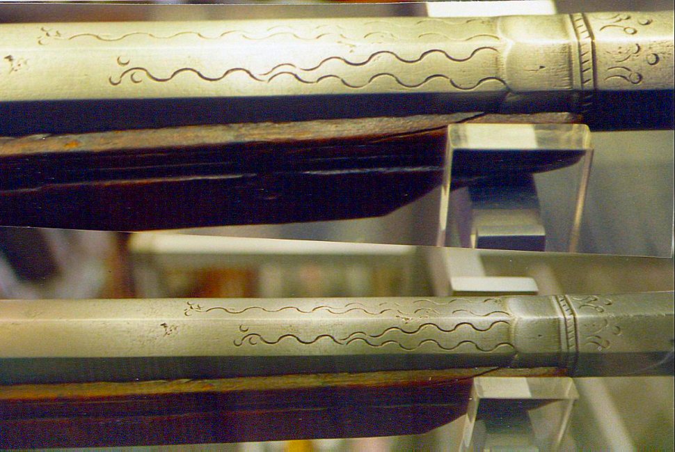

Flame ornaments on the barrel of a Nuremberg Landsknecht arquebus, dated 1539, preserved in the Germanic National Museum Nuremberg.
m

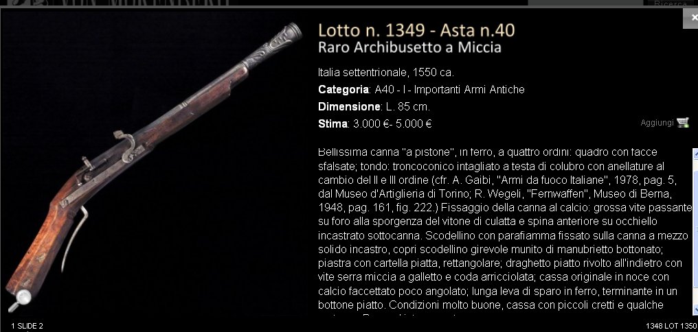

Posts: 4,310
North Italian (Brescia) matchlock arquebus with zoomorphic monster-mouthed muzzle section, ca. 1540.
m

Michael, thanks again for posting interesting photos. On the
Nuremberg Landsknecht arquebus, dated 1539,...
is the entire lock a replacement or only the screws?
One other question, since you mention the flames, have you found any small arms with rings of flames similar in shape/proportion and arrangement to those on the Mulich cannons?
cannonmn is offline   Reply With Quote
Old 24th December 2011, 04:21 PM   #12
Matchlock
Matchlock's Avatar
Join Date: Sep 2008
Posts: 4,310
John, the lock is original, only the screws are modern replacements.
Please see another, almost identical arquebus with the same date and marks but without the flame decoration in my collection, and retaining all its original screws and long tiller trigger (the latter broken off on the sample in Nuremberg):
http://www.vikingsword.com/vb/showth...1539+nuremberg
I cannot remember ever seeing those rings of flames on small arquebus barrels.
