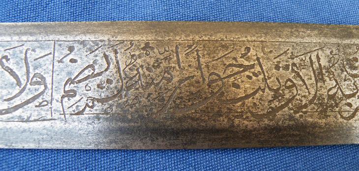

Default Sudanese kaskara - Arabic translation request
Hi
Could someone kindly assist in translating the Arabic on this kaskara. Its on both sides of the blade, but proved tricky to photograph. Hope it can be made out OK. I've added a couple of detail shots for those forumites who like kaskaras.
Thanks in advance....

Hey Colin,
I'll try to decipher this later tonight or tommorow, but the pictures could be better.
Just a random observation, but the script is not the usual found in Sudanese item.. I think this blade is pretty old.
Hi Colin
unfortunately, the text written with the aphabet Arabic, should be in Sudanese dialect
unreadable, for an Arabic speaker of Arabic classic language,
you must found a Sudanese able to read his dialectal language
despite this, it has been determined, that it was a poem,
the translation is roughly impossible excepted some words related to religious invocations, as well as
"Rasul Allah" either "God's Prophet" ... "Allah" either "God"
absolutely sorry
any way, I think my "Brother Lotfi", has not been more fortunate in his attempt of translation

Hello guys,
Sorry its taking me a while to translate this. I am busy with my mid terms so studying and other stuff are taking my time. Promise to translate what I can once am free :-)
Old 17th November 2011, 09:10 AM   #16
A.alnakkas
A.alnakkas's Avatar
Join Date: Nov 2010
Location: Kuwait
Posts: 1,340
I think its a poem by doing a superficial reading.
It also contains a reference to Imam Ali (La fata ella Ali Alkaraar, wa la saif ela thul Fiqar.) The interesting part about this reference is that it contains Alkaraar, which is a title to Imam Ali that means: the Slayer. I never seen it on a blade :-)
Edit: interesting find is that the Imam Ali reference has a grammatical mistake, replacing La with Ma (Ma fata ella Ali.. wa ma saif ela thul fiqar).. its strange how the scribe will make such a mistake while writing a poem.. hmm

Hey guys,
So I finished mid terms, think I did alright :-)
I managed to read the poem and understand the words, but this poem is using a very good classical arabic, I wont try to translate it emmediately as I may get the meaning completely wrong. For now, I am trying to find the poem on the internet to try to understand it more.

Ok, I'll write those in Arabic for now:
First 3 pictures:
من ماشا(مشى) الدهر ضيما و أسجرت (ف أسحرت) به ألاونات (الاونلت؟) جوار منه لم يضم
man masha (or could be msha) Aldahr dhayman wa Asjarat (could be fa As"harat) behe alawenat (could be alawnalat but that makes no sense to me) Jewar menh lam yadhum.
In english, it would be something like this : Who accompanies eternity in sadness (It could also be Who walks the path of eternity in sadness) and is set ablaze (or it could be mesmerised) by late occurances - what is near him (this could be wrong) wont ever be oppressed/saddened.
Old 29th November 2011, 12:20 PM   #25
A.alnakkas
A.alnakkas's Avatar
Join Date: Nov 2010
Location: Kuwait
Posts: 1,340
I need a clearer 4th picture but here are the rest:
5th:
إستلمت الندا من خير مستلم
Estalamat alnada min khair mustalimu
And you will recieve the call (or it could be: And you recieved the dew/call) from the best of recievers (this part is classical arabic at work, the meaning is not clear so do not take this as a true translation)
ما فتى إلا علي و ما سيف إلا ذو الفقار
Ma fata ella Ali wa la saif ella Dhul Fiqar (the sentence is grammatically incorrect unles someone can prove it to be correct
No warrior except Ali and no sword except Dhul Fiqar.
6th/7th picture:
وقاية الله عنت عن عفة مضامن الدروع وعن عال خمن الأرطم (؟) سنة 1245
Weqayah Allah anat an efat madhamen alDuru' wa an 'al mn Alartam sannah (written vertically) 1245
This sentence seems to be non-arabic or accented or uses words that are uncommon. It seems to be an evocation to protect the wearer of the armor (no idea why armor and not weapon) and it contains a date of 1245 hijri ;-)
8th and 9th pictures are unclear. Please post clearer ones.
Also, do not take this as a "translation" as I could have missed the meaning of these poems.
