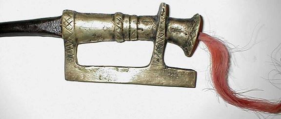

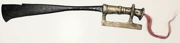

Naga weapons they are just great are they not? I had a long bladed version as well but being at times a very silly man I lost it in a swap One of you out there has that Naga weapon with a small blade on the knuckle bow, we saw it once, to see it again would be rather nice. I have never seen any of the decorated ones with a scabbard, only the more plain ones. Has anyone got one with a scabbard Tim

Nice Naga axe! Here are two from my humble collection. Funny most of the stuff I have read about these things is that they are more tool than weapon?

This is the weapon, I know you are out there, if i remember correctly yours does not have the hair though the glimpse of it was some years ago. Tim

Those are nice daos.
Many of the Naga daos did not have a scabbard or sheath-type holder, but rather a wooden "block" suspended from the small of the back with a slot cut through one way for suspension from a belt and another cut perpendicular for the blade to go through (with the wider handle preventing the whole dao from slipping downward through the hole). There are plenty of historic photos depicting them.
The brass-hilted dao with the unusually shaped blade is from the Shendu people, as is the Ashoka Arts example (an item that I was considering purchasing, incidentally).
And Lew's upper dao is more characteristic of the Kachins and nearby peoples. I have yet to see a photo of a Naga carrying such a weapon. I would be very appreciative if someone could uncover such photo documentation. Sometimes the Naga dao blades approach the proportions of the Kachin daos (and so, in some photos, only the blade being exposed, one might jump to such a conclusion), but the handles are different in proportion, shape and decoration if not materials.

Oh, and they were both tools and weapons. The Nagas were headhunters as well as agriculturalists and "gatherers."
I rather like and agree with Tim referring to these as "axes," because in form and function they are closer to an axe, in my opinion, than to a sword, which is implied by the term "dao."

Thanks for the replies gentlemen, I should have made it more clear about the block type holder though a type of scabbard was also used, I shall post pictures to illustrate latter. If I could of robbed a bank that weapon from 'Ashoka' would have been a very nice thing to have. They Know who they are, stop holding out and show us the weapon. The weapon seen briefly on the forum some years ago was of the first picture I post not the version of 'Ashoka' very kindly brought to our attention. Tim
