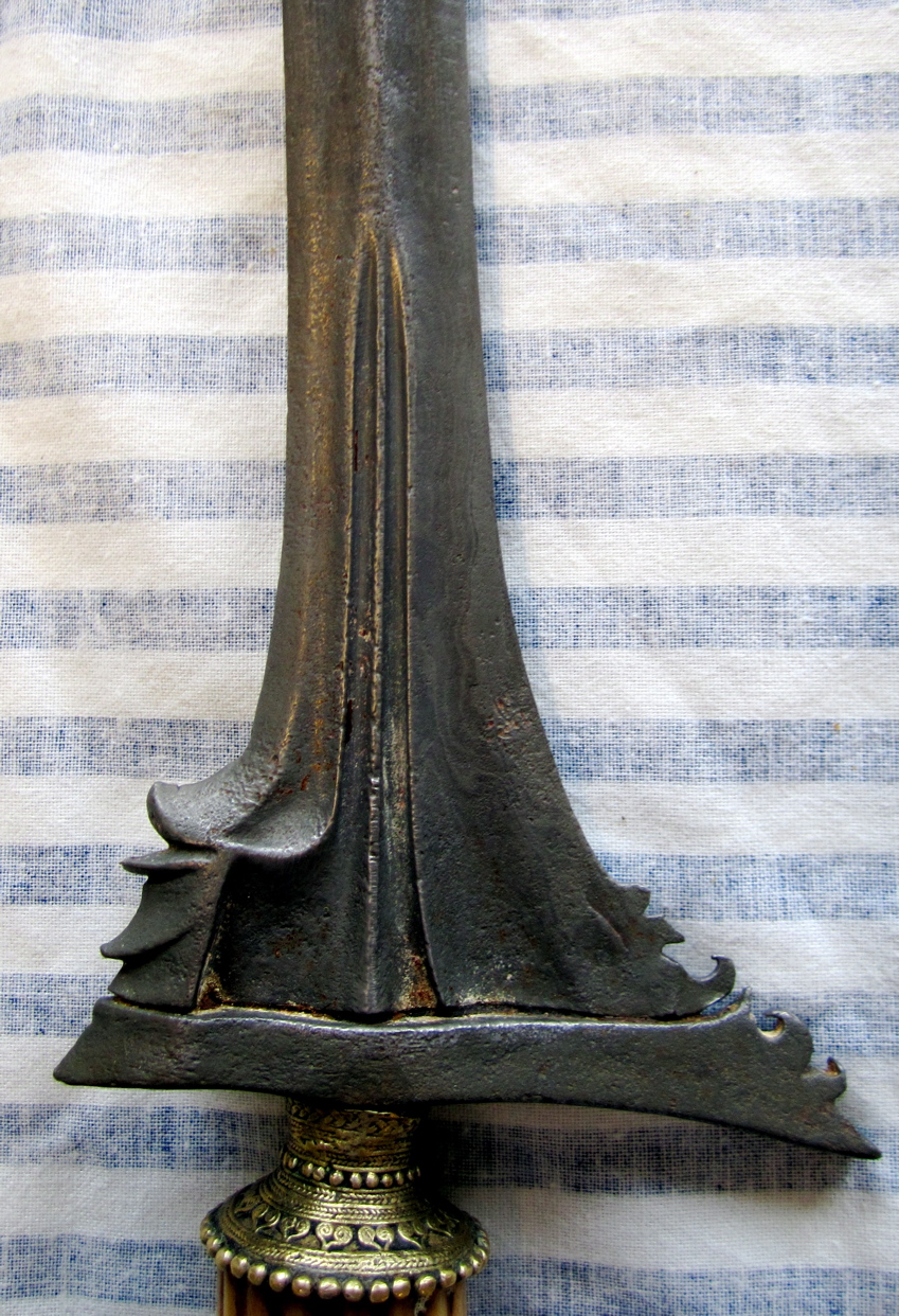

I found this keris in a Toba Batak dress.
It's quite rare but there is one resembling in Leiden.
BUT the blade seems quite odd to me. The one in Leiden has the
more common Panjang-blade but this one is much sturdier and
resembles an elongated Palembang(?) -blade to me.
I have noticed that some other longer blades, that doesn't have
the Bahari/Panjang-shape,has been labeled Bangkinang at this forum?
I look forward to your feedback?
Michael

OMG, you get every time the most curious pieces! When someone other will post this keris I will believe it is a composed piece but what I can see from the pictures it is all typical Batak work apart from the blade. How fit the blade inside the sheath? The blade have a strong balinese/lombok touch in my humble opinion but more slender than normal. I am very curious what others will say about this keris.

Actually I was more curious on opinions on the blade than on the dress.
The dress is made for the keris blade. I can force down the blade more into it
but all horn and ivory scabbards shrink a bit here in Scandinavia so I prefer not to.

At first, I am not able to have and give any substantial oppinion on a blade, these are just my thoughts, when I see it.
There is a high-end cousin of this blade, which was showed in the forum some while ago, which also is Sumatran.
For me, when I see a high quality older blade, it is possible to see the differences (becouse of fine worked features, which are typical for a certain region and period of time) and also the similarities, which probably could lead back to some older (late Majapahit?) standard. With a simpler, not "capital-court" quality blade, the fine are not worked out or become somewhat blurred, like somehow, who just repeats the superficial appearing without knowing the structure. So the lover quality blades from different regions are sometimes much more similar in my eyes.
Why one finds itself remembered on Bali/Lombok blades is, becouse of the smooth surface, yet also, more typical for Lombok blades, becouse of the exagerated ricikan elements done in medium workmanship, imitating a dhapur, which would be expected to be reseved for a high-end keris.
This surely is a keris coming from periphery of keris culture, and it comes in dress of a distant Sumatran region. This would fit together.

To me, it's definitely not a Bangkinang. It looks more like something from eastern Java, Bali or Lombok; somewhere in that area.

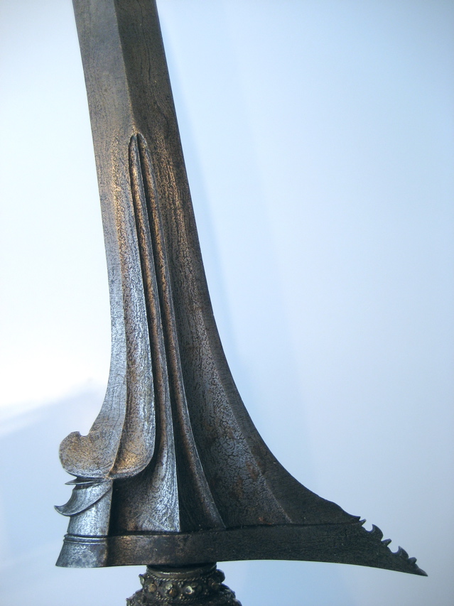

Hello Gustav,
I hope that it is ok to use your picture. I have scrolled up and down to see the similaritys between the both blades, so I want to see them near together.

Blade does look Sumatran, and it doesn't look artificially aged to me. Dress looks like Batak work to me too, though I wld say I'm also seeing a lot of newish looking Batak weapons these days with black(ened) wood sheath, silver work (including flattened "fish egg" or wire filigree work, and black rusted blades. So there could be people in the Batak region doing new work. But again, that's my doubt on the dress. The blade does not look new, unless of course the "keris factories" today have reached new heights in creating that natural aged look (hope not!!).

Incidentally, the other blade shown here also belongs to you, Michael? I remember it was a Sumatran keris. Minang area, if I'm not wrong.

The thing, which I really don't understand is the joint between wrongko and gandar. This let me think of a kind of some kind of compromise or workaround: the sorts of material and the upper silver band are put together in the most peculiar possible configuration.
As I understand, the wrongko is made from horn?

The blade is 47,5 cm (my resembling Minang that Gustav posted is 39 cm).
The reason that they are hanging next to each other at my Sumatran keris wall
is maybe why I didn't think of Lombok/Bali blades first?
The wrangka is made of horn and now when you bring it up, Gustav,
it really is a strange way of doing it? I checked the silver band but it has
never been closer to the joint.
Unfortunately the hilt isn't removable.
There has been souvenir production going on among the Batak for over
100 years old so it's always tricky with stuff from that area.
But I haven't seen that many Batak keris like mine flooding the market.
And this one, like the one in Leiden, has been in Europe for a long time
so it's not anything made up recently.
Michael
