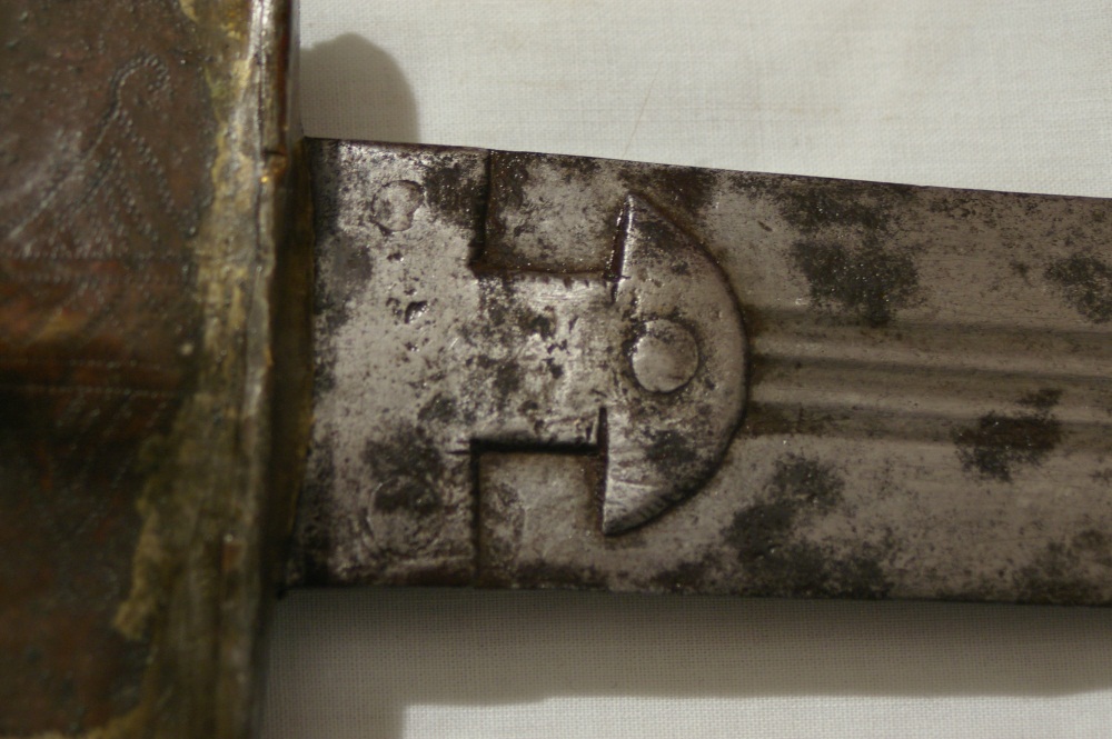

I'm afraid I have onl the auction house picture for this, which doesn't show the whole sword, but at least the most interesting bits are visible. Of course more detailed photos when I have it in hand, however I thought it's interesting enough to throw out for comments now.
It's a 19th century piece with a southern style hilt, looks to be a blade of good quality with well struck half moons. However what interests me is the base of the blade and the odd way it's mounted. I've never seen this type of a flange on a takouba before. It reminds me of Indian weapons such as the khanda.
Anyone seen this style of mount before in takouba or kaskara? I have no idea if it's an established variation, something borrowed from the sub-continent or just a random one time innovation by a local smith.

I have seen forte reinforcement plates, adabal, but always rectangular and never of this shape before. It will be interesting to learn if this is such a plate or whether it connects into the structure of the hilt as well!

This is also a new one for me. I've seen various decorated forte plates and stopper plates, but nothing that looked as structural as this.
Just from the appearance I'm assuming it's integral to the guard.

Time to revive this thread as I finally received the sword.
Here's the little writeup I did for my website...
A very interesting piece acquired at auction in Sweden. The hilt assembly is brass, heavy duty in construction and well balanced. The pommel is in an old style, very well formed, slight bend at one edge. Guard features interesting decorative motif detailed via pointillism. The entire assembly is covered in a brown substance, possibly paint. I am not sure if it is an original application or a later attempt at conservation. The layer is quite thick.
The base of the blade features an odd assemble with a set of riveted plates supporting the blade at the shoulder. These plates sandwich the blade, rather than the blade terminating when it meets the plates. Therefore the plates appear to be reenforcement rather than a repair to an older blade. The style is reminiscent of some Indian mountings.
The blade itself is well made, good quality half moon stamps and well forged fullers. Flex is excellent and the edge very keen. Tip exhibits extreme sharpening, obviously the blade was in use for a long, long time.
Overall, a good example of a non-Tuareg takouba with several unique characteristics.
