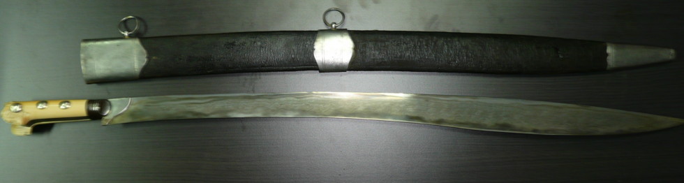

Hello all!
We haven't posted in the discussion forums for a while and if truth be told have missed the buzz of the place! In the spirit of recent changes we have decided to start showing some of our more interesting and unusual pieces!
Our first offering is this Yataghan. from previous posts we have learned it may have been used by Pandor units in service with the Austrian army. At some point, a long time ago, the fittings have been put on upside down! We look forward to hearing any comments, particularly on the hilt. We think it's an early example but it's unlike any we have seen before. As a weapon, it feels very heavy and functional!
Andy

This is a curiosity!
I just looked in my book on Austro-Hungarian swords and saw a Pandur sword with a very similarly-shaped yataghan style blade, but with a different hilt.

I have a bad feeling for this one - the blade looks really rough, almost like it was cut from a sheet of steel. The guard and the rest of the hilt do not match, and I am not sure this could be explained away with a pandour attribution. I am sorry, but to me it looks like a composite piece.
Teodor

FWIW, the turned down guard is similar in shape to the European hunting swords of the 1770s-1790s, albeit a crude one.

I must agree with Teodor, and this appears very much an item made 'in the style of' a yataghan type sword, which has some age, but most likely late 19th century. It has an almost theatrical appearance in the stylized elements, and the blade as noted seems like sheet stock, very heavy and thick looking.
The curious guard, which is a block like interpretation of a weapon of the hirschfanger form in a grouping of these in a museum in Vienna, attributed to pandours, but probably actually of later provenance. One of these has the 'Vivat Pandur' motto on the blade, which was a popular slogan added much later in recognition of these troops which had by then achieved a dubious notoriety.
The original pandour units of Baron von Trenck were assembled in 1744, though numbers of these units had been auxiliaries in Austrias Imperial armies since the early 18th century. As auxiliary units, these troops used exotic and often wild looking fashion and all types of 'oriental' type weaponry, operating as foragers and skirmishers that typically exceeded regulation. When thier depradations became out of control, they were disbanded and von Trenck was imprisoned, where he died in prison in 1749.
The concept for these auxiliary units continued in similar application in a number of Continental armies, including Germany's 'Freikorps'.
While the original pandour forces indeed had certain reference to a degree of use of the yataghans, these were among a wide range of variants of swords and hangers as these troops were privately raised and from regions in the Balkans and East Europe, with 'oriental' costume and weapons favored. For this item, that attribution seems improbable, though I very much enjoy seeing this very esoteric topic brought up!!! By the 19th century, certain exotic units existed as auxiliaries in a number of armies, but the 'vivat pandur' inscriptions were typically bravado placed on hunting weapons in my opinion...very much like 'Remember the Alamo' on some hunting type Bowies. This example seems far later than even the period of these units. Just my opinion, and I wish I could be more optimistic. I sure hate to welcome your post with not so good news.

Dora Boskovic in her book about Yataghans in the collection of the State Muzeum in Zagreb writes that the famous memoires of Baron Franjo von Trent (1711-1749, unit established allegedly in 1743) were a later forgery. Also, using European imid-18-th century iconography of travels through the Balkans with sketches of the exotically-looking locals with their even more exotic weapons, there is not a single yataghan in sight until at least end of 18th century. Thus, she doubts ( or dismisses altogether) the idea of von Trent arming his pandours with yataghans.
I also have my antennae twitching: something is not right about this yataghan, for the same reasons outlined earlier by others. The quality of the blade can be judged only by the current owner, but I cannot believe that any actual yataghan user would have put the handle backwards!
I also do not enjoy passing bad news, sorry....

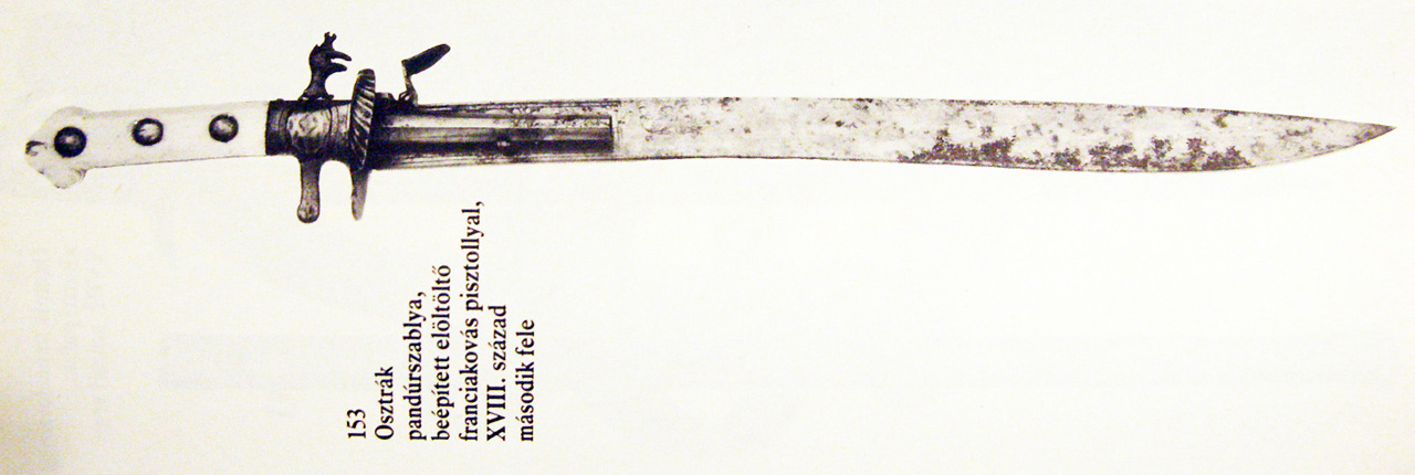

Here is a Pandur combination sword-pistol from the book by J.LUGOSI - KARDOK.
It has a yataghan-like blade, which he dates to the 1700s.

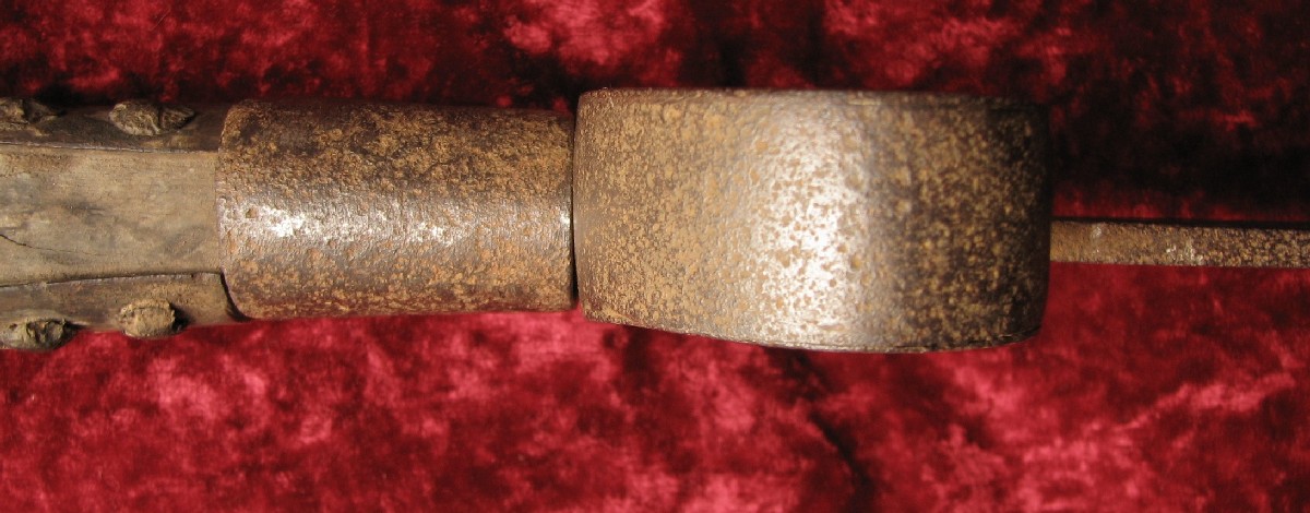

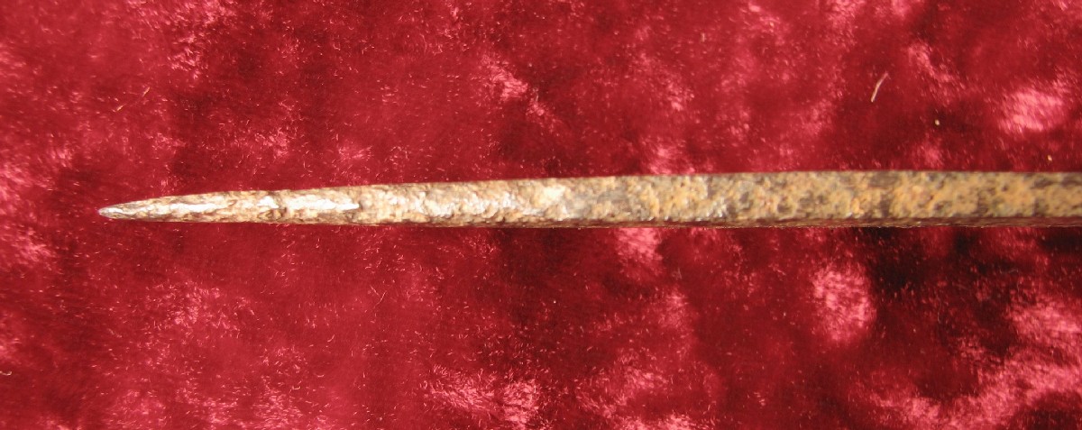

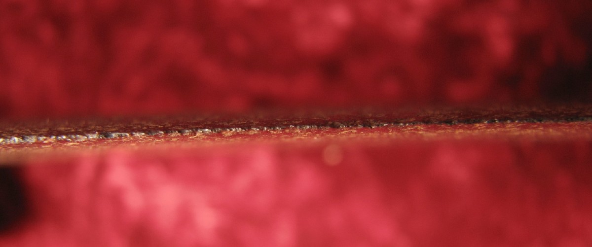

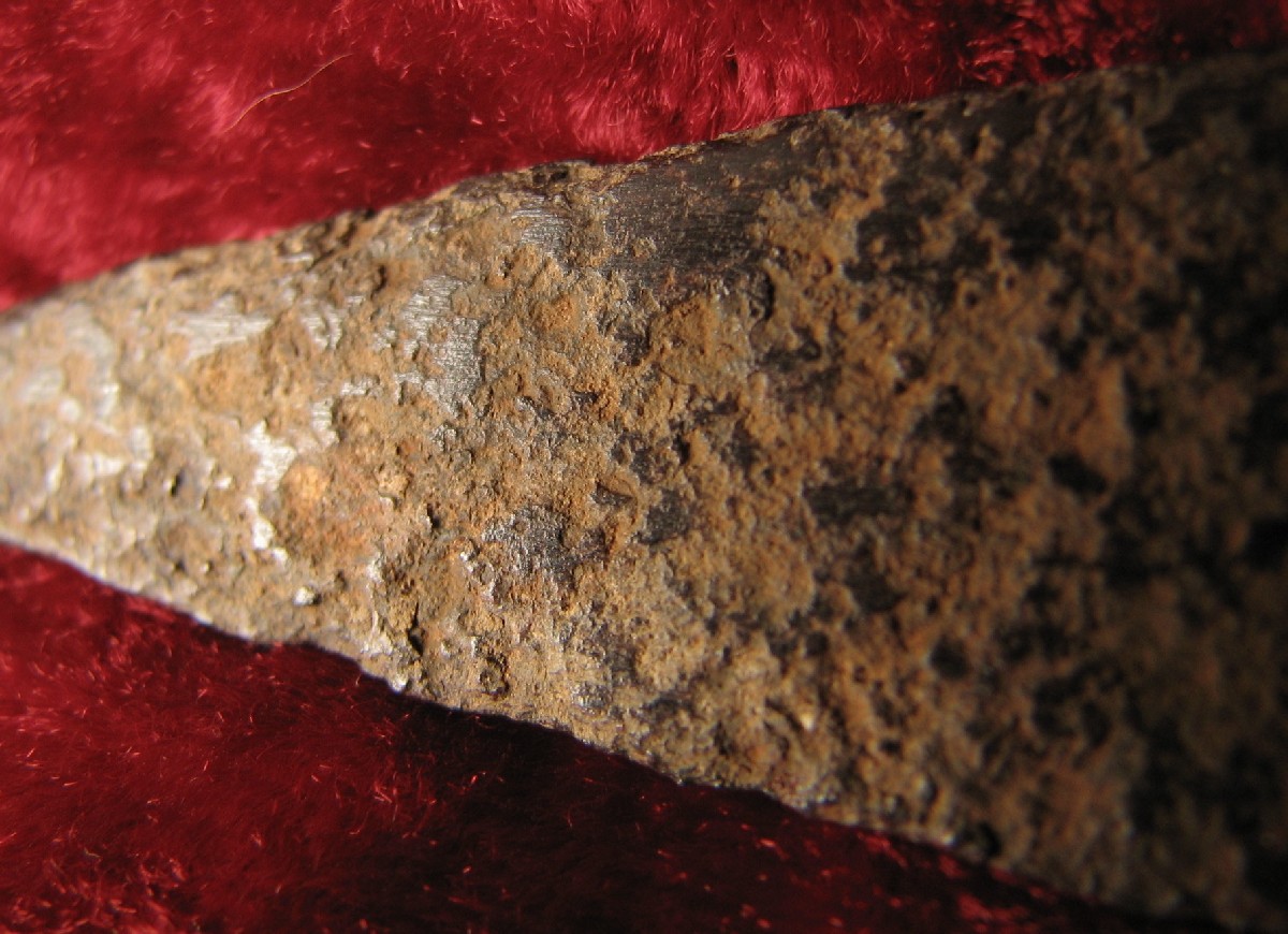

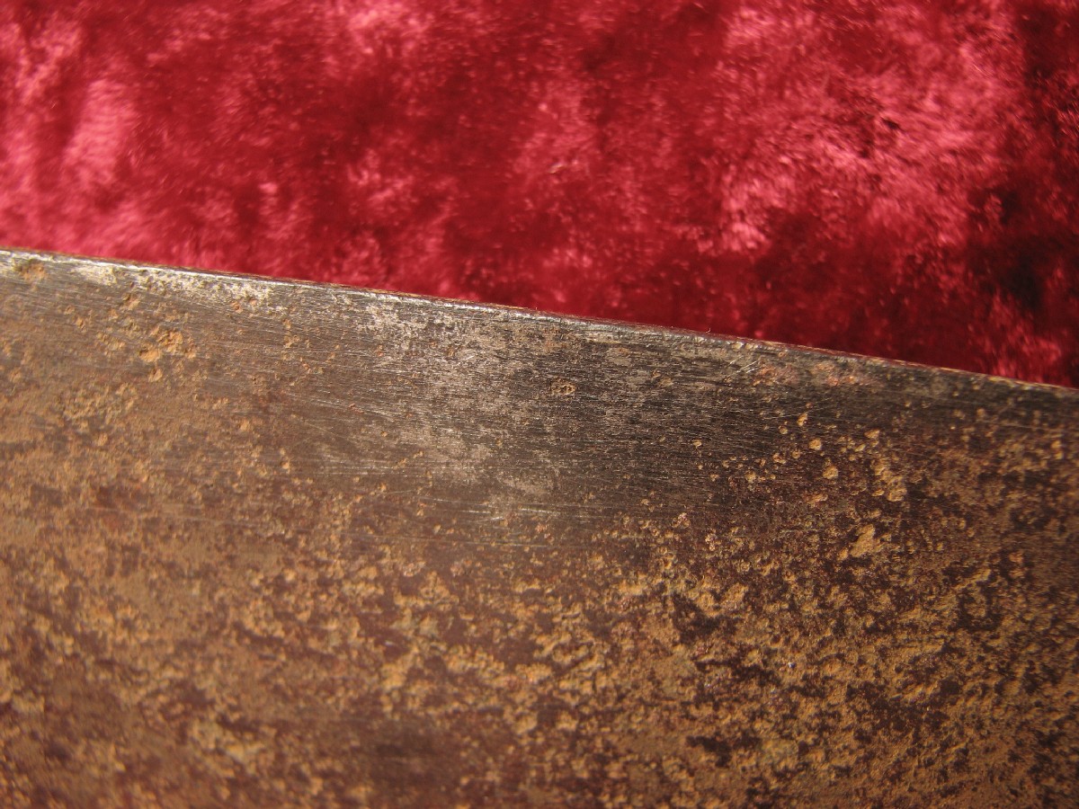

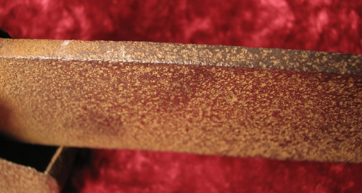

Thankyou for the replies so far gentlemen on this fascinating subject. We aquired this sword in as part of a group buy, so any comments made are taken happily and in a constructive manner. We're still rather interested in opinions regarding the hilt decoration, as a fair degree of work has been put into its construction-the bone inset disks are all hand made and finished and the ears of the handle demonstrate a skilled hand. Was this then somebodies attempt to copy the much more ornate 'true' yataghans or is simply a local interpration of such incorporating local style and design? The blade, when held for closer inspection, appears to us no worse than those found on some Indian munition grade tulwars- crude but effective. As for the sword being ill fitting, that was at first our thought, but having played around with it a wee bit, we've come to the conclusion that the parts may have once fitted snuggly and the blade when mounted the correct way round would have made this an effective weapon. These is just what we see close up. Whatever it be, a genuine old fighter or a still vintage pretender, we are glad that its seen the light of day and raised a few eyebrows! thanks again,
Here are some pics showing some more detail of the blade.
Andy and Karina.

Old 24th July 2010, 01:43 AM   #13
A INTERESTING SWORD IT APPEARS TO HAVE SUFFERED FROM EXPOSURE TO THE ELEMENTS FOR QUITE A SPELL. TO ME ITS WEATHERING AND PITTING LOOKS NATURAL NOT CONTRIVED BY MAN. THE BLADE IS TOO FAR GONE TO BE WORTH RESTORATION BUT YOU COULD CONTINUE TO CLEAN THE SECTION AND ETCH TO GET A BETTER IDEA AS TO ITS QUALITY. CLEAN UP THE HANDLE A BIT AND PUT A BIT OF MINERAL OR BABY OIL ON THE HORN AND BONE. THE HORN IS TOO FAR GONE TO RESTORE AND I WOULD JUST LEAVE IT AS IS OTHER THAN REMOVING THE DIRT AND APPLYING SOME OIL. I AM ASSUMING THE DECORATED DISKS ARE BONE AS I DOUBT IVORY COULD HAVE SURVIVED THE NEGLECT AND EXPOSURE THIS SOWRD HAD ENDURED. I WOULD CLASSIFY IT AS ARTEFACT GRADE, IF YOU WANT TO DO CARBON DATE OR ANY TESTING DO IT BEFORE APPLYING ANY PRESERVITIVES OR OIL. CLEANING IT UP A BIT AND LOOKING IT OVER CLOSELY WITH GOOD LIGHT AND MAGNIFICATION MAY REVEAL SOMETHING TO HELP CONFIRM ITS AGE OR AUTHENCITY. THANKS FOR SHAREING GOOD LUCK

Whatever this blade be I believe it has suffered the indignity of shoddy workmanship before ever it showed any age .
Instincts tell me to look askance at this piece .

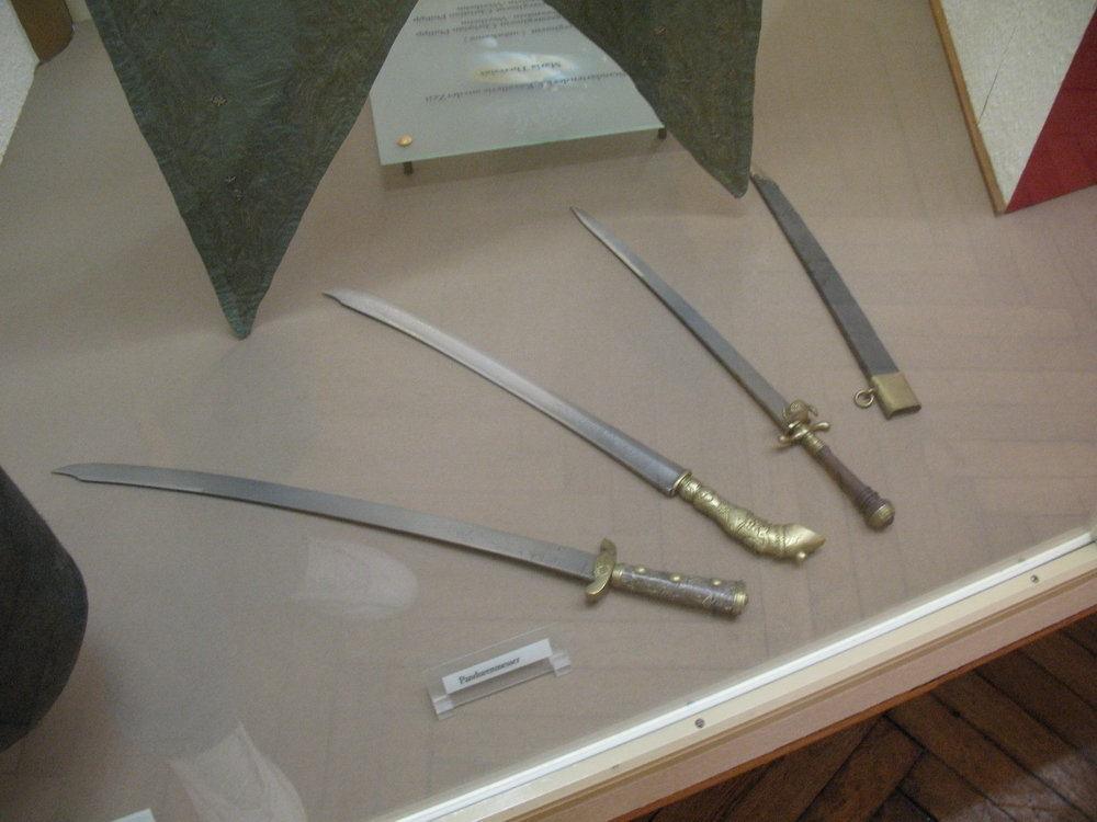

These are some hirschfanger type swords in Vienna in a museum display which have been suggested 'of the type' often carried by pandours. The example on the left has a crossguard which seems reminiscent of the much heavier and workmanlike guard on the example we are discussing. It should be noted of course that the grip is of the familiar European hanger form of the mid 18th century and for quite a number of years later.
I would point out that the blade on this example in the Vienna illustration has a very curious clipped point. In Gerhard Seifert's 1962 book, "Schwert Degen Sabel" he has a group of line drawings illustrating blade sections and point types and terminology......there is a tip remarkably like the one on this Vienna sword which carries the term 'pandour point'. There was unfortunately no further material elaborating on the source of the term, but interesting to see of course the pandour term. Actually back in those days, I admit to being among those who had no idea what a pandour was !!
Getting back to Andys sword, it would be tempting to connect the guard to being of somewhat that style, however it is far outside the mid 18th century period in my opinion, and far too heavy to be considered of this type.
The 'pandour' use of yataghans would likely have been of traditional form, by the foot troops as previously noted, and these did not have guards of course....as noted as well, it is only presumed what kinds of weapons would have been used, but yataghans as far as I know did not have this kind of guard.
The hangers used by von Trencks forces, as shown by type in Buttin (1933) were typically of karabela type hilt, and did not have yataghan type blades.

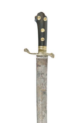

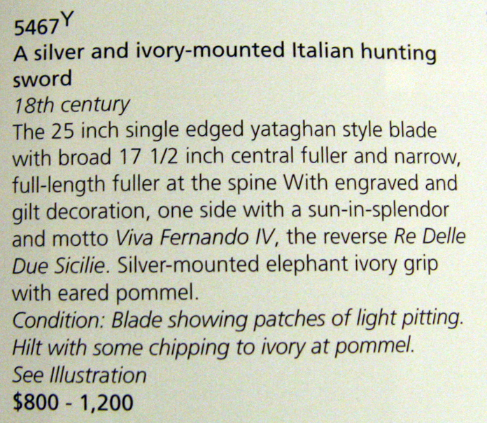

Here's another yataghan-styled European hunting sword, this one bears an Italian-inscribed blade.
