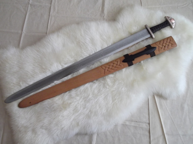

Hi my name is Jeff Helmes and I am a bladesmith blacksmith from canada. I am currently focusing on pieces inspired by the viking and migration period. I thought as a first post Id put up a pic of a sword currently under construction. It`s an eighth cent inspiration. The blade is shear steel and wrought iron the handle is wrought iron with inlayed copper. the hilt and scabbard are currently being carved.
Cheers Jeff

Congratulations on such great work. I for one would be interested to hear more about construction, choice of materials and assumptions on performance and properties.

Thanks Atlantia, I appreciate the great question.
For starters the blade is nearly 31 inches long. (i`ll post a beter description when the blade is finnished) around 4 mm thich at the guard tapering to over 2mm near the tip. The fullers were ground in and are wide and shallow and are slightly rounded over, as were many sword finds of this age.
The materials are very old buggy springs for the cutting edge and the core is wrought iron and some of the same spring. The edge is one piece wraped around the core. The spring , I believe is shear steel ,which is an old method of making steel that is basically carburised and highly refined wrought iron. Short of making the steel myself, this combonation is very similar to many blades found during this period.
I havent been able to properly see how it handles yet as it is still under construction but the center of ballance should be close to 5 inches from the guard which is also the norm for this period.
This particular sword is very light and quick is its preliminary test cuts and is very flexible. Making it serves to reinforce my belief in the sophistication construction methods involved in the creation of many of the swords of this period.

Hi Jeff,
Wow! What can I say? You've clearly put a huge amount of thought into this amazing weapon. I thnk it looks, well... frankly amazing!
I have to admit that I know next to nothing about the processes and potential pitfalls of mixing these materials, so forgive the 'newbie' questions
I'm suprised that this combination produces a flexible blade, as I've always thought of wrought Iron especially as very brittle.
If the whole blade is to be flexible, how do you overcome the problems of the two materials different properties, and presumably quite different performance characteristics?
Are there in fact advantages that I havent realised in mixing them?

Hi, thank you for the interest and the good questions. I hope I havent rocked the boat by posting a pic of new work. I thought it may be of interest as it draws heavily from historicaL pieces.
I wish I could own historical pieces but as of yet they are out of my budget. I generally gather my information from books (ian pierce, oakeshott etc.) internet acess to photos of museum and collectors pieces and from other bladesmiths and enthusiasts who have made detailed records of actual swords.
As far as historical discussion is concerned feel free to ask any questions you like. I am by no means an authority on the subject but I am willing to share any bladesmithing information as it pertains to swords that I have.

Hi, I again hope i'm not causing a fuss but since i've gotten it finished, i thought i would share a picture of the piece with you here. I veer that this is a reasonable representation of a period piece. If there are more informed folks here who feel otherwise i'd greatly appreciate their sugestions, (as i've started work on another one.)
