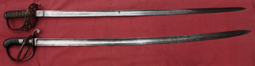

The Crimean War was responsible for officers ordering special order swords during and after the war. They realized their regulation swords with brass hilts and fullered blade was lacking. One example is a Wilkinson infantry sword with steel patent hilt and solid flat blade. The officer ordered this sword after the Crimea and wore it in Afghanistan into 1879.

Hello Will... Your flat bladed Wilkinson looks formidable. This blade was designed to cut.There was no fuller, pipeback or raised back blade to impede cutting. Some variation was allowed and Officers could choose a fully criss crossed backstrap and either the same pattern on the pommel or polished.Cavalry quite often preferred the hilt to be of a pistol grip style turned down at the pommel so a straight profile could be offered in the charge...The Wilkinson I had in 1969 was literally a spike formed of a very sharp point supported by two I Beams either side of a fuller running three quarters of the blade length to a narrowing spear point.Flat blades though effective in the slash and cut were regarded as a bit heavy but frankly that is what heavy Cavalry needed in their role.Thus we see two different sorts of requirement here...so we begin to see the problem. Regards Peter Hudson.

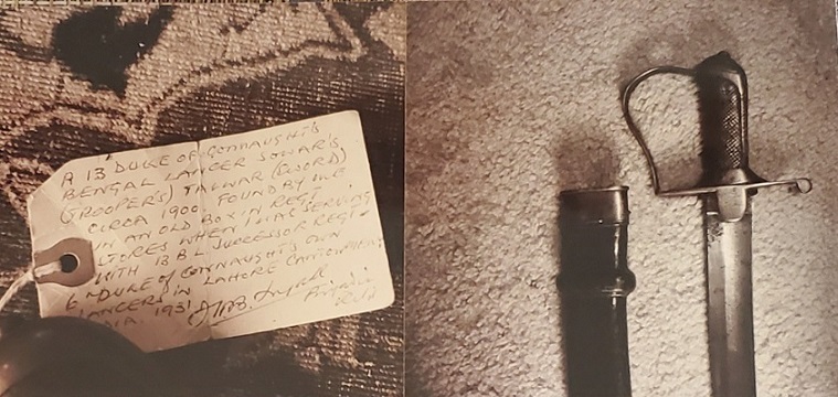

The photos were taken the day of that interview in the 90s at his home in Sonoma, Calif.; his 1912 officers sword; him on his horse just prior to that charge; Ge, Francis Ingall as we talked.....in this time he repeatedly glanced at the portrait of his 'charger' "Eagerheart" adoringly, and quite literally beamed as he described these events. The troopers sword was of the 13th and inscribed 13 BL........thus promptly identifying one of these I have had for years (pictured with scabbard) unmarked....but made by Bourne & Son (a subcontractor for Wilkinson) probably 1890s for the India dept.,
I can imagine I was as well, as I thought of watching 'Bengal Lancers' films repeatedly as a boy, and was ever fascinated by the 'Khyber Pass'. Here I was actually talking to a British officer who was there!!!

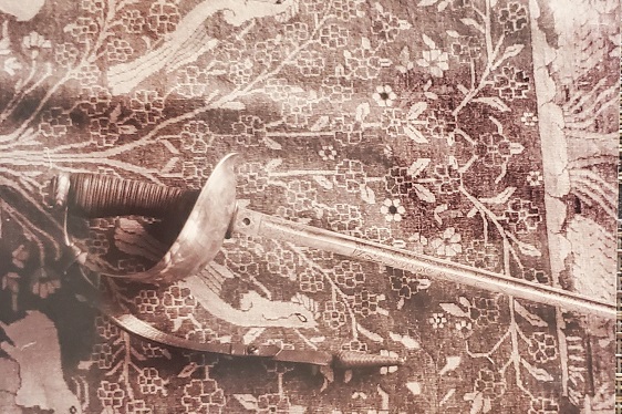

In previous post, the sword cane was noted, and it would seem that this convention was likely popularized from the exposure in India of certain innovative combination or concealed blades. While the enclosed blade in certain cases in canes did not begin there and is recorded earlier in numerous other instances, it seems officers in India began the popularized fashion from seeing them there.
The thing with this is that in the highly coded matters of nobility, status, and honor within the ranks of officers and civilian gentry, the notion of a concealed weapon was considered 'dastardly' and ungentlemanly, and profoundly looked down upon.
This was the reason for the restriction with these, and the sword stick was considered perfectly acceptable. While not bladed, fencing skills were taught using these as a weapon of self defense, using similar movements and attacks. With these seen in that sense, not just as an element of fashion, but a genuine weapon deadly in use as required....it is not surprising they became known as 'swagger sticks'.

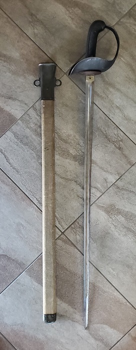

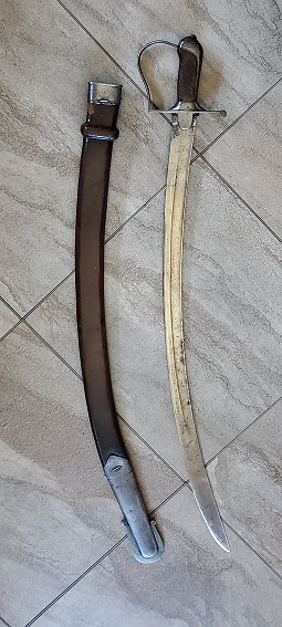

My specimen.
British Infantry Officer's Sword M 1895/1897. The blade spine bears the serial number 49731, likely dated 1915.

Norman, thank you so much for those important notes on the heavy cavalry officers swords!!! Perfectly explains the case with these officers swords, and quite honestly (I am more than a bit rusty as I have not been in this arena for decades!) I had entirely forgotten these developments.
Peter, as noted, this topic is quite fascinating, and while the title is directed toward the infantry swords for officers of the British army, it is difficult to adhere directly to those alone. The dynamics of British military swords overall were at play, and as can be seen, certain features of character and design had key influences into the sword patterns used by various elements and departments of the army.
With officers, the sword was not only a combat weapon, but a fashion and status oriented arm, and typically personally commissioned by many officers by outfitters who catered to their whims, but still followed basic the regulation patterns in degree.
Since these swords were privately purchased, and often not only costly but important elements of status oriented and personal accoutrement held for dress, parade and ceremonial occasions.
Officers had the option for using swords that were often simpler versions of the other ranks weapons, or often even variations of them, in the field or on campaign. These were casually known as officers 'fighting swords', which were typically more rugged and sound examples which followed some degree of uniformity, but in certain circumstances, especially in colonial contexts, these could deviate in many directions. This included the use of native weapons or swords using elements of these traditional forms.
This was very much the case with John Jacob, who like many British officers, who learned that it was important to be keenly aware of the ethnic and traditional sensitivities of the tribesmen they commanded. The designs in the hilts of the officers sword mentioned previously incorporated designs which were important in just this manner and was strategically intended.
In these colonial circumstances, the use of the sword by British officers in combat continued profoundly well into the 20th century, particularly in India.
In example, I once had the honor of interviewing a British Brigadier who as a young officer in the Khyber Agency in 1931, led one of the last cavalry charges wielding the M1912 sword for officers. It was an experience holding this weapon as he recounted his stories, as he had written his autobiography, "The Last of the Bengal Lancers", as he was in the 6th/13th Bengal Lancers regiment. The 13th had previously been known as "Watsons Horse" in the same manner as "Jacobs Horse" previously noted.
Getting to the constant controversy over blade design, it was said that the British M1908 cavalry sword was one of the finest designs ever achieved, and that it universally served both requirements for cut and thrust. The legendary Wilkinson sword firm masterfully produced these.
In WWI during what was known as the Mesopotamian campaigns, in Palestine British cavalry commanded by General Allenby were equipped with these swords, covered entirely in leather both hilt and scabbard, for not only protection from heat and sun, but the revealing glint.
General Allenby proclaimed , " men....you may go into the field without your breeches....but you WILL carry your sword!!!"
These distinctively appointed M1908 swords were accordingly termed with the eponym 'Allenby Swords'.
On the other hand, in the US, General George Patton, designed the huge cavalry sword, the M1913, which like the M1908 was deemed a brilliant sword. Ironically, even with the outbreak of WWI, these never went to the lines, nor was it ever used in combat. A skilled horseman as well as swordsman, Patton was ever disappointed, and as cavalry was reorganized into armored units, it was said that his face was lined with tears as his men stacked their swords for the last time.
ADDENDUM:
Brigadier Ingall was delighted with my story of my driving down the freeway with lances (indeed from Bengal Lancers) protruding with T-tops off my Corvette!! as recounted in my recent interview.
Hello Jim, and thank you for your posts 12 and 13. In fact your end picture on 12 was so near the answer ...to the conundrum of what actually caused the downfall of the use of swords as Battle Field weapons for Officers ...The business of Training!! ...
In The UK there were essentially two schools of Battle Field fencing with Sabre or Spike...This was almost impossible since there was a complete contradiction going on...It was virtually impossible to deal with one form without contradicting the other... Spike design was for stabbing and lunging but the sabre was for cut and thrust. Each need to be examined against the two different designs of sword...On the one hand The Sabres werent the best at lunging on the other straight spike blades didnt cut so well ...and as I say these were different swords for different sorts of opponents and for different environments and different targets....As an infantry Officer which school would an Officer attend or follow?...
There were two kinds of Cavalry...Heavy and Light...where did their allegiance lie...Further into the discussion was the fact that casualties would more likely not survive being run through but those injured in a slice or chopping action fared much better...Just to compound the issue was the fact that Officers with swords drawn could be seen miles away because of the mirror flash effect of sunlight on their sword blade and hilts. At the same time pistols and short rifles were developing so the multiple firearm choice was a far better solution to arming officers across the board.
Peter Hudson.

G'day Guys,
This is a great thread. British sword design is something that I find very interesting. My collection although focused on the Napoleonic period, contains many examples that show sword manufacturers were thinking about how to make their blades better at specific purposes.
Peter, I have to disagree about the paisley influence on British sword hilt design. I think it is much more about the Honeysuckle flower, which first originated prior to the 1796 patterns. Below is a photo comparing an example of a honeysuckle themed hilt on an earlier sword and a 1796 pattern heavy cavalry officer undress sword.
Also Jim, the 1908 pattern cavalry sword is a superb thrusting weapon, but is basically just a spike, with almost zero cutting ability, even when sharpened.

Originally Posted by Bryce View Post
G'day Guys,
Cheers,
Bryce
Hello Bryce, Excellent pictures showing what is called honeysuckle design...I actually never heard of that name til I saw it on this thread noted by Jim and yourself. I should have my camera functioning soon and hope I can get a series of pictures uploaded of some more examples of swords in my collection. ...I dont actually have any Scinde Cavalry so its really good to see your exhibits.Thanks again for the great pictures.
I should add that the perforations cut through most of the styles in the 19th C. are a different design to the Scinde Cav. but I accept the influence of the general shape...and I have come around to accepting more than one source in the influence of these hilts.
Peter Hudson.

Here is a Scinde cavalry sword, a Wilkinson made in 1856. Maj W.T. Johnson. He used this sword while charging a rebel gun. The first photo the sword is over a 1796 trooper sword to compare blade curvature that looks to be the same.
Hello Will,
Interesting seeing it lined up with the`1796 and I imagine how that would have been used against Tulvars and the like. The floral design looks amazing and was apparently from Icanthus leaf designs. This was a great Officer and the Sword and battle Honours you present with it are great to see...
Peter Hudson.
